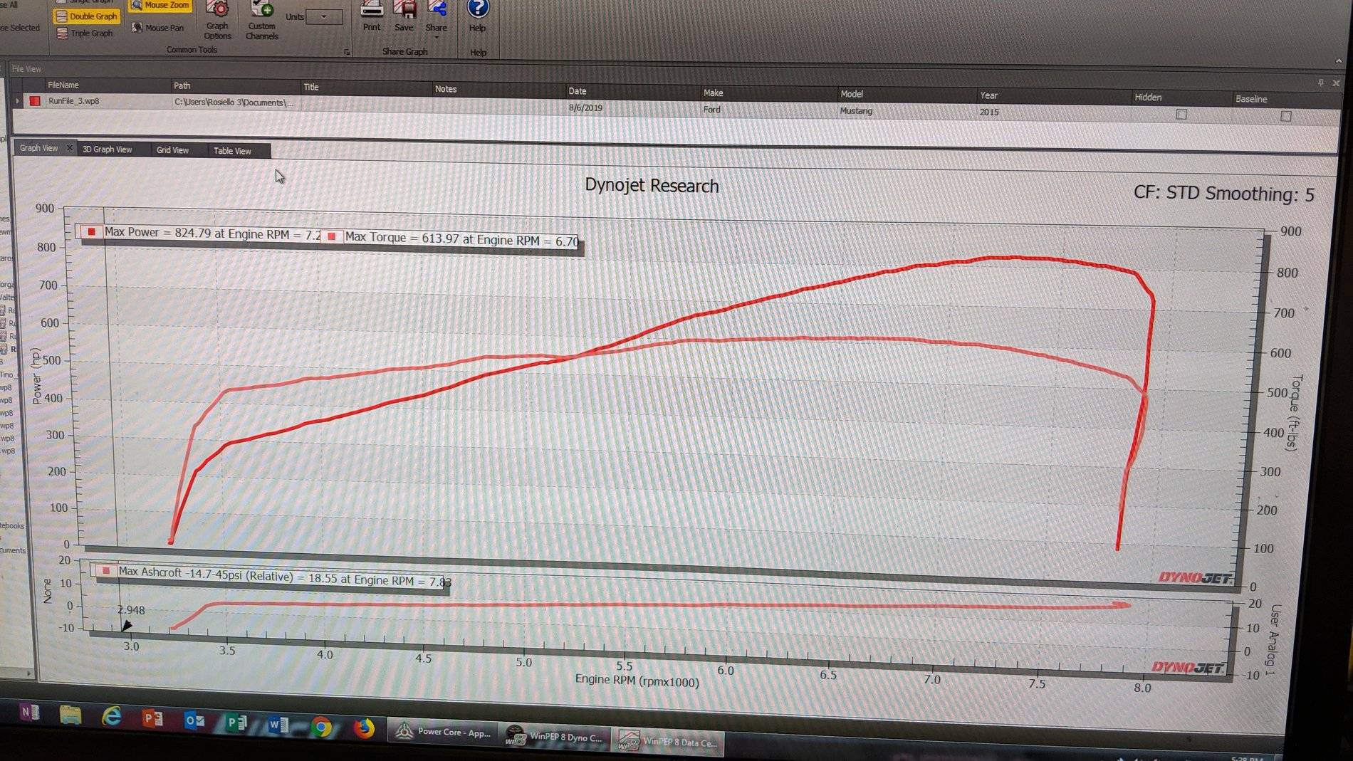

In any case, see below a 2018 GT stage 2 procharger P1X on 93 making 11.28-12.34 PSI vs. a 2018 GT stage whipple on 94 making about 10 PSI.
Please try to ignore the ultimate power and torque figures given these were different cars and different dynos despite both being essentially stock minus an H/X pipe. Focus on the torque curves to see the difference in power delivery.
Procharger P1X Stage 2
Whipple Stage 2
Anyone else notice the torque curves basically identical with the pd starting at 3,500 or so?...?
I did :inspect:
But I also noticed that there’s something funky going on with the Whipple car.
The shape of the curves on that chart aren’t consistent with typical results.
But then again, using a twin-screw as an example of PD blower bottom-end is similar to using Caitlyn Jenner as an example of a woman. :bow:

Both cars still had factory headers and cats, plus that Whipple was the standard 93 octane Whipple tune. I believe the Whipple tune pulls timing up top for safety.
Anyway, the centrifugal keeps making power and would likely make a little more if revved out to 7800-8000 RPM.
