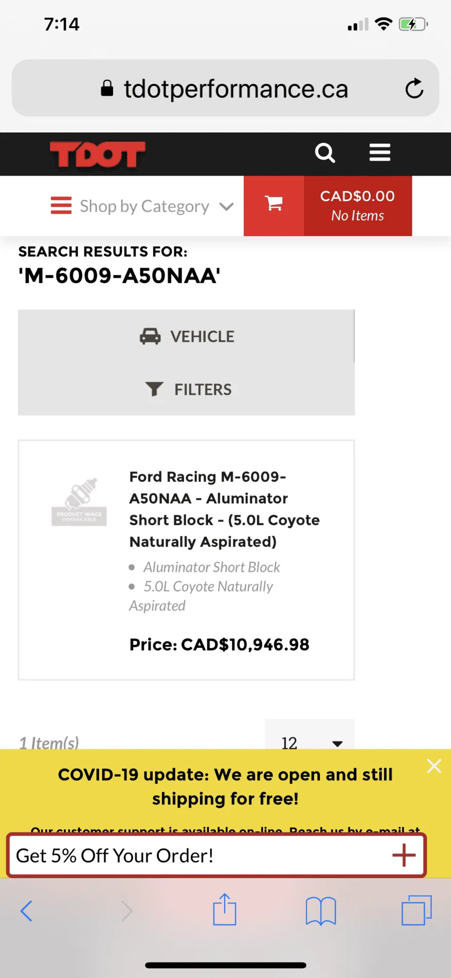

Torinate
Feb 18, 2018
87
2,037
943
Ontario
2016 GT Convertible
Yea... Canadian $$$...
Plus the 13% taxes on that. Not positive about shipping either. BUT they do have a 5% off sale!
