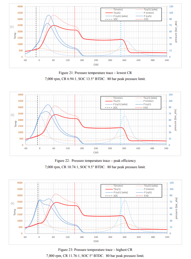

This picture is from the deepblue.lib study chapter 19 page 64. The red lines show temperature, which is nearly the same for all CR's and peak cylinder pressures, just higher CR peaks a little later and lower(EGTs are lower). The pressure is the blue lines, and after peak, you can see they fall nearly identical. The major difference is the higher compression ratio has a "double peak" from the early spark, making it have a less "peaky" and more "flat" pressure curve. The actual pressure doesn't get as high it starts near the maximum already, but the adiabatic pressure actually peaks later with the temperature if you look closely. This is the "double peak." If spark advance was kept ideal it would be peak just like the lower CR, just to a much higher peak. Again the complete opposite of what you are saying. All lowering the compression does is limit the VE of the engine, making you have to rely on the efficiency of the FI more. When 20-30* above ambient is doing well with creating high boost, that is a problem. The key here is to not lower compression, but to have a great calibration and to not let IAT's get out of control to where the calibration cant reduce spark advance enough. If you are planning on running more than 10-11 PSI of boost, plan on upgrading your intercooler/ heat exchanger setup.
In looking at the specific graphs you posted above, something didn't look right to me. In Chapter 17, he claimed low compression and boost made more than double the power vs high compression and no boost assuming the same Pmax. In Chapter 19, Figure 20, he showed that the low compression motor only had a ~10% power and torque advantage over high compression with the same Pmax. Secondly, starting with the basic "motoring" (unfired) curve, the pressures peaked much higher in Chapter 19 Figures 21-23 than they did in Chapter 5 Figure 7. Chapter 19 did not seem to specify the manifold pressure used for each compression ratio. One might mistakenly assume the low compression ratio engine ran higher manifold pressure, but this is not the case. I ran the combination through my own thermodynamic kinematic FEA model to figure out what was going on and see if I could replicate it. It turns out, they assumed the same manifold pressure for all three compression ratios, and a rather high one at that. In Figures 21-23, they used the same manifold pressure of 1.5 bar (~22 psi boost) on all three. One doesn't even need an elaborate engine simulator FEA to determine this your yourself, as the pressure-volume ratio formula is provided and is accurate. This revelation is especially interesting since Figure 20 shows that low compression still had a 10% power and torque advantage over high compression even at the same boost level and Pmax. Something else interesting is that our models both agree that the air charge prior to spark is 200-250 deg F cooler at the lower compression ratio with the same boost but more power. Therefore, the low compression engine is further from detonation and has room to increase manifold pressure, thereby growing its power advantage while maintaining knock safety margin.
Regarding the peak temperature...one of the "aha!" moments when working with my engine FEA model was when I lowered compression ratio and added manifold pressure. I expected to see a higher post combustion temperature, but I didn't. It was nearly the same. That's when it dawned on me that you might burn twice as much fuel but you're also heating twice as much gas with it, so the resulting peak temp is nearly the same. It should be noted that they did not appear to model the temperature of the unburned air/fuel beyond the flame front, which is where detonation occurs. Rather, they modelled the bulk mass temp of the entire gas charge in the cylinder as heat is added. The actual temp of the unburned portion is what would lead to detonation. However, it can be assumed that a higher pre-spark temperature leads to higher temperature in the unburned portion post-spark. This, as noted above, moves you in a safer direction away from detonation.
Regarding the "double peak" when they modelled 11.76/1 compression with 22 psig boost and 5 deg BTDC ignition timing....the "motoring" (unfired) model reached 75-77 bar at TDC and they set the limit to 80 bar. It basically reached combustion pressure before spark even happened. (Think about that when cramming boost into the 12/1 3rd gen). This necessitated retarding the timing all the way to 5 deg BTDC. The drastically delayed ignition timing (I believe you mistakenly wrote "early spark" above) causes the combustion pressure peak to happen so late in the expansion cycle that a second peak occured. I don't think anyone believes this is a good way to run and engine and the author agrees. Efficiency and EGT were even less favorable in this state than they are at 7/1 compression ratio.
The author went on to run a lower speed and boost level. Again, the manifold pressure is not specified but the motoring traces can be replicated by applying 2 psig manifold pressure to both compression ratios. In these low-boost scenarios, the spark timing becomes more conventional and it loses the double-peak. In Figures 24 and 25, one can see the resulting phenomenon that I described earlier. Pmax was again set at 80 bar for both. You can see the pressure peaks happened at about the same time for both 7 and 12/1 compression. However, take a look at the cylinder pressure at 60 deg ATDC. The 12/1 engine looks to have about 27 bar at that time, but the 7/1 engine is still around 31 bar despite having an earlier-occurring combustion process. The larger the starting volume of gas, the slower the pressure degrades as the volume expands. In this way, the lower compression engine can have a higher MEP for the same Pmax.
When I started thermodynamic kinematic FEA engine modelling, there were several times when I thought "that can't be right". I later realized it was, and that I had just been thinking about it wrong. I learned that forced induction enables more power in ways I did not expect. A large part of it is peak temperature control. In the gas compression industry, for instance, most compressors limit the max temperature by compressing in small steps, usually 3/1 pressure ratio, and cooling between those steps. When you have a high compression engine, there is no opportunity to cool the gas before detonation becomes a danger, other than GDI but that's another subject. The post-compression temperature of the compressed gas is a function of the starting temperature (IAT), compression ratio, and specific heat ratio of the gas. Note that initial pressure (boost level) does not affect post-compression temperature. Therefore, barring GDI, the only way to reduce post-compression temperature is to lower IAT and/or lower compression ratio. A high compression ratio sticks you with a high post-compression temperature. Increasing pressure, even with ambient IAT, moves you in the direction of detonation. Forced induction allows you to perform part of the compression cycle outside of the engine and cool the air before entering cylinder for the second stage of compression. You can get all the power advantages of high cylinder pressure while actually reducing the chance of detonation because pre-spark temperature is actually lower. Then, as I explained earlier, the pressure stays higher for longer in the power stroke so the MEP is helped even more. For instance, my model shows that if you drop the Coyote CR from 11 to 10/1 and increase boost to maintain the same Pmax, the BMEP goes up by 5%. The max pre-combustion pressure is the same but the pre-combustion temp drops by over 50 deg F, thereby reducing the chance of detonation. The result is safer and more powerful.
the only 10% advantage thats mentioned is for high compression, at low RPM. High RPM is only slightly toward low CR, nothing that can be seen in the graphs.
You misread that and have it backward.
I don't agree with the motored traces in the graph I posted, they have those wrong or on a different scale not shown. Detonation has little to do with pre spark temperature. Peak cylinder pressure is what causes it, this is post spark, and what this chapter was comparing. The lower compression engine could not increase its boost more, as you seem to think, It would run into detonation if 80 bar was that threshold. This is why I said, dont let your IATs get out of control when running a high CR engine with boost. You don't seem to understand this, detonation is in the end gases, its different from pre-ignition. Pre-ignition is the engine is out of the ECU's control, luckily with EFI and well designed combustion chambers its very rare.
I dont agree with the motoring, but I do believe the double peak.
It is a mistake, I meant late not early. Torque pulsations is the only thing mentioned about running the engine with such late spark, at WOT, you probably cant even feel it.
I think its fine, and many motors are ran in the single digit spark advance, the Dodge Demon is one of them at times.
Figures 24 and 25 are for low RPM. Its confusing because they switched from showing low med high CR to, high then Low CR graphs, you need to look at descriptions. Again the goal was peak cylinder pressure as a representation when both would be detonation limited. Manifold pressure would not be able to be increased in either motor.
This is showing the 10% advantage toward the high CR that you have backwards.
