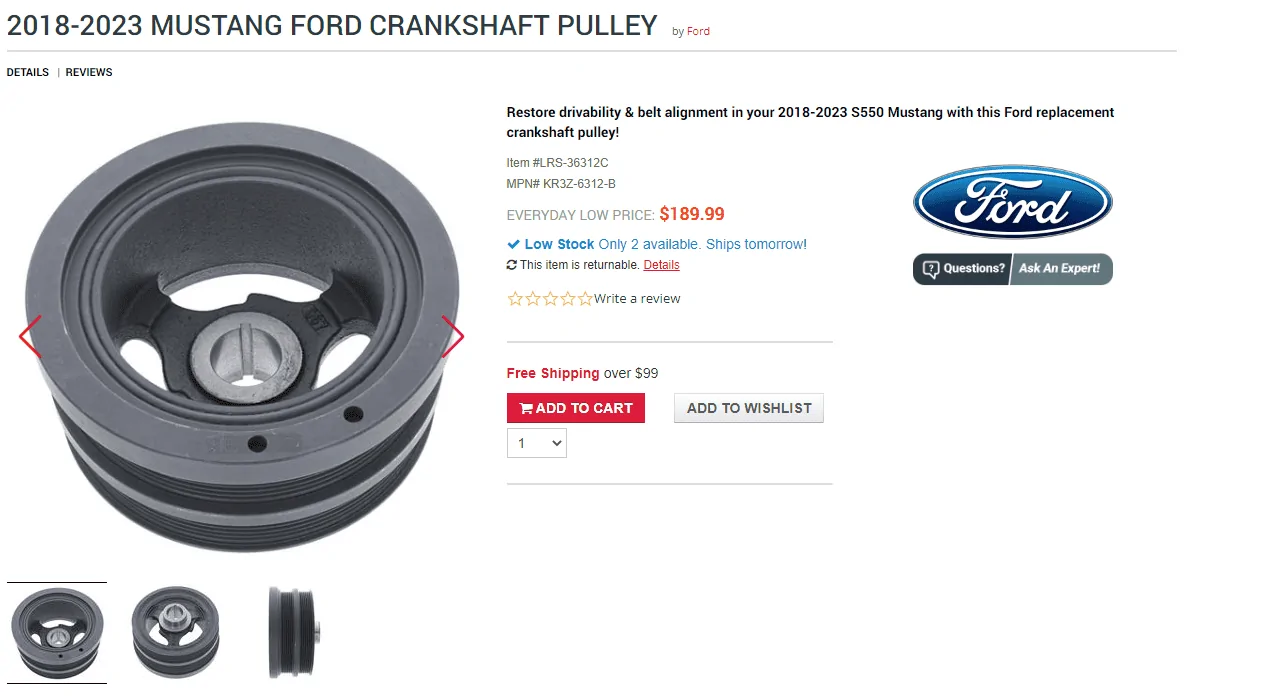

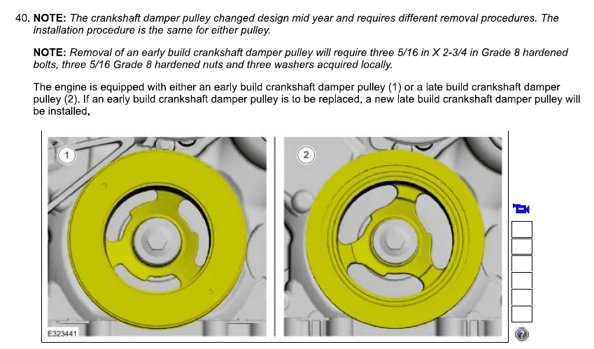

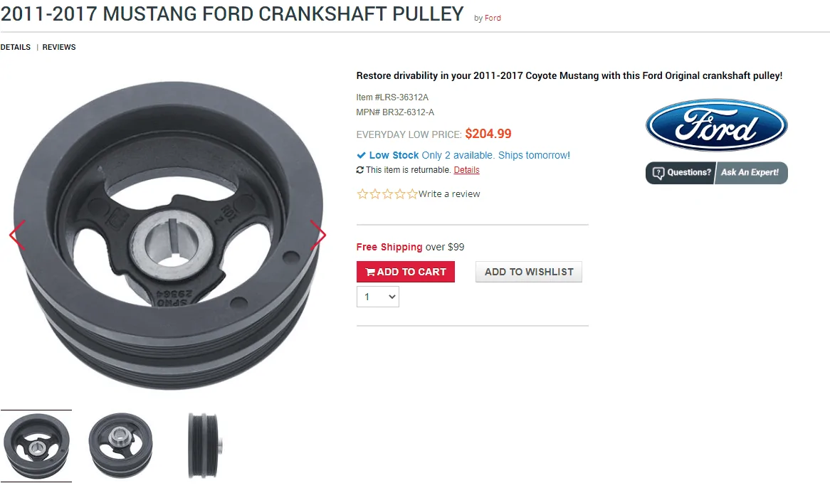

Does anyone have a visual of the dampeners side by side to see the differences - or at least have the knowledge to know what dampener they have before hand?
Any Ford part number references.?
One other thing to note - it does appear that the 2011-2017 damper, is different than the 2018-2023 (Both Elastomer designs) so not sure why Ford went away from the fluid damper on the 2018-2019's.

@bankyf that was my interpretation the first time I read it as well. But I reread it to mean that only late build balancers would be available IF it had to be replaced for some other reason.
