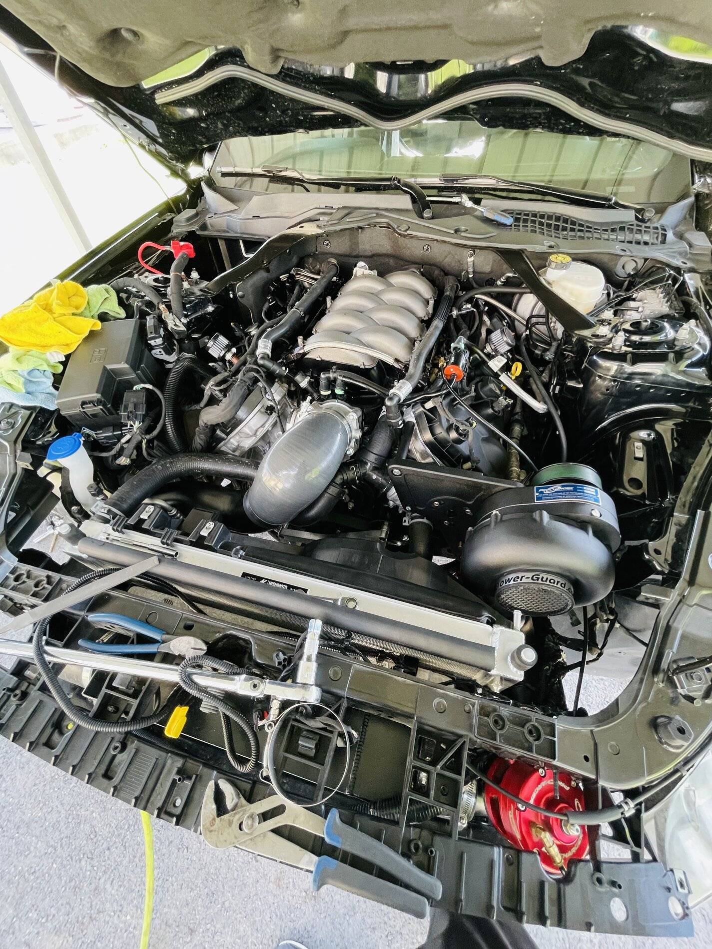

Got her all buttoned up yesterday, now just waiting on a new throttle body. Mine somehow got hit when the crank pulley snapped off, hopefully we’ll be able to get it started today when I get my hands on the new one. 👍🏼
Man, my OCD is off the charts...
Nice work! Will you keep your inner fender wells removed?
Lol I’m going to get everything straightened out this week, I was in a bit of a rush to get it started.
