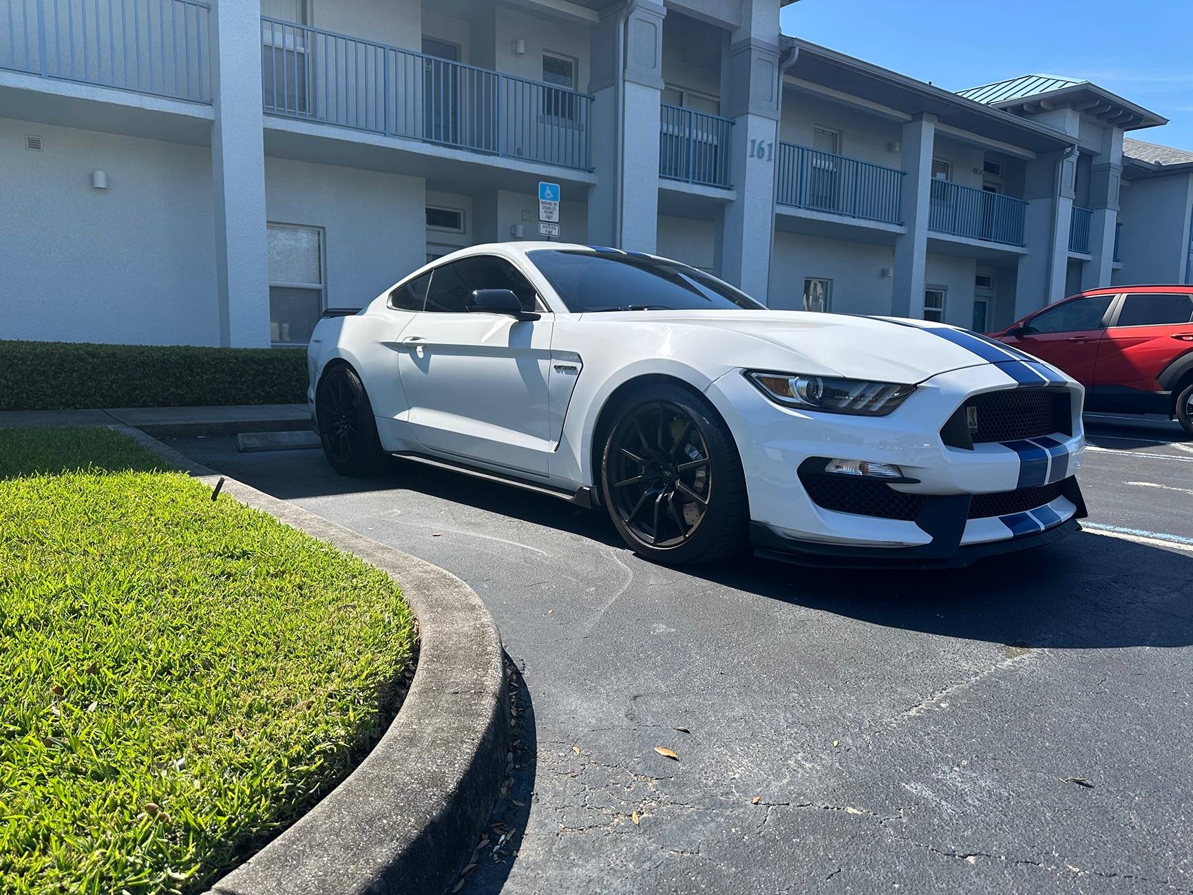

Dodged a bullet. Mechanic said they looked brand new. No deformity or damage.
The springs are fantastic. In normal mode the ride is better. I assume because of the lowered spring rate in the rear. Usually you drop a car and it beats you up more. This did the opposite. I do think I need to the do the swaybars now. I have a few turns that I can reliably get the tail around on and now I felt it pushing more. The lower rate definitely increased understeer. I guess they meant it to work as a package in conjunction with the sway bar kit.
Zero complaints with the FP springs. Aside from the labor for install.

Proper color scheme and everything! You will really like those springs on the road. Any serious track duty, you'd need to go up, but Ford did a really good job with those. Softer rear, stiffer front.
I had the fp springs. Great springs, but they actually do increase the rake. 10 mm drop in the rear, 20 mm front I believe on my car.

Yes if you're going to go FP springs you should absolutely do their matching bars to remain decently balanced. They were my first upgrade and great on the street.
