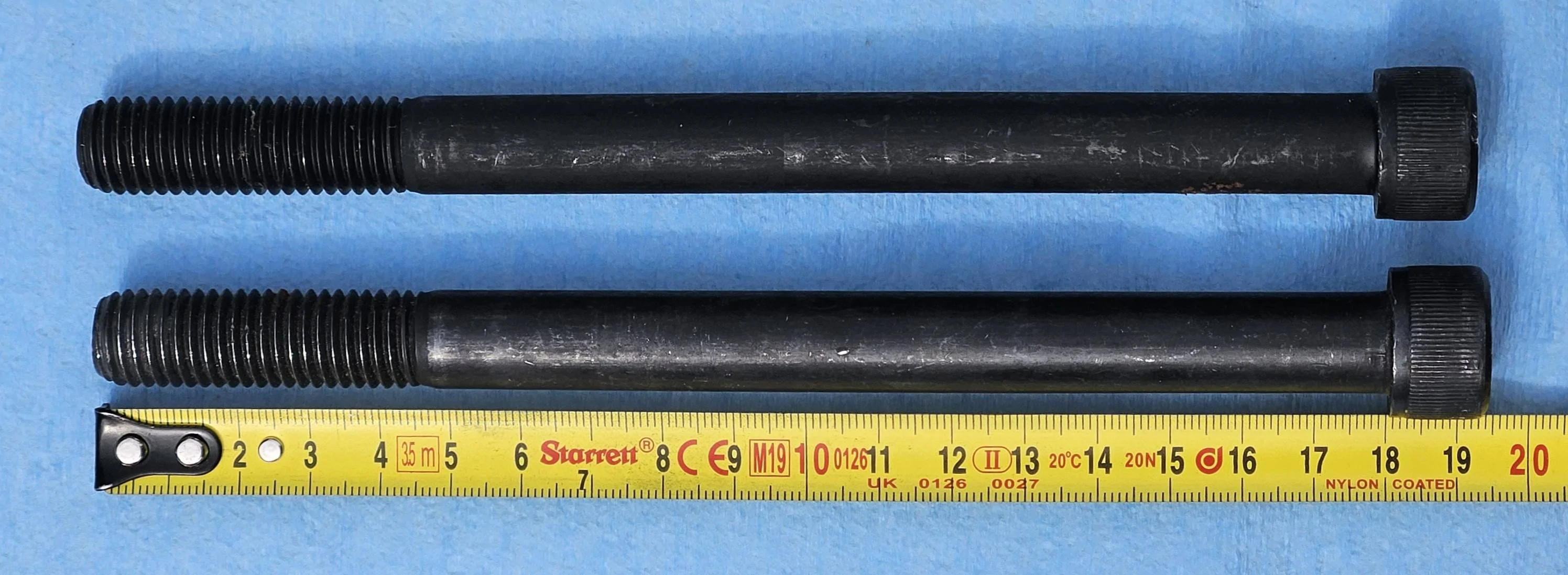

Back in the days of old, when Caliperfexion studs were still but a dream, there was a magical tool that made changing GT350 front pads pretty easy.
They're 180 mm long M14x2 cap screws and they screw into the knuckle where the caliper bolts go. And, the best part is, they're 'way longer than the caliper bolts.
To use them, you remove one caliper bolt, screw in one of these guys about an inch, remove the other caliper bolt and screw in the second one. Then, as easy as can be, you slide the caliper out to the end of the bolts, change the pads, slide the caliper back into place and swap the factory bolts back in.
Brain dead simple.
