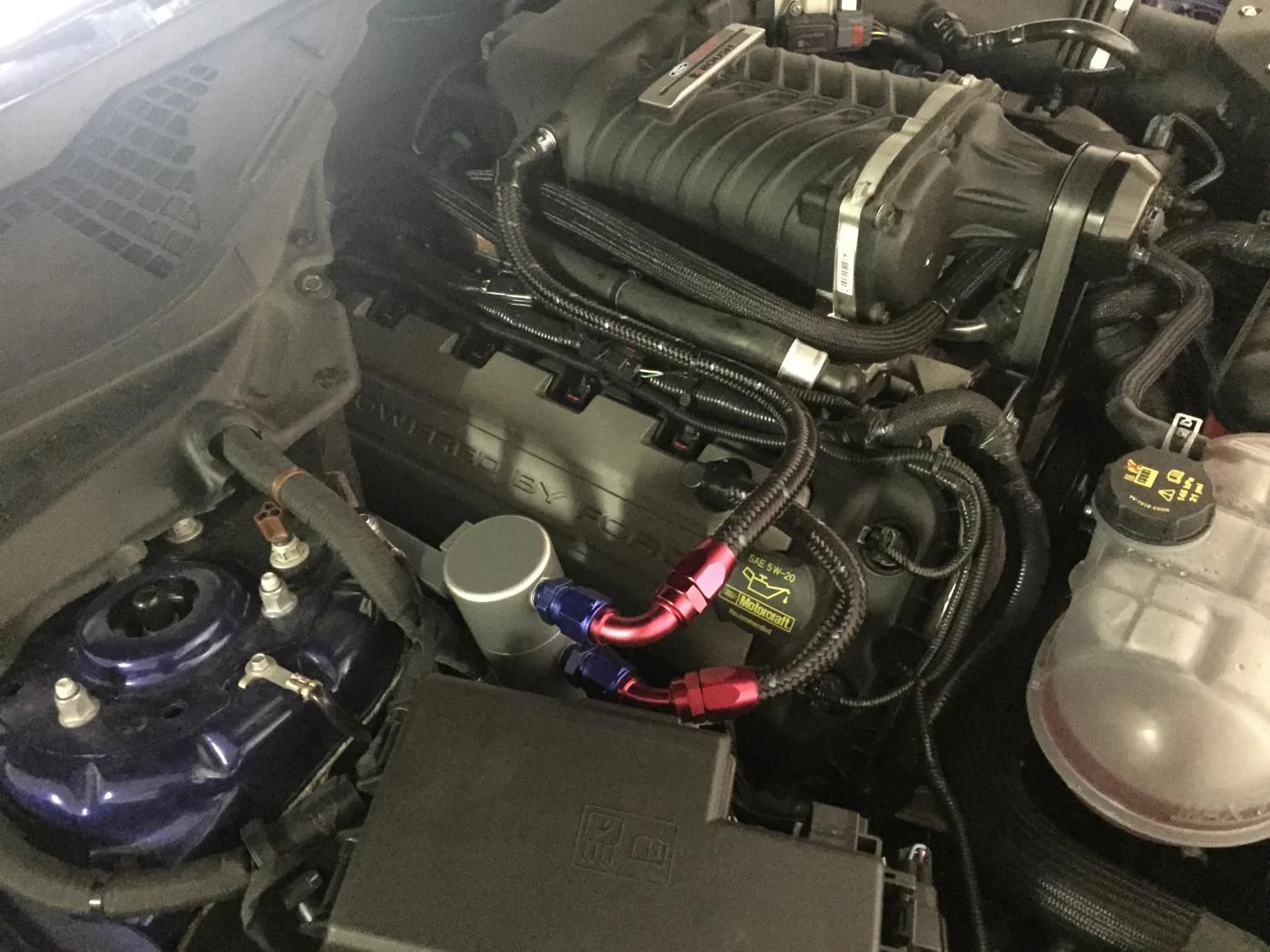

Well since the thread is already resurrected might as well post mine lol!
I thought the small hose from the engine should go into the bottom hole and the clean air back to the intake comes out of the top as the oil is trapped in the screen at the bottom? I just got mine that is why I ask, as no install instructions came with it.

Yea you got the hoses backwards. Long hose goes on top.
That is what I thought, looks like he could be blowing oil into his intake once the can starts to fill!

Well this is awkward lol! I'll have to email Bob's and let him know as the hoses were already installed prior to shipping. Luckily I haven't driven the car since I installed it lol.

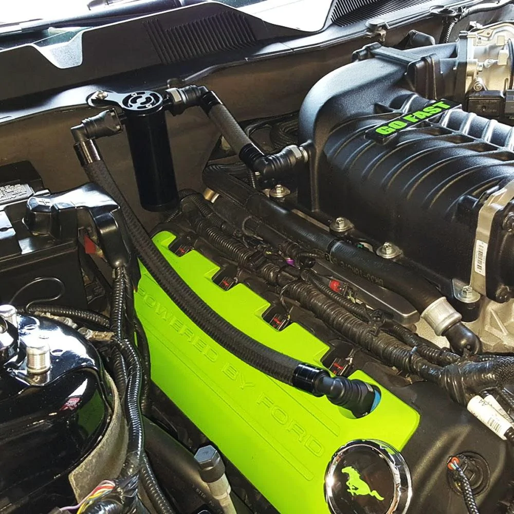

Yup you have them backwards look at my picture above. Post #62
Did yours come pre installed as well? Guess ole Bob May have had a little too much eggnog while pushing these out last month lmao.
Yes, I didn't some research on how they routed before I installed them first just to be sure since I have a supercharged setup. Now looking at his website it looks like the way yours is setup is the same and the 2011-2014 mustang setup is reversed. So now I'm wondering what is actually the correct way.
