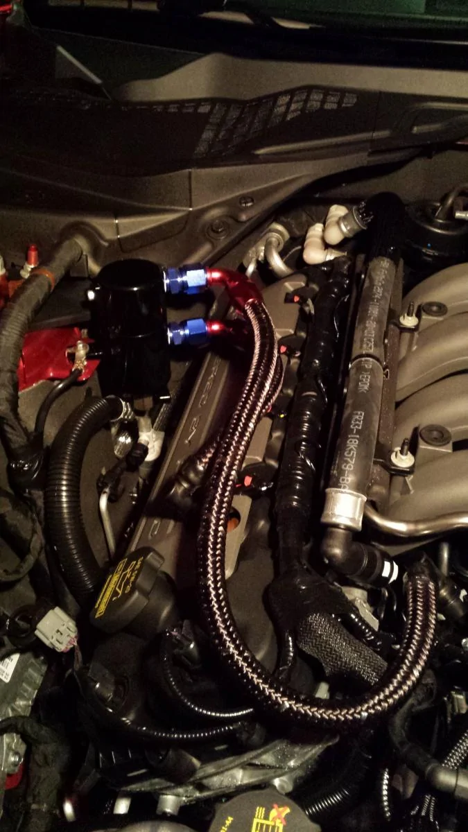

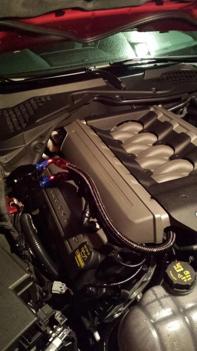

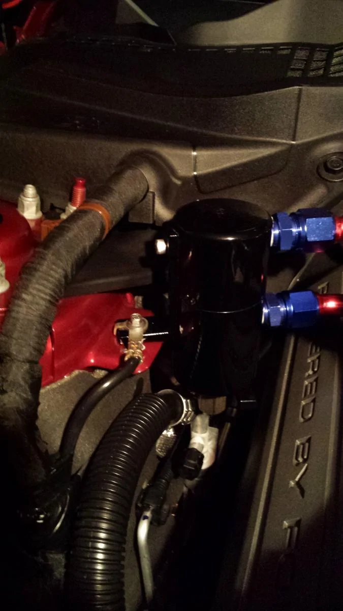

Just a heads up on the test video. The Bob's was compared against our old side by side design and the new design collects more than any system on the market. Many tests get run against our old designs to give competitor's system a chance as our new 4 chamber system stand alone in performance and design. We do offer free floating units and fixed mount units and every aspect of our new systems has been extremely well though out to handle whatever Enthusiasts and the competition can throw at it.Also compared all of the listed separators about a month ago and chose the Bobs. Agree that UPR was very good also. I went with Bobs because of the following:
1. In the comparison test videos it collected more oil.
2. The collection can is secured to the car, not floating.
3. The hoses and fittings are outstanding and look great installed, especially the red/blue AN fittings.
4. Wasn't true "plug and use" but all I had to do was use the Bobs supplied heatsinks in connecting the braided lines to the original valve cover and intake fittings. Took all of 10 minutes and they're permanent. The supplied braided lines are the right length and didn't need cutting.
5. Don't have to unscrew the bottom of the collection can to drain the oil, just open the valve on the bottom.
They're both good separators but that's why I chose the Bobs and it looks awesome under the hood.

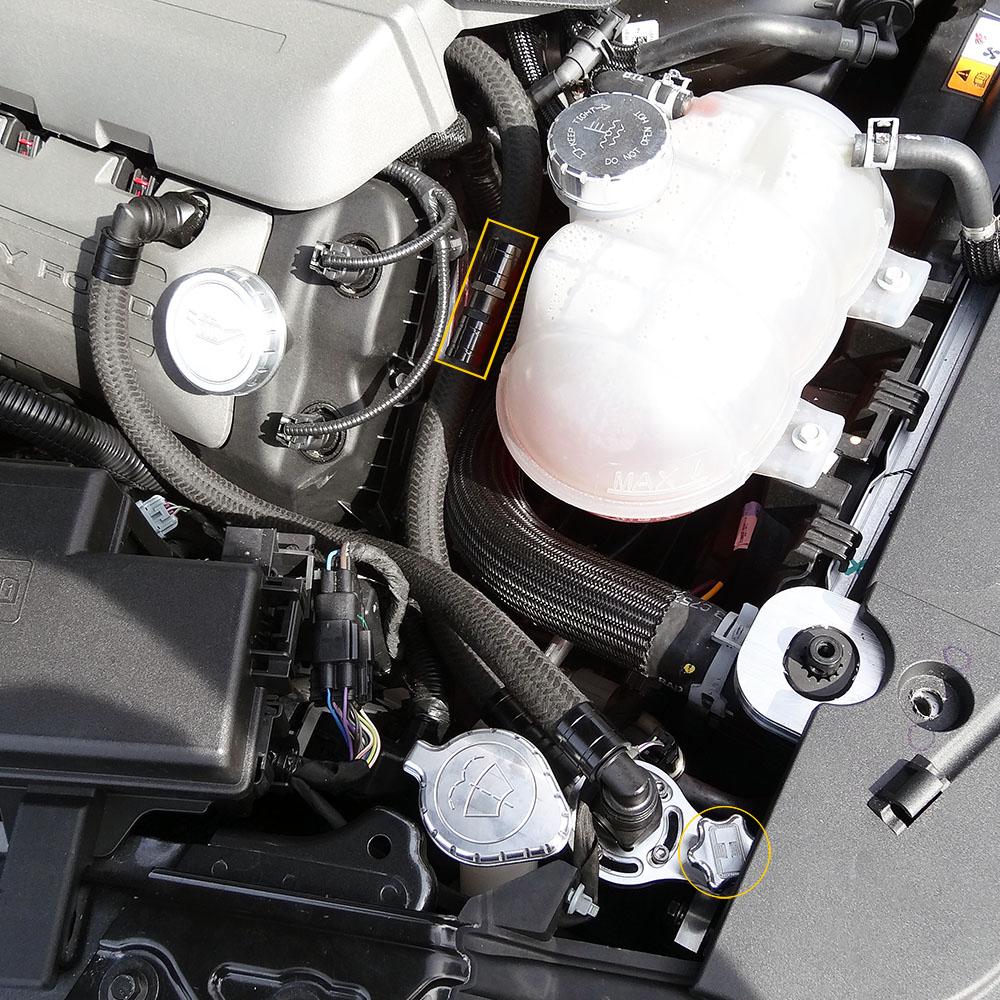

Never come into contact is inaccurate as we have already seen people test them and it can and will pass oil because of the location and temperatures the can reaches, never allowing the oil to cool and condense properly results in the mist / vapor to be pulled through. If you would use more of a remote location for the can to cool down some it would greatly benefit your design.One of the other benefits of the patented Bob's can is our bottom to top flow design. On all of the other brands, the oil is filtered at the inlet, and then drips down and sits loose in bottom of can. Between engine torque, speed bumps, G-forces, the oil 'sloshes' around and can splash against the outlet and then be pulled into the engine.
With Bob's having all the media in the bottom of the can, the oil is trapped down there, and NEVER comes into contact with the outlet. :cheers:
