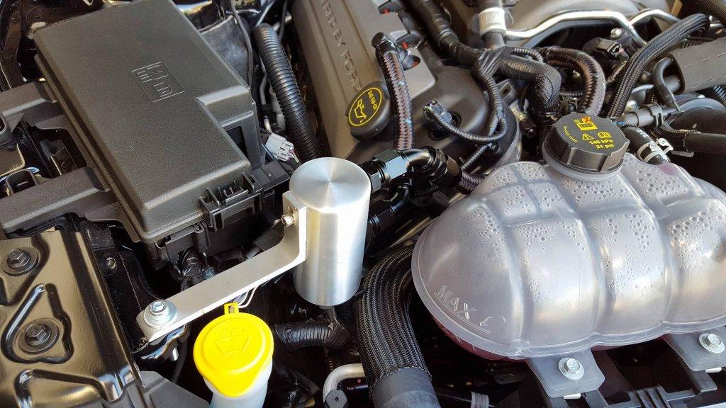

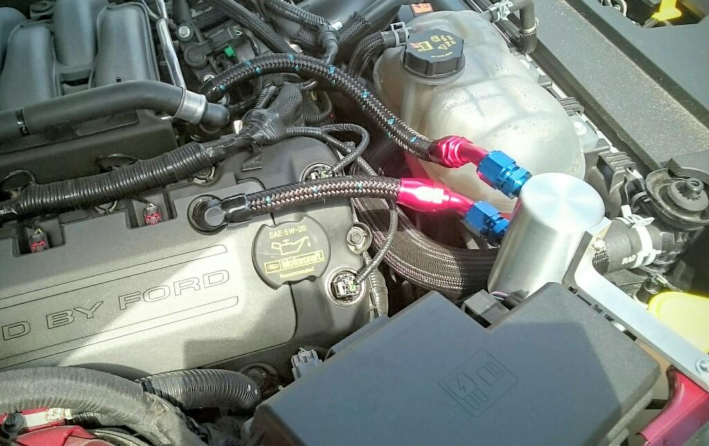

FINALLY installed mine today. Used the alternate mounting spot up front like gtbob and some others have done. Came out nice, IMO.
Nice! I like the colored fittings.

Thanks- I'm toying with the idea of replacing the top angled fitting with a straight one, because when it's mounted where we have ours, you don't really need an angled one there.
Looks great [MENTION=20095]jdoug[/MENTION]!
