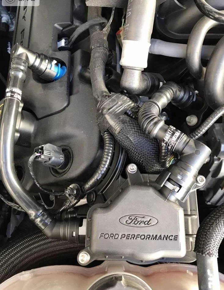

How do you empty the Ford one? Looks like screws into plastic I'm guessing? Over time I'd be concerned that would be a PITA vs unscrewing a steel canister type, plus the risk of stripping threads from numerous emptying cycles?

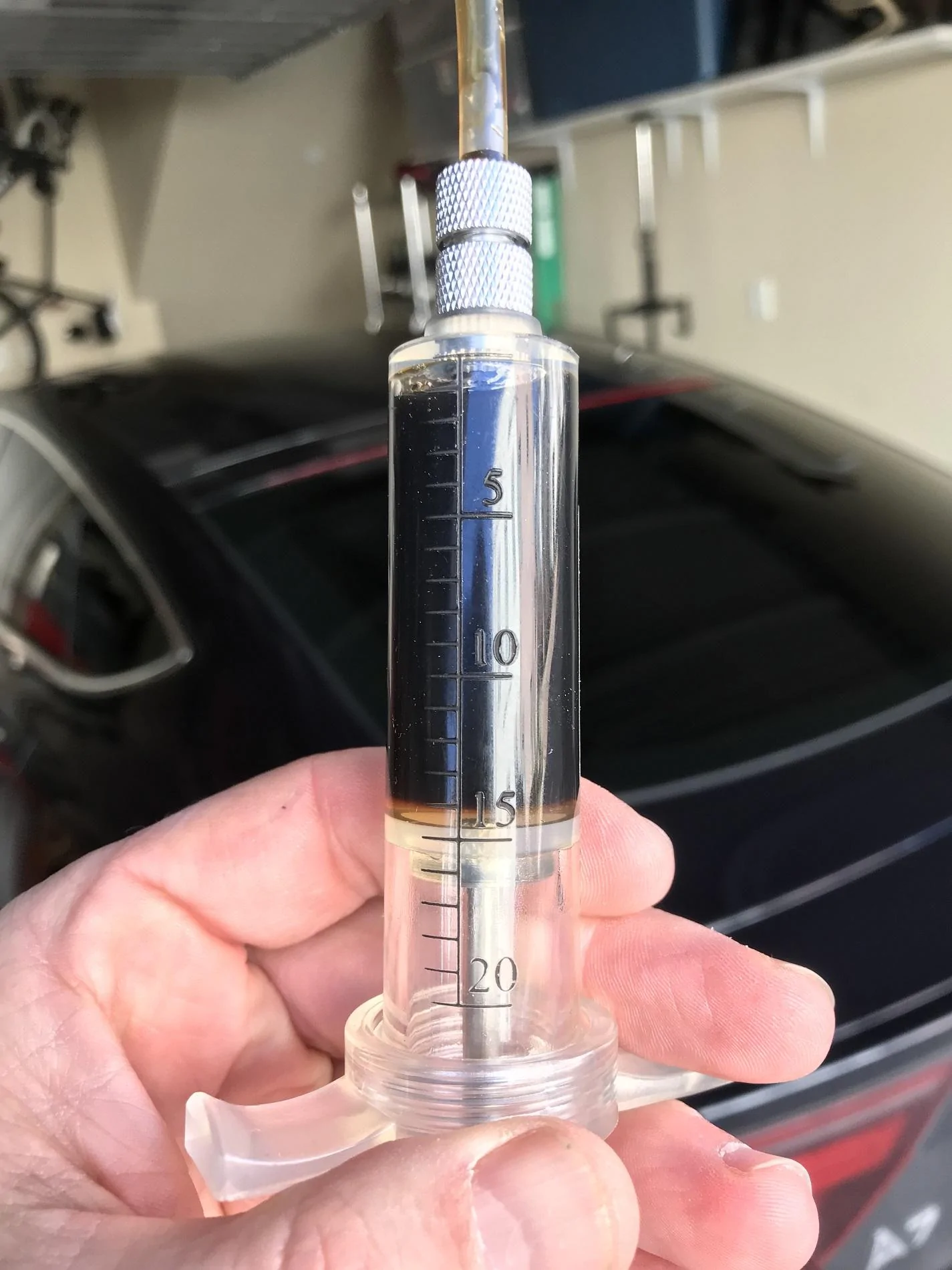

I had one on my GT350. I emptied mine by unscrewing the 3 screws on top which screw into metal inserts in the plastic so no worries on stripping them out. I then used a syringe with a rubber tube to draw the fluid out.
If you want to "dump" it out you would have to remove the entire can from the hoses to dump it. The hoses attach to the bottom of the unit so no way to remove it with out removing the hoses.
You have to remove the top for both methods so I saved a step by using the syringe.
This is how much I pulled out after 500 miles or so of very aggressive driving.

Houston, hope you’re enjoying your new ride :)
If you don’t mind me asking..... where did you get this syringe? I’m looking for an easier method to empty out the oil.....

I got one at a local auto parts store for $5. Dude it's so easy. Literally stick the syringe in once and suck out the oil. No mess at all.
I like it bc it looks stock.

You can unscrew the cover like mentioned above or pull the hose and use a syringe to suck out the oil, based on other maintenance jobs performed on this vehicle this isn’t a huge undertaking. I’m sure the amount you catch will vary on any vehicle.

Loving it actually and thanks. The one in the pic is from a mountain bike hydrolic disc brake bleed kit, but you can find them on Amazon here that will work just fine.
https://www.amazon.com/EXELint-Disp...e=UTF8&qid=1521495019&sr=1-4&keywords=syringe
Or like Monopoly said, go to Vatozone and get some!!!!

The FP one has a fine metal mesh screen filter in it as well. Not sure if the others have that. It is very serviceable easily cleaned.

The nice part about the Ford unit is the capacity is so large, you only need to dump the oil once every oil change or so. I also unscrew the top and use suction to get the oil out.

The OP of this thread either has/or will be getting a 2018. The Ford Performance Oil Separator WILL NOT bolt up to passenger valve cover on the GEN3 motors. The bosses on the 11-17 valve covers are gone for '18.

I was wondering why I have not seen a FP for the 18s. I now have an 18 and have been looking for a FP with zero luck.
