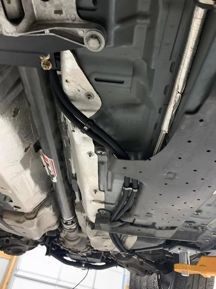

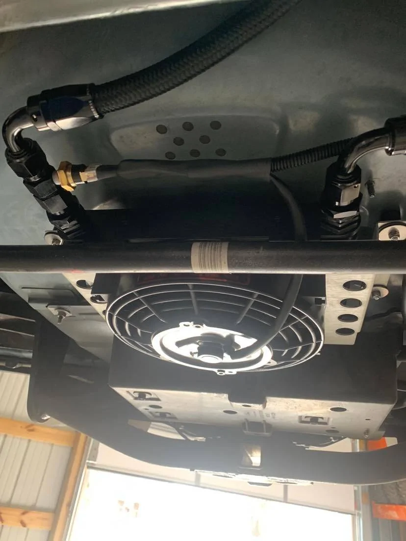

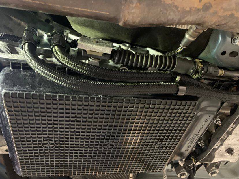

I have the better clutches kit
a 934 setrab cooler.
A bypass .
Max temps on track 160f.
Technically you can always stop airflow to the cooler if you want to keep it warmer.
I honestly believe the cooler the better for q transmission. Of course a minimum warm up always needed.
Thanks to by pass im considering reducing again the size of the cooler. So i can put a way bigger engine oil cooler.

i made it . it is a metal cylinder that substitute the thermostat keep it open everytime. I m gonna make some of them .will post on the big 10r80 thread, when I have them :)
