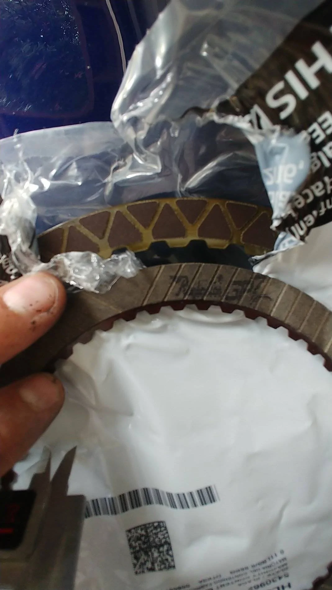

Fyi
Reybestos GPZ sold by McLeod (1.75mm)
Vs
OEM (1.68mm)
Also more friction material.
