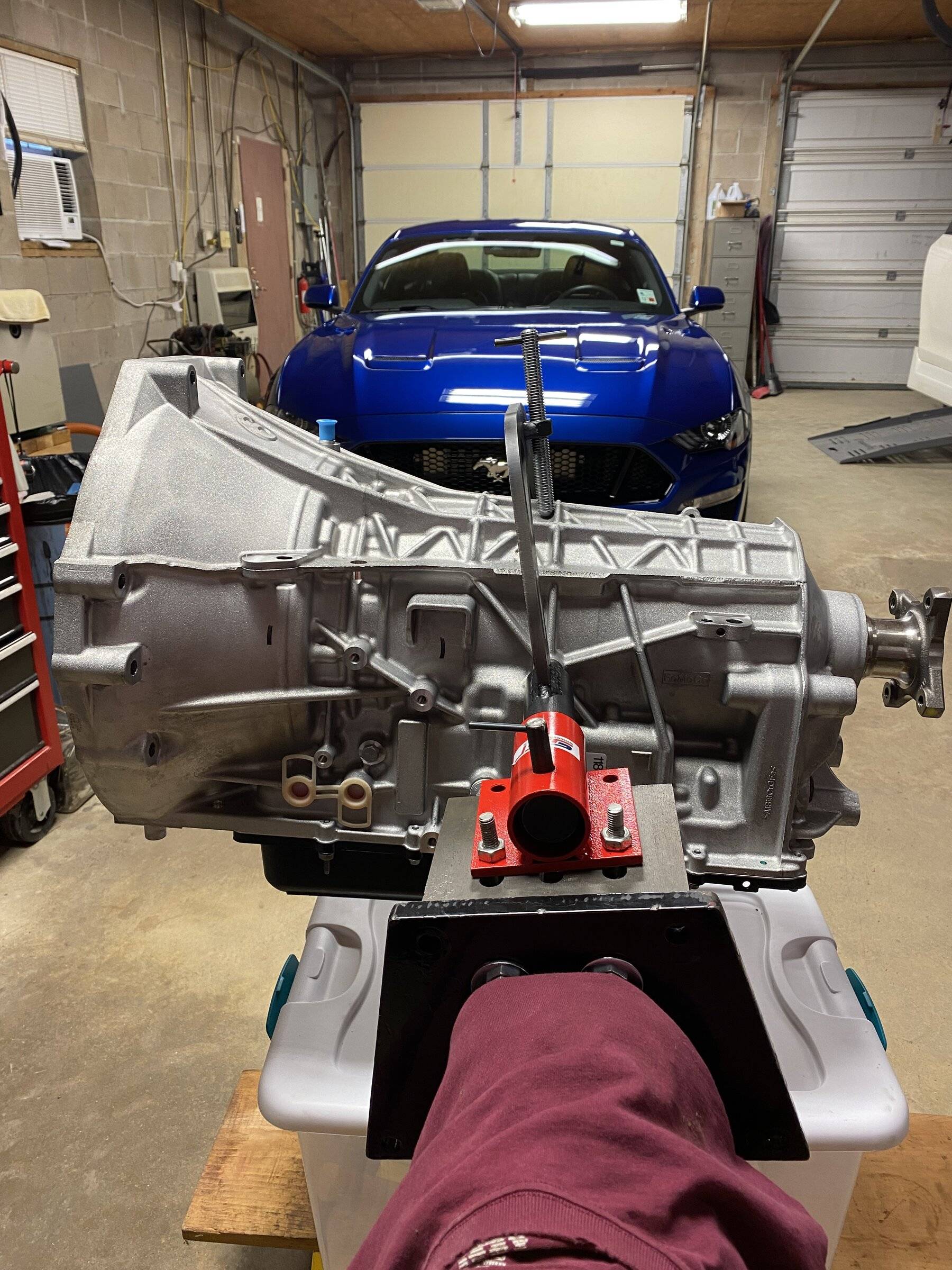

I have a great friend with an excellent, 2 post lift. We discussed the trans swap and I think it would be better to pull and reinstall the same day.
Besides, I would feel better with a spare trans, just in case. I have a spare long block, so a spare trans makes sense. I am going to build the original trans as a spare right after we get the new trans installed.
Built a simple adapter so I can mount the trans on my engine stand.
Received the Suncoast upgrade kit today, so the plan is to tear down this new trans and upgrade over the weekend. Once installed, I will download the solenoid strategy, then tune the trans for boost with the Tuning School software

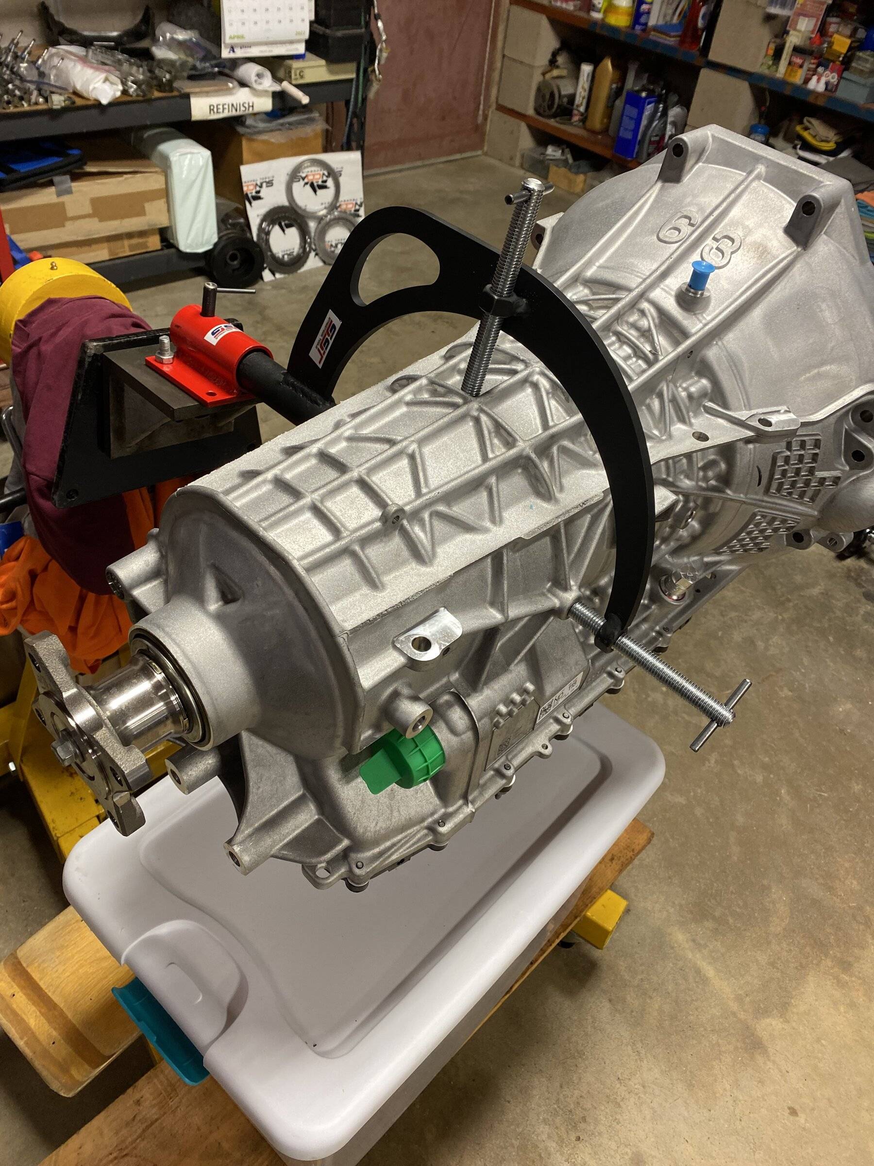

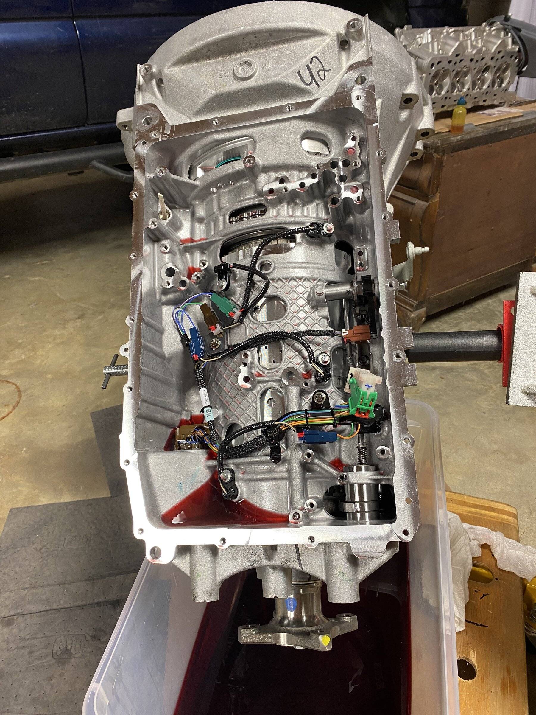

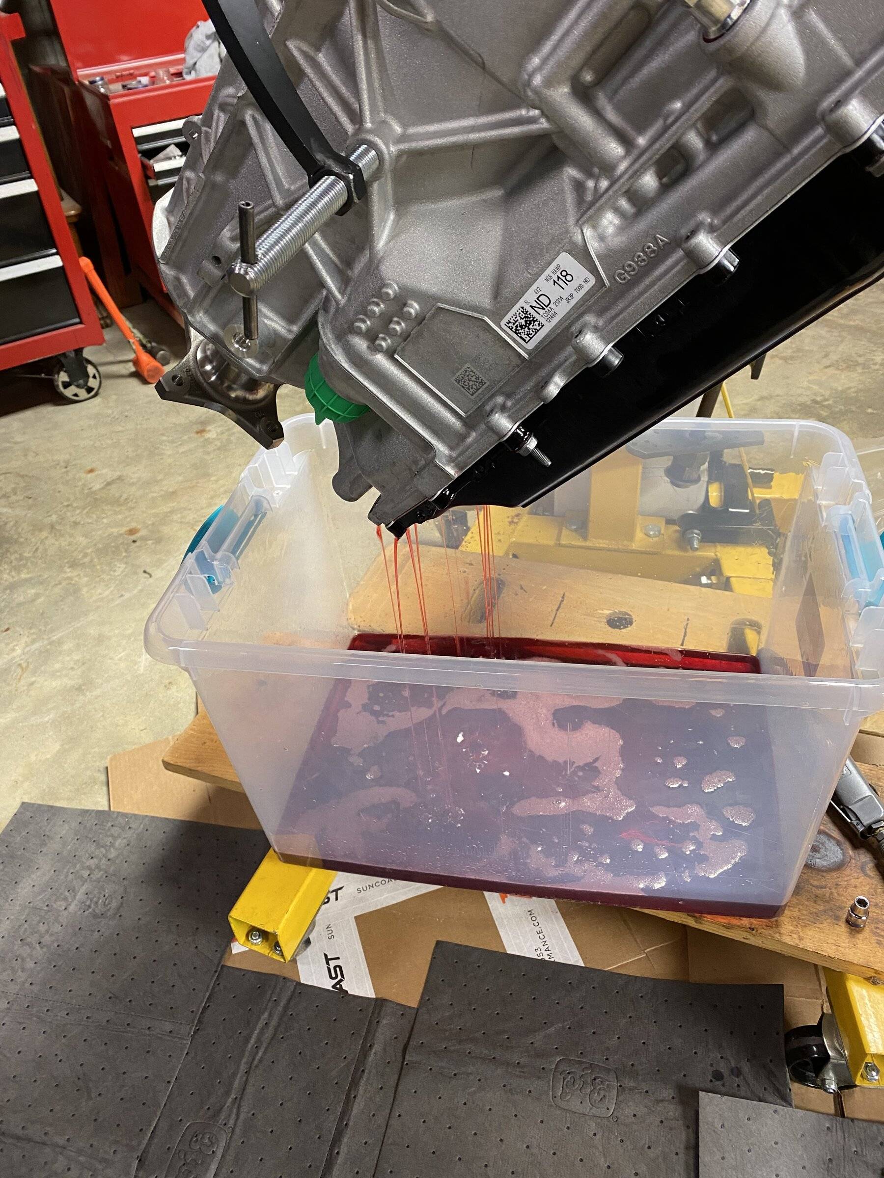

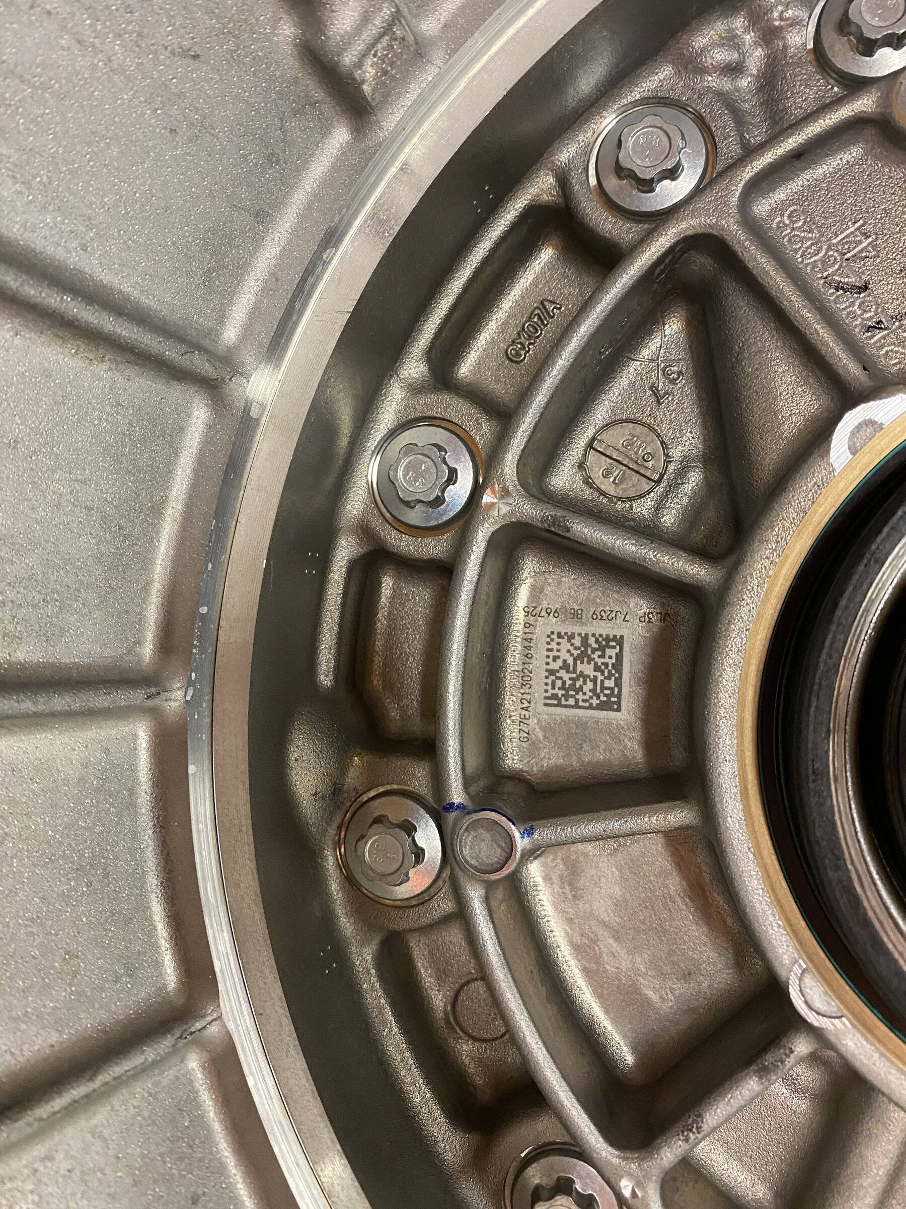

A few pics for fun:
1st photo draining and saving the new Ford factory ULV Trans fluid.
2nd photo shows the valve body and fluid pump removed
3rd photo shows the special External Torx head bolts that hold the stator in place
The adapter I made for holding the trans on my rotisserie engine stand works wonderfully.
