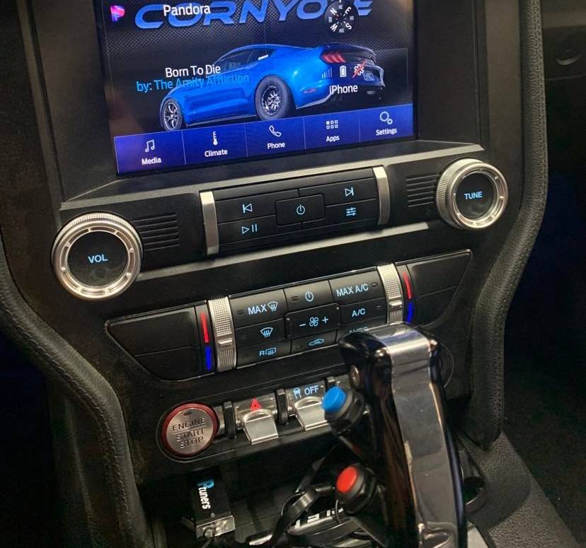

What shifter is this?, buttons are integrated?
Hurst shifter for 10R80, then their side plate with buttons. I removed the Hurst buttons as they were momentary and added my own latching ones off Amazon. Blue button controls the trans cooler fan bypass and red button bypasses the ABS module to turn all the traction nannies off.
