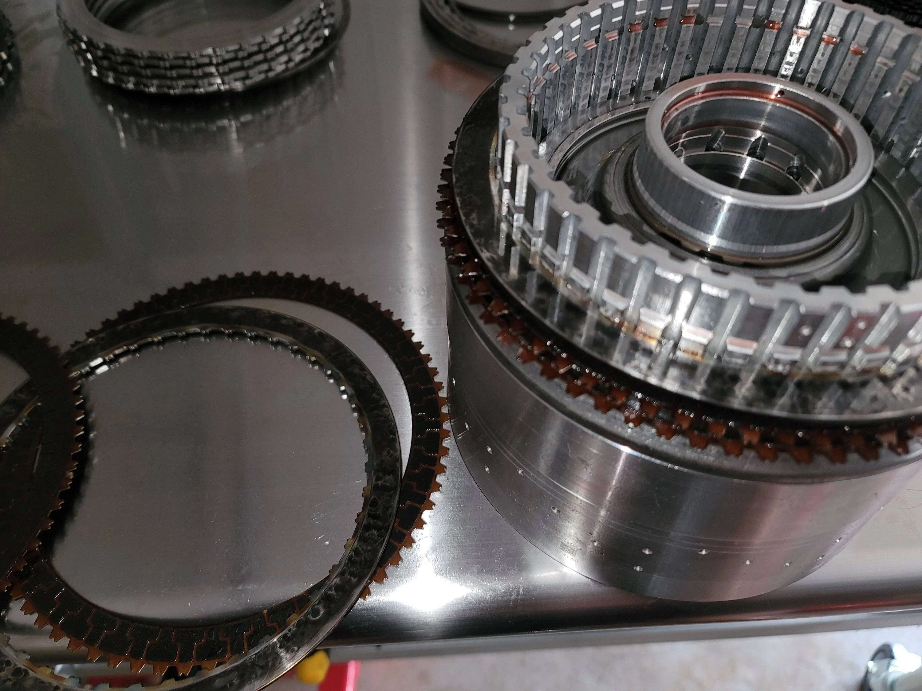

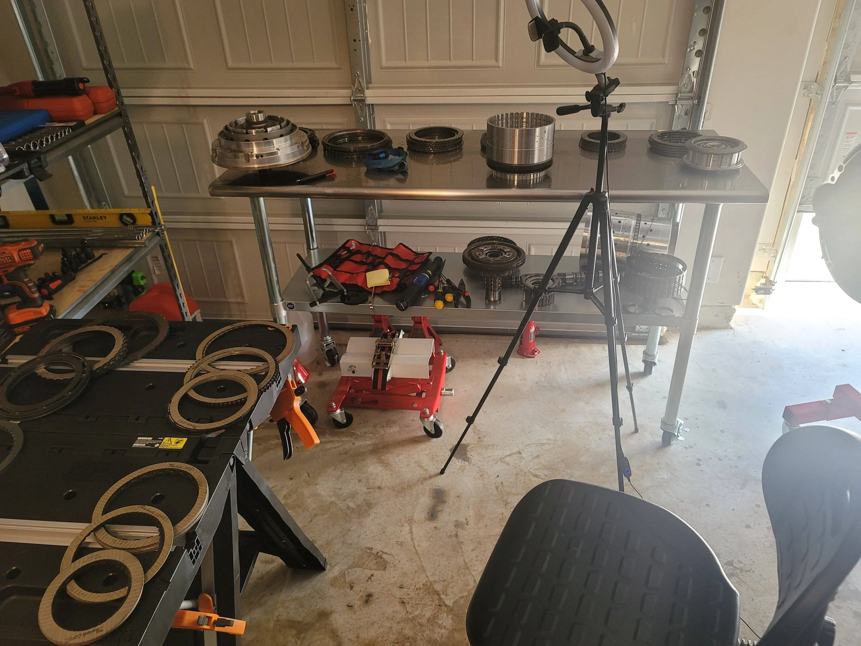

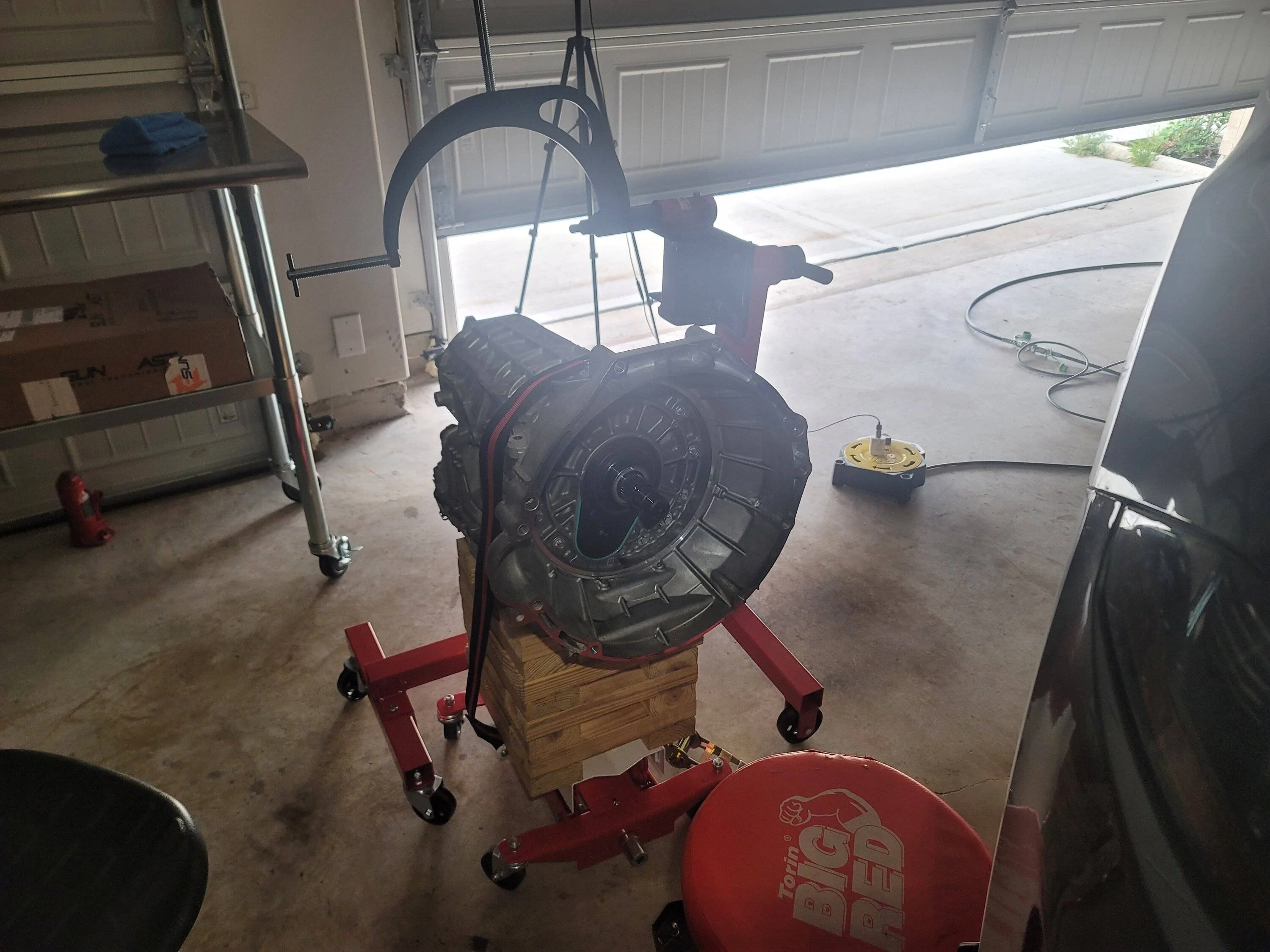

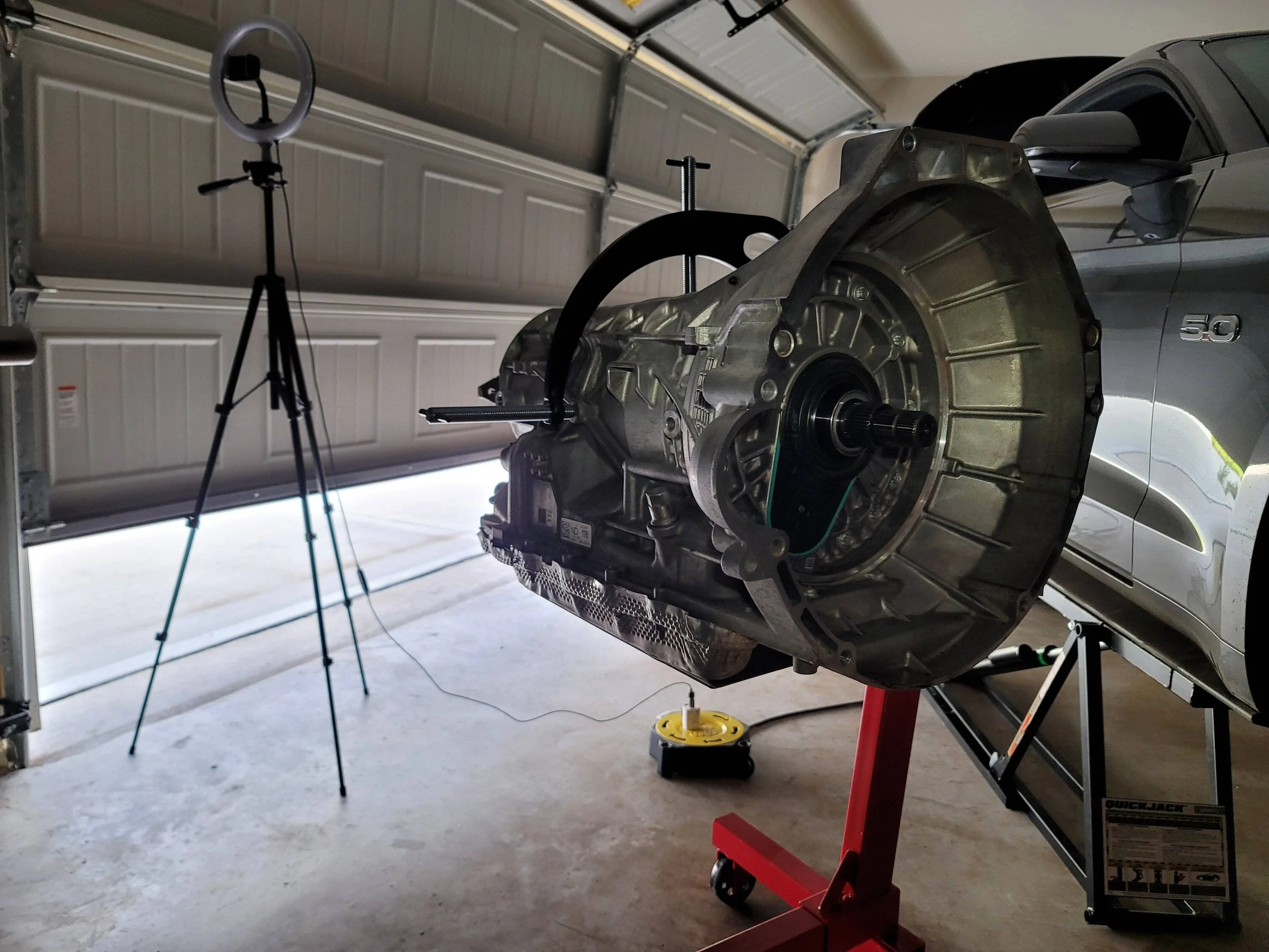

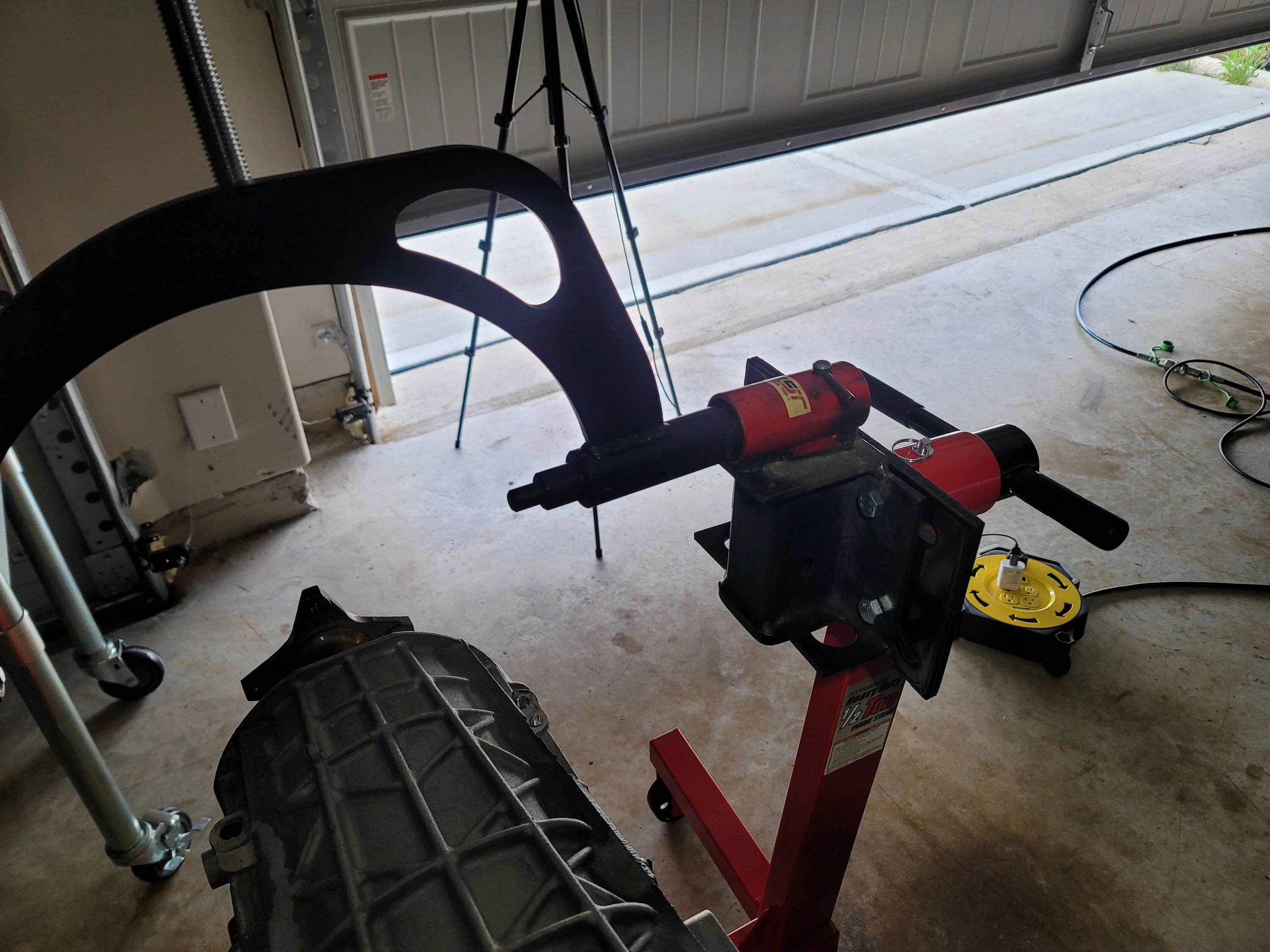

First time working on a transmission. There are a few YouTube videos that were very helpful.
Took about 4 hours for me to get them out with the car on QuickJacks.
Probably can take less than 2 - 3 hours if you have a proper lift.

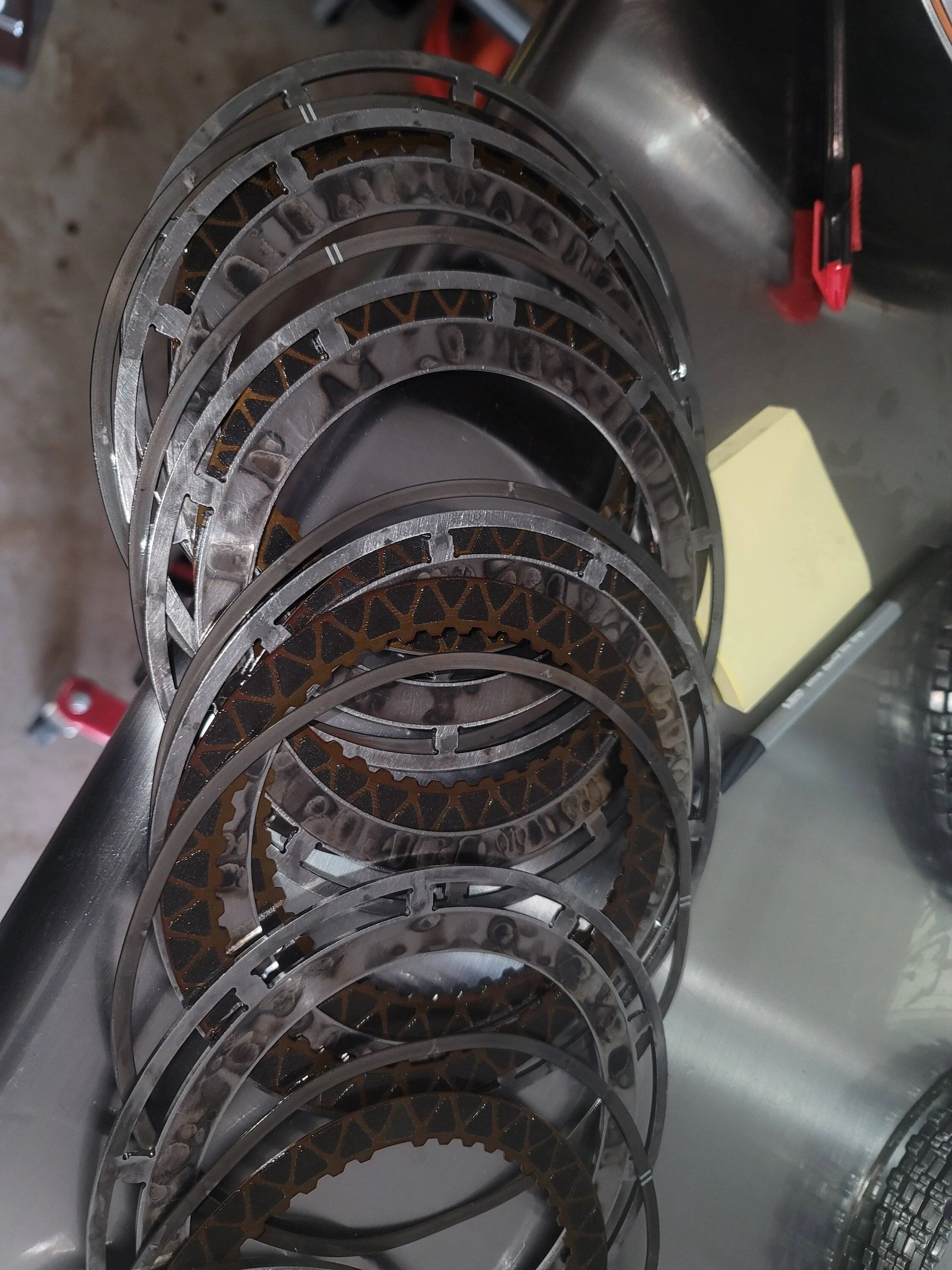

I have a new 10R80 going in which I'll upgrade with Suncoast clutches but I took apart and reassembled the one that came out the car to practice and also to figure out the issues I was having with the trans.
B and F clutches were toast with the F clutches so bad the bottom three steels were stuck to the drum.
I'll also be doing valve body bypass deletes when I can get my hands on one paired with an external thermostat and beefier cooling setup.
Power By The Hour suggests changing the trans fluid and filter more frequently with forced induction, at least every 5 - 10k miles depending on power level and how hard you push the car.
Overall was easier than I thought it would be and is really just like Legos 😀

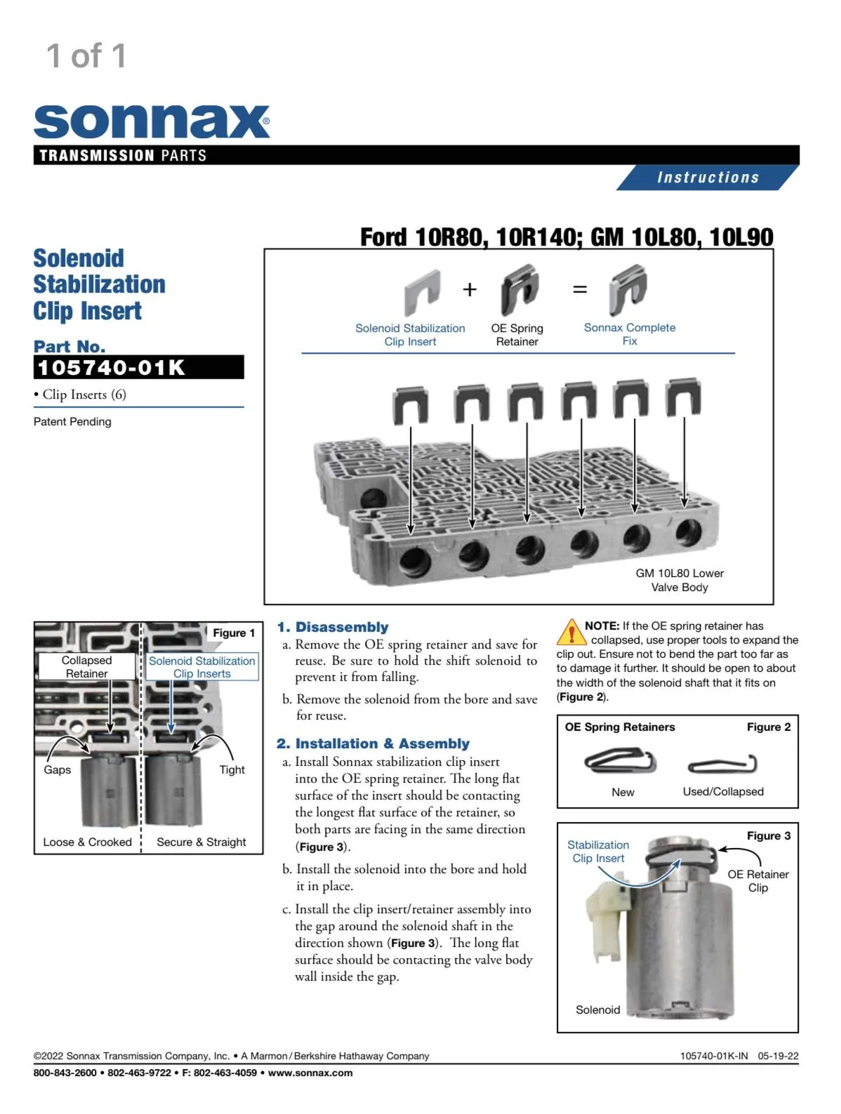

Check that Cdf drum bushing…
and get the sonnax solenoid spring clip “fix”
