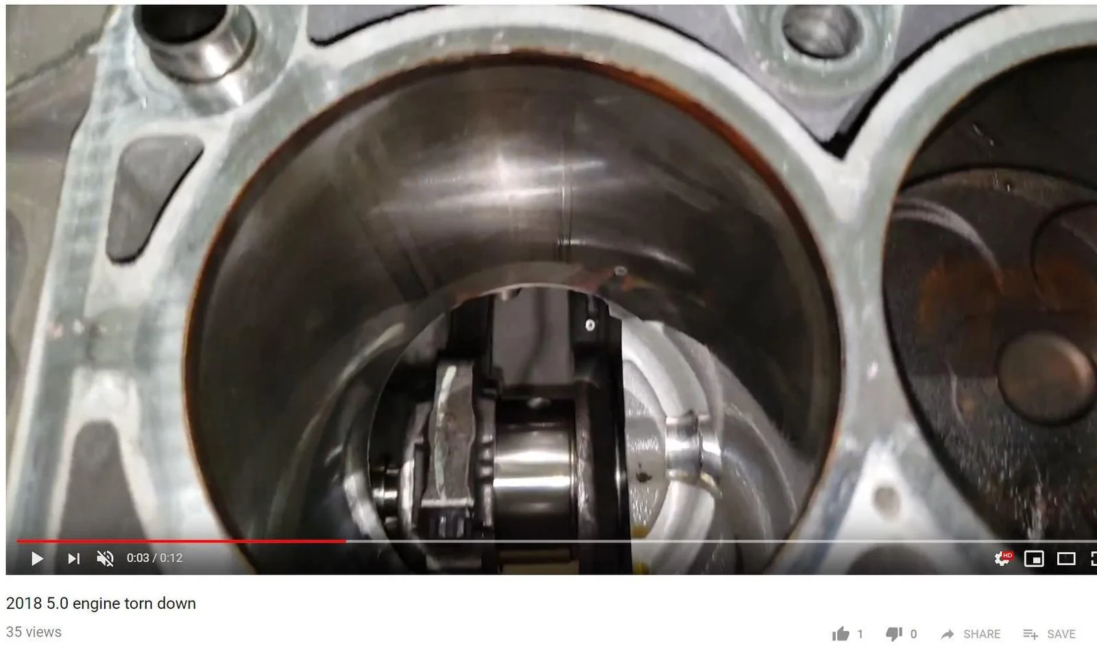

Andy13186
Sep 19, 2018
110
2,523
1,565
2018 Mustang GT 10speed Aluminator Whippled
This is a pic of the scoring I saw in the 5.0 I found disassembled in the shop with a piston removed. Didnt hear what the mechanics plan was since he wasnt there but just noticed this on a 2018 5.0 What do you guys think about this? :
