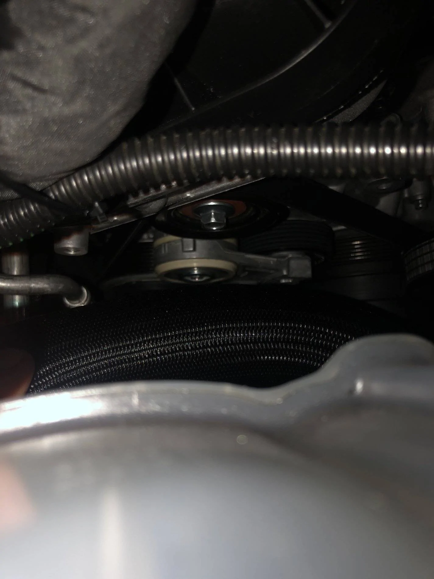

Mine will tick when it is cold. It will tick some when cold and it is rev up to about 1500-1800 rpm and let off. I did it tonight and the oil pressure is high since the engine is cold (even when letting off the gas).The typewriter tick IS NOT piston slap.
It's most likely Lash Adjusters not being fully inflated when oil pressure is below 30psi at low RPM. Temperature really doesn't have much to do with it. When you start it up cold, it won't tick much, because the cold oil is at almost 40psi during warmup, so the HLA's are fully inflated. Once oil warms up, and rpm comes down to idle, oil pressure drops below 30psi and the ticking starts.
Do you have oil pressure gauges on your car? Do a cold start and watch the oil pressure gauge and also the digital temp gauge and notice when it starts ticking,.
