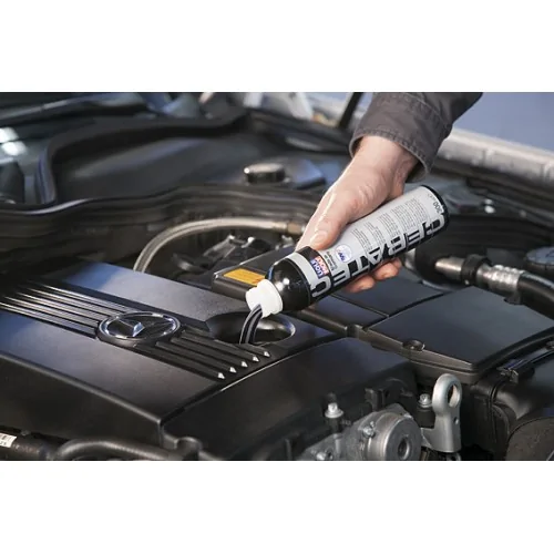

Add ceratec. Ford says won't fix anymore. Some of those those who got new short block got the tick back again. So by now ceratec is the only cure. I got new short block and added ceratec to oil before the oil change, just gave it some miles to break piston rings in. Several thousand miles after still go through my checkpoint places to cerify I do not have it.

that ceratec in that pic is not actual current ceratec lol... its like orange now. Must be some prior formulation?? I have no idea. ^ That looks like MOS2 which did nothing for me.
C'mon man. The picture was for attention.
I just dont know why its black in the picture but orange in reality. I would have been concerned if I was expecting black liquid but it was orange so I wanted to just clear that up because ceratec is actually orange.
Instructions say to shake it good.When I do it comes out orange. Maybe they just didn't shake it well. Anyway all is good. :like:
