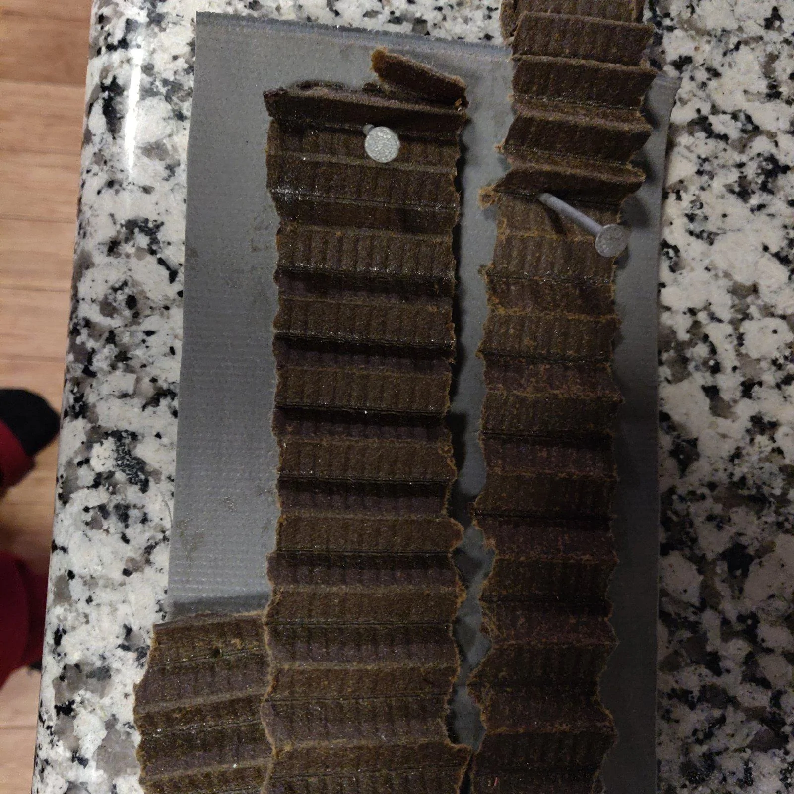

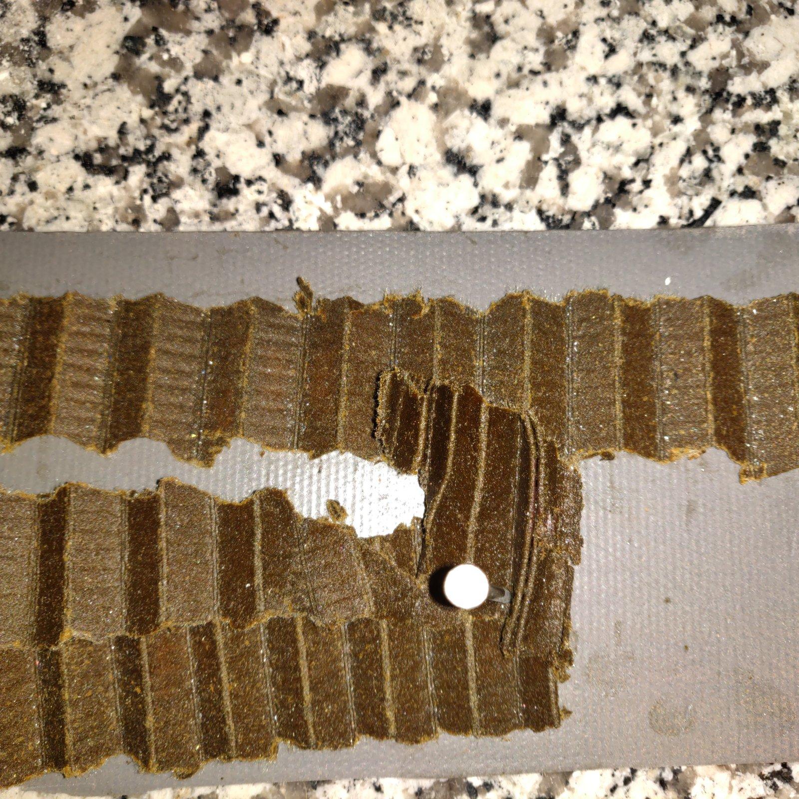

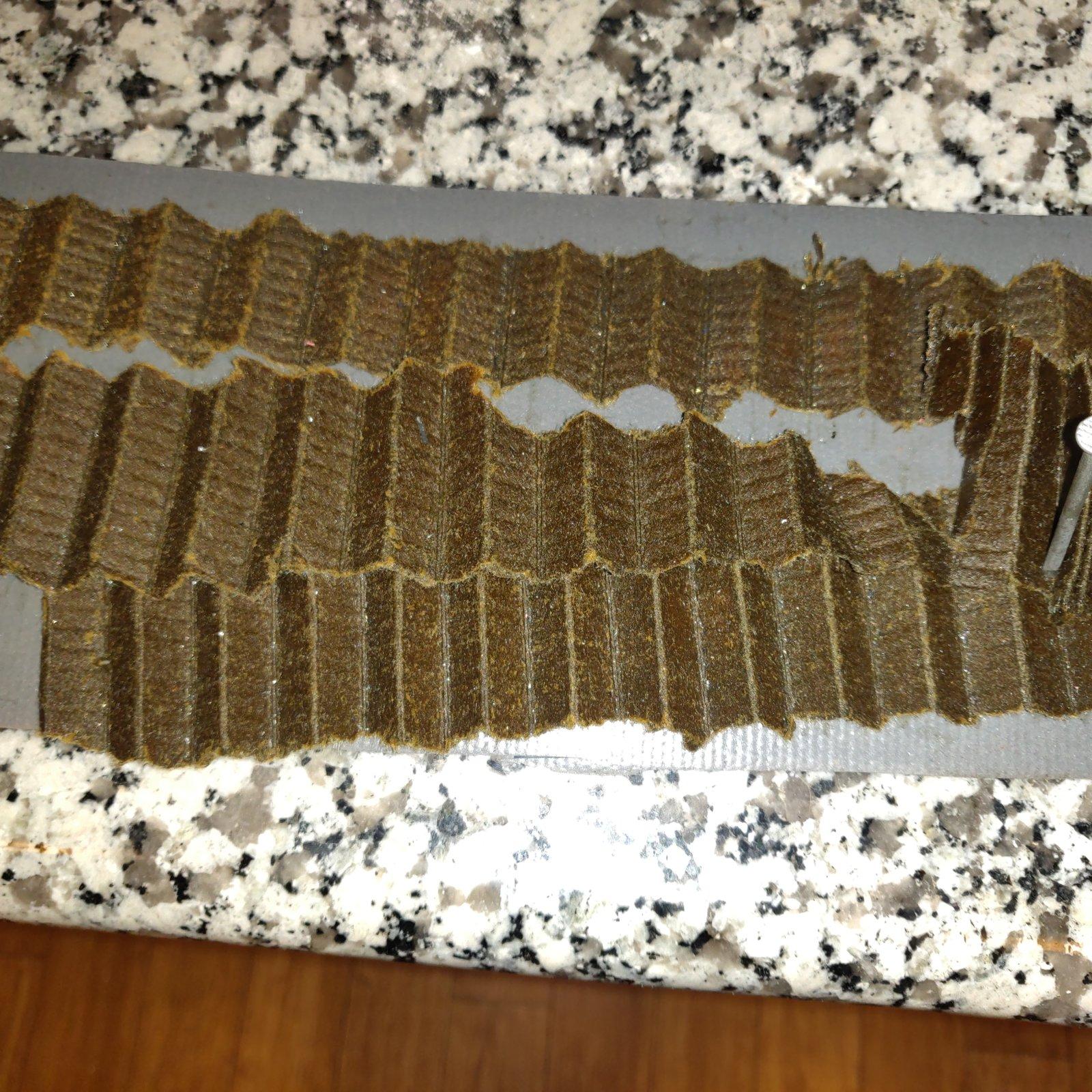

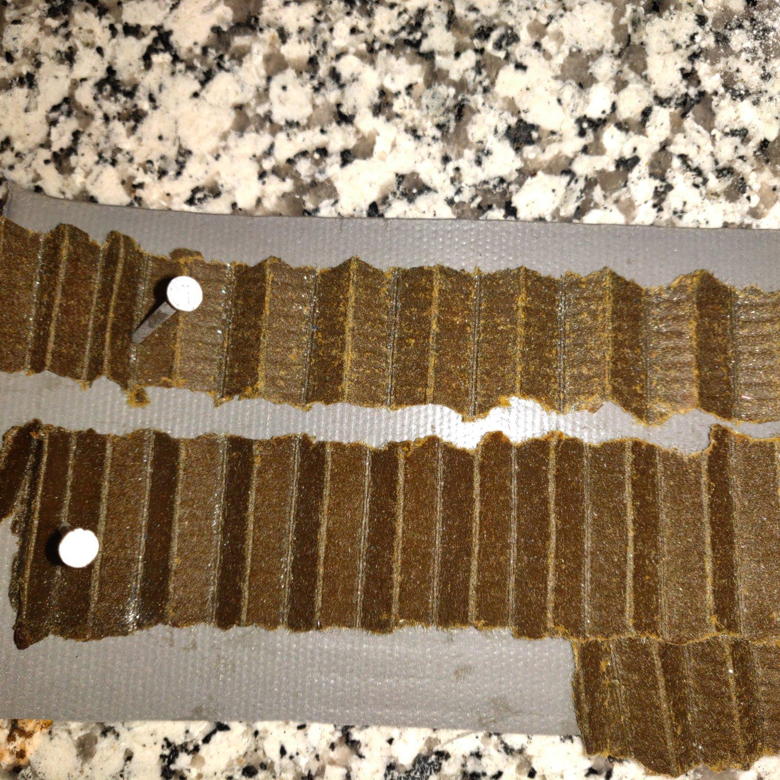

Well here's the inside of my factory oil filter. The glitter really crammed up in some corners. The pictures are hard to tell but in person it is littered with silver and copper colored flakes. Some I would call chunks. I'm going to call my dealer tomorrow.
How many accrued miles are on your vehicle?
Just remember if it’s low miles, *some* material will be normal due to engine break in during the first few thousand miles... in no way am I saying that your findings should not be of concern, but just laying the factual info out there for other folks who have never opened an oil filter and don’t know what to expect.

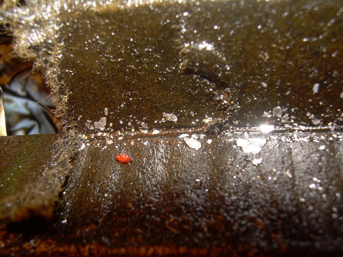

That may actually be normal believe it or not. It's not ferrous, so it's either rod bearing material or possibly Zinc from the ZDDP as the tribo film breaks down. Looks up "gold ferry dust in catch cans". I get a bunch of it in my catch can at the bottom (about as much as you see in your filter) every 1,000 miles. It's been there ever since I added a can, before and after TriboTEX. There are tons of Camaros, Corvetts, Chargers and challengers that all get that in their catch cans every time. I'm not aware of any of them grenading either at an early life and there being any link between that and the issues.
I believe it may be normal wear from the rod bearings during cold start (first couple turns) and shut down when they make physical contact with the crank journal before the there is enough oil flowing for the hydrodynamic fluid film to form or when it collapses as you turn the engine off. It will be interesting to see if using the thicker Ravenol 5W-20 reduces that at all or it has no effect. I may even try 5W-30 once at the next change just an experiment to see if it changes even more but I suspect it won't make a difference.

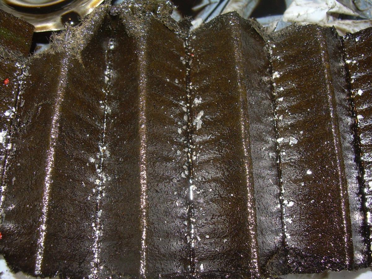

My guess is that if it is aluminum, which my "fairy dust" doesn't seem to be magnetic, it is from a combination of sources such as the pistons and rod bearings. Seems to be pretty common and moderate quantities of "fine" dust seems to be normal but large chunks or particles are more likely to indicate an issue. I would expect 2x as much dust out of the 5.0 as I would something like an Ecoboost 2.3L.

Here's example where there is a problem (this is from a Miata Turbo with a spun bearing, see the very large "sheets" of aluminum or steel?):
The forum links I posted above show normal wear and tear, very fine dust, barely large enough to be visible. Looks like actual shiney dust particles.
Here is the original link: https://www.miataturbo.net/engine-performance-56/metal-flakes-oil-filter-65360/
It's quite a bit of a difference between what you see with a failed rod bearing and normal wear.
