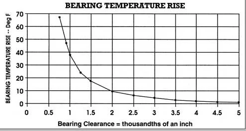

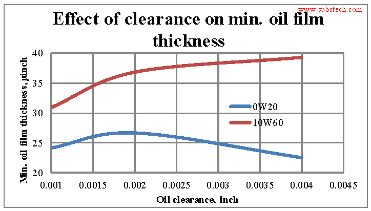

Here's some good journal bearing info. It basically says higher viscosity gives a thicker MOFT (even though it causes more shearing and heat as seen in the first table), which is the recurring message in all the technical info you can find about journal bearings. The local bearing oil temperature rise effect is most likely taken into account - it would have to be in order to determine the true MOFT in the bearing.
http://www.substech.com/dokuwiki/doku.php?id=oil_clearance_and_engine_bearings
I also attached a few graphs showing bearing info on what effects the MOFT, which is what you should always try to achieve the most of. Also, tighter bearing clearances gives a higher temperature rise in the bearing as the oil shears because tighter clearances flow less oil volume, which is what helps cool the heat from shearing.

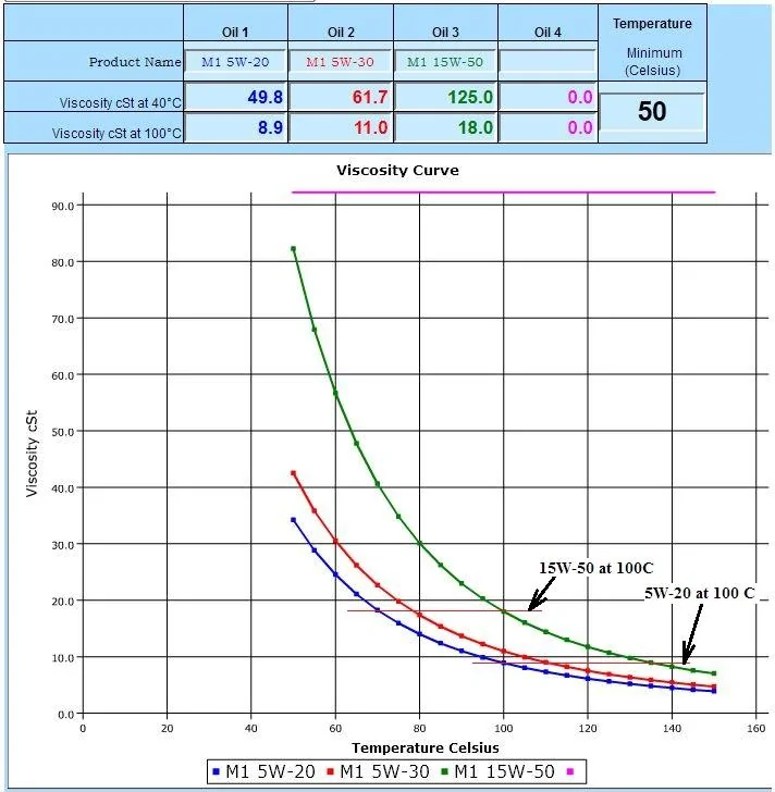

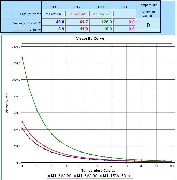

If that was the case, you better not go over 2,000 RPM until the 5W-20 warms up to 200 F. That 5W-20 is about 10 times thicker at 50 F than it is at 200 F.
