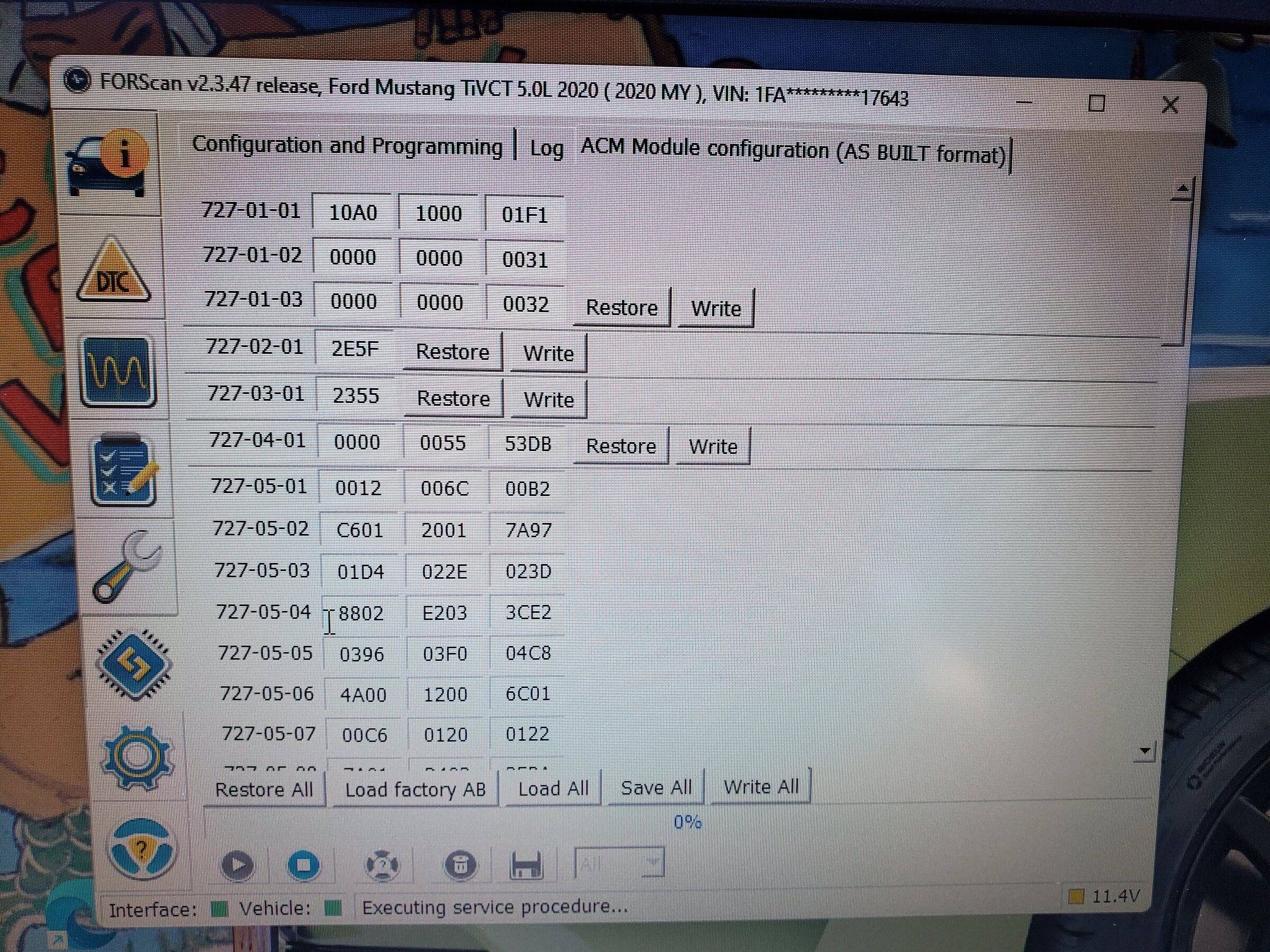

Fyi, the B&O has no bass roll off, the EQ is flat from the ACM.
Processing is done at the amp.
All zeros right out of the box.
So same as with the Shaker system and another reason to grab the signal right after the ACM and not after the amplifier/at speakers.
