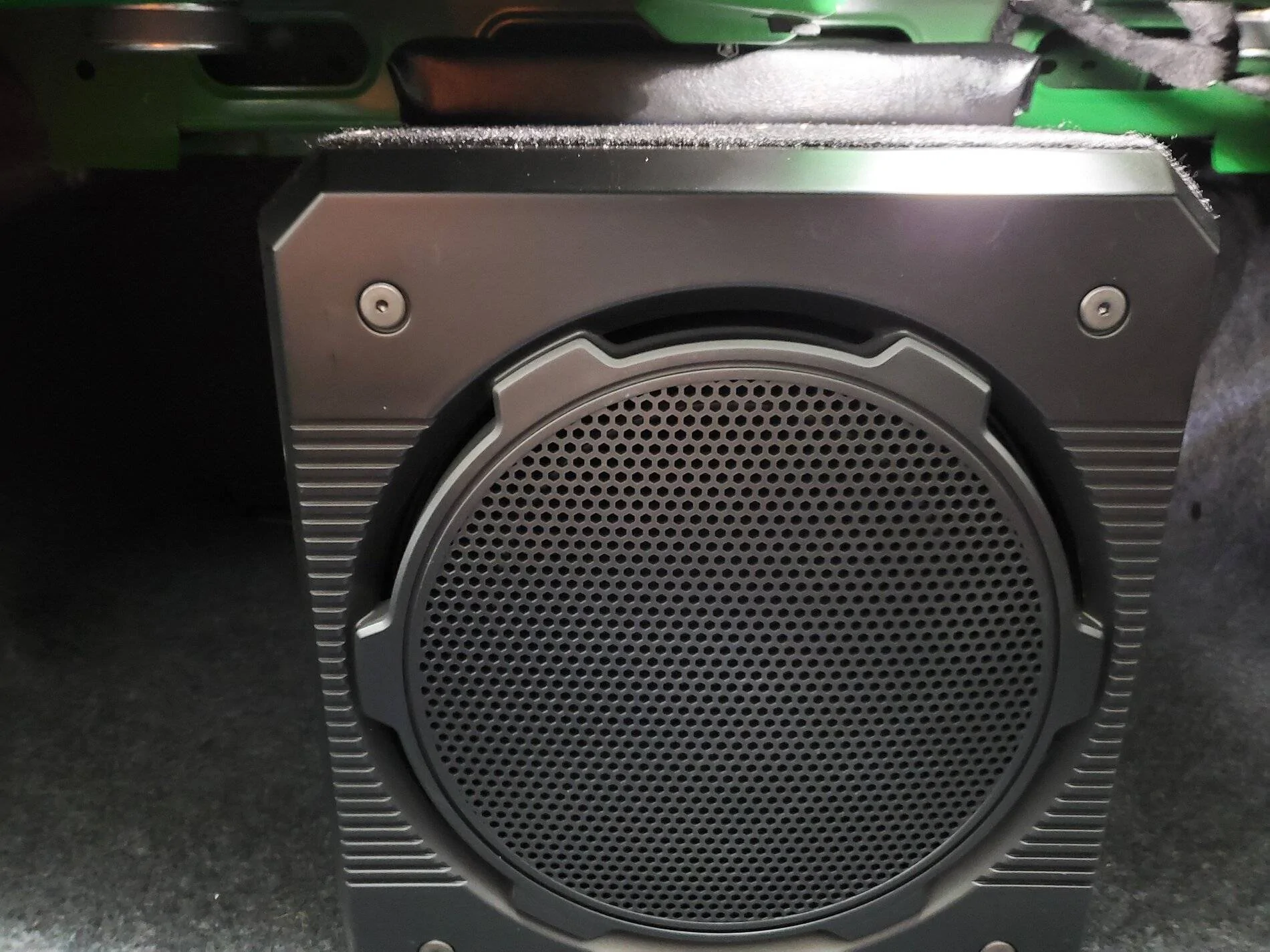

You can swap out the sub and add an aftermarket amp to power it. Lots of write-ups
on this forum. Check under the subforum.
