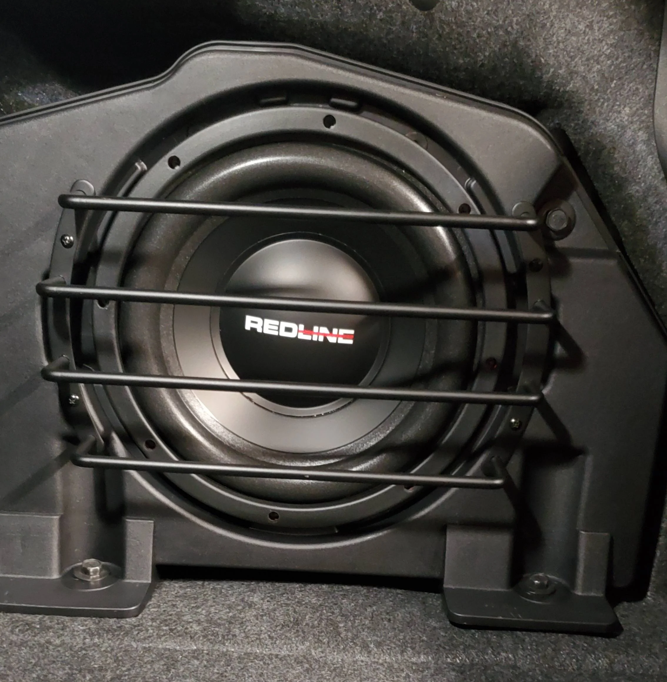

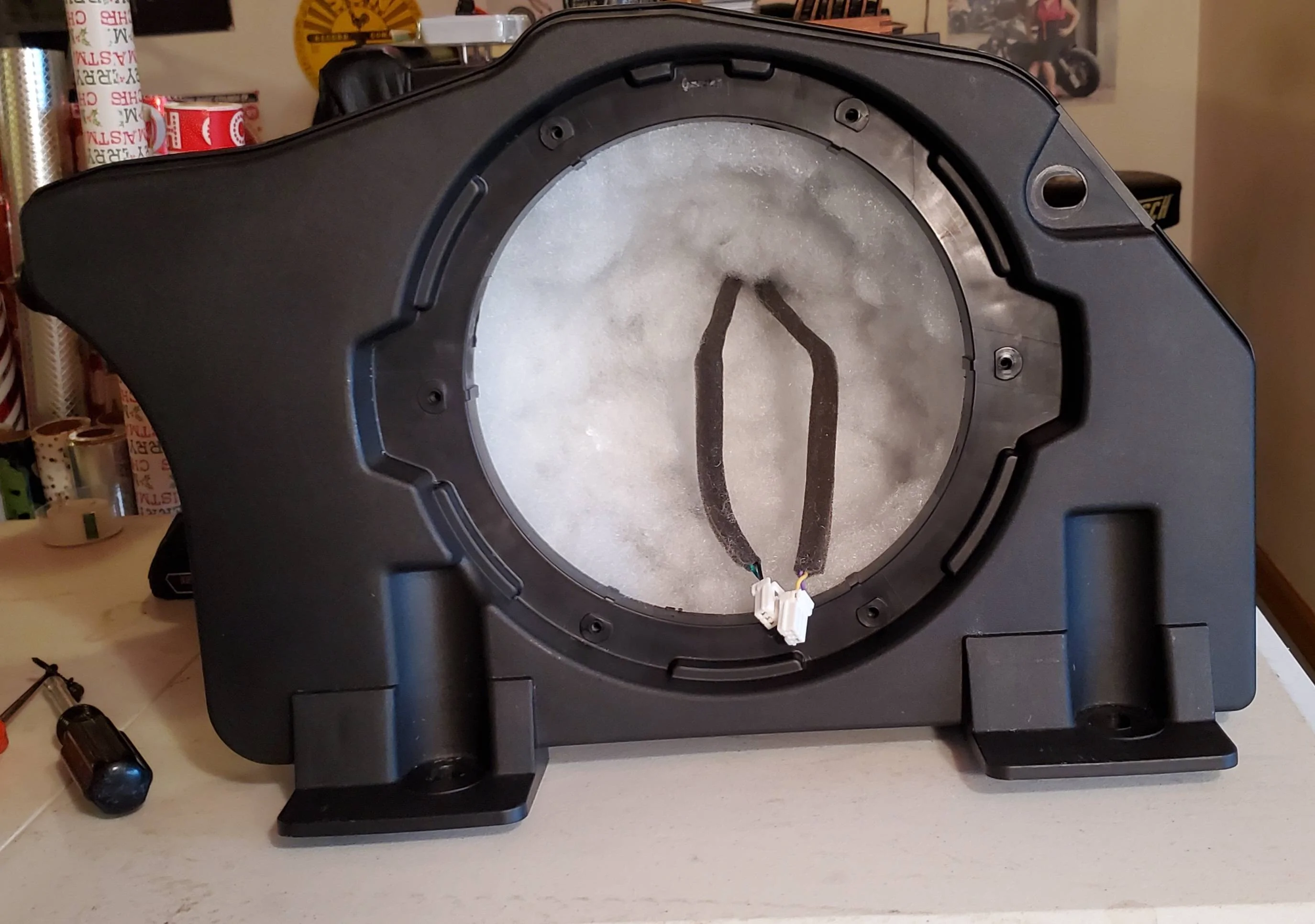

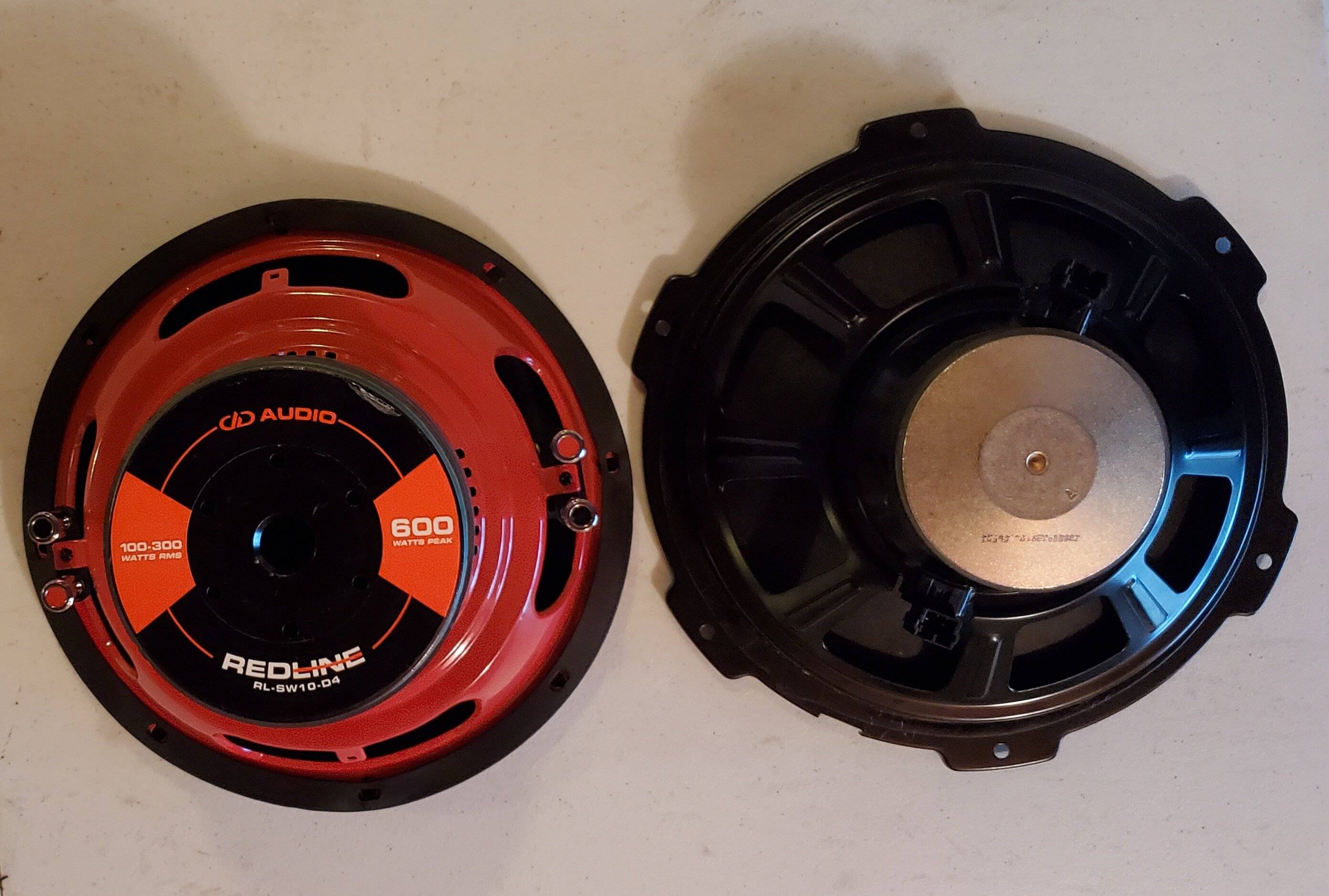

Well I started the process and was able to save 1 of the trim ring clips. 😂
I am reviewing the subwoofer replacement options and the only place I can find the DD Audio SW10-D4 is on Amazon by WoofersEtc. DD Audio has it listed as discontinued. Is there a newer model? I checked reviews for WoofersEtc to see if the company is legit and it appears they are. Anyone have experience purchasing from them?
If I am not able to go with DD Audio, is there any on the list below people have went with and are happy? I am also on the fence of just going with the Pioneer A-Series TS-A250D4.
Polk DB1042DVC 85db
Polk MM1042DVC 86db
Alpine S2-W10D4 84.5db
Appreciate the help.
I'd continue to search for the DD Redline 200 series Specifically 210D D4 if running the stock box and amp. You won't be disappointed. They are around just have to look. I'd add 3-4oz of polyfill as well. Most of there newer models are designed for more power. I have been putting together systems for the past 30 years and I am absolutely impressed with this driver considering the crappy OEM box and amp output not to mention the ridic OEM DSP settings. I did try the Orion XTR in the Skar 1.0cuft box which sounded almost as good, less accuracy and geared a bit more for low output but you have to remove the bracket that holds the OEM box in place which saves you 6lbs . Keep searching , I just checked Woofersetc and that DD Audio 10" isnt the one I am using , look for the 210D D4

Interested on how that one will sound in the oem box , I just looked it up and I didn't find any specs on it minus power handling and its suggested for a ported box. Keep us posted on your findings

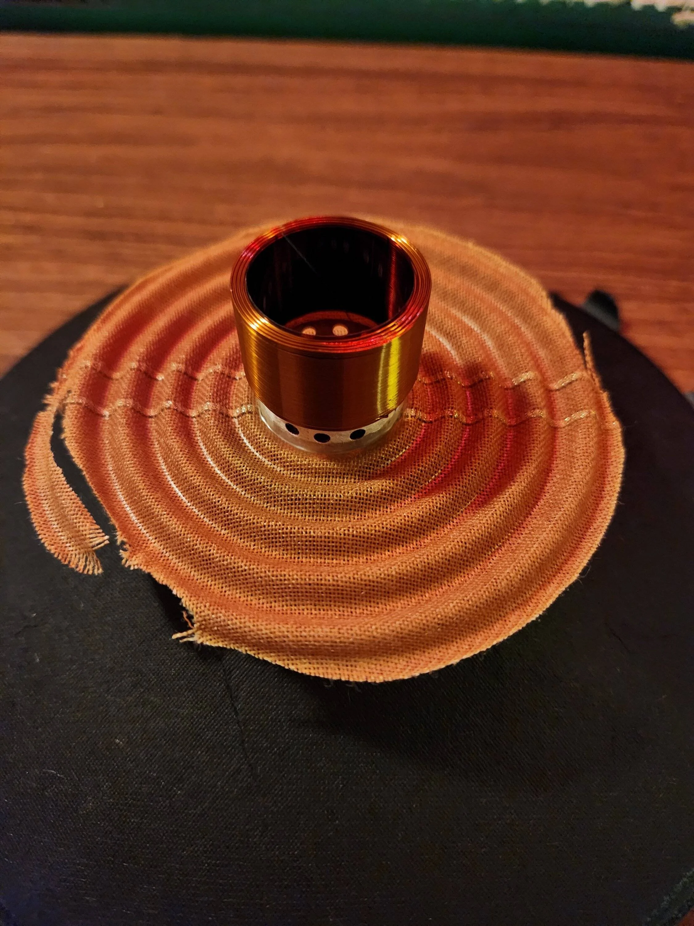

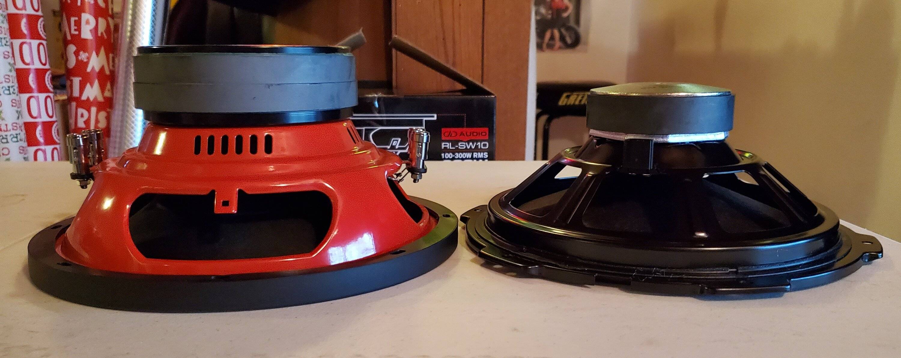

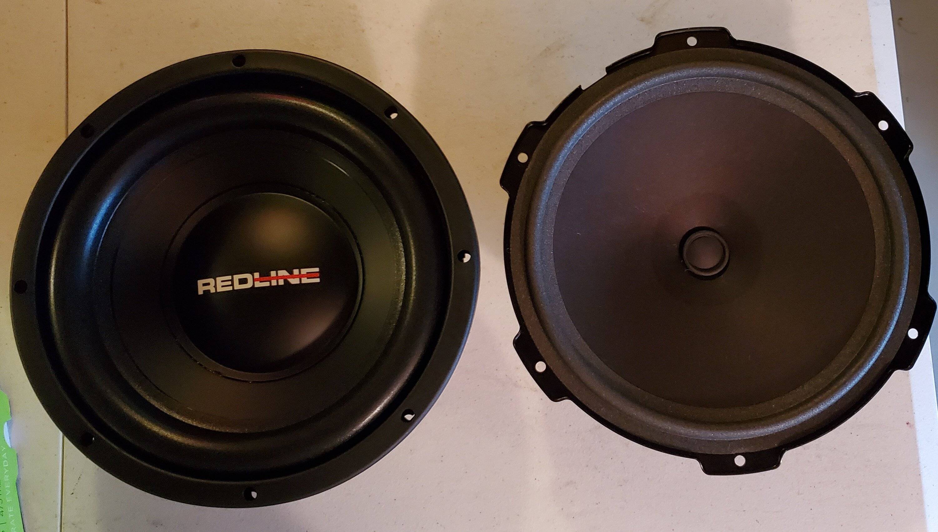

Puny little 1" VC on the stocker. It is nice and stout though, with a decent little chunk of copper. Real surprised it was vented. I confirmed 3.8 ohm per side. Mine didn't have the weather stripping on the box, rather RTV applied to the "sub" itself. Took some prying with the trim removal tool.
I received a non-A revision, but they said the only difference is in the dust cap. 55 oz. double stack magnet. I was surprised to see the Pioneer sub was also 56 oz.
I was afraid the stock amp wouldn't be able to push it, but that seems to not be an issue at all. Perfect match. Much more output, actually feels like it has a sub now. Wifey is happy. Used about 10 oz. of polyfill. The trim ring / gasket fits perfectly inside the raised plastic bumps. The enclosure actually has some mass to it now. Feels about 3x heavier. I used 1 5/8" prime guard drywall screws. Rotated the sub a little clockwise to better avoid the stock screw holes, which I was happy to find that they are all blind and don't require sealing.
It sucks they discontinued this model, but it was imported, so good riddance? :) I ended up doing sub installs in both of our trucks this summer and decided after 25 years to make a switch from DD. They kept pushing me toward their imported line for less than, I think, 2,000-2,500w RMS, vs. offering to alter the spider pack, etc. like they would have in the past.

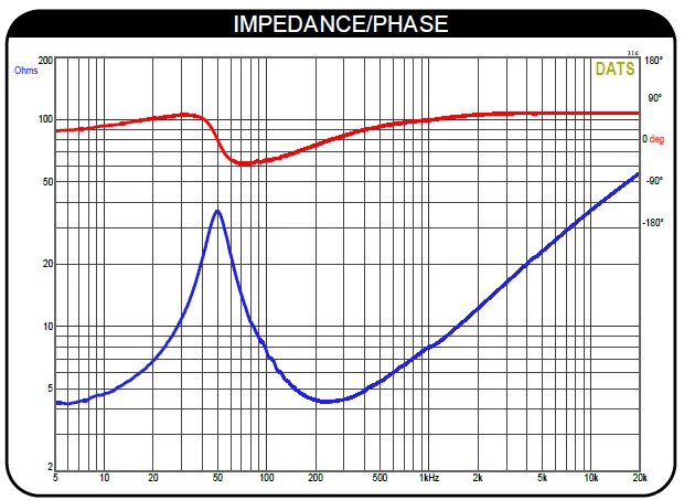

I have the B&O 12 speaker system. So the A pillar tweeter is in parallel with the door woofer, but the tweeter uses a cross over capacitor so no problem with the impedance. The door 3.5" speaker is on it's own channel so again no issue. I'm not sure of the impedance values of the 9 speaker system. There is so much contradictory information on it. All I know for sure is what I pulled out of my car, they were all 4 ohm. Don't get too hung up on it. A speaker's impedance varies with frequency. Look below at the blue line, this speaker is only 4 ohms a 2 frequencies and 1 of which( 5 - 7hz ) it will never see.
Now in the graph below you'll see the benefit of me choosing the Air Motion Transformer, ruler flat impedance with no phase shift.
If you want balanced sound then you need to match the dB ratings.
Say for this argument 90dB @ 2.83V/1M. The way that is called out, is the speaker will reach a 90dB sound pressure level with the amplifier providing 2.83V at a distance of 1 meter. It does not reference speaker impedance directly. This way it levels the playing field between 8 and 4 ohm speakers. Now, even though the amplifier is producing the drive voltage of 2.83V, the amount of current needed is twice as much for the 4 ohm than the 8 ohm speaker. Translation, the 4 ohm speaker requires twice the amount of watts but plays at the same level as the 8 ohm speaker.
