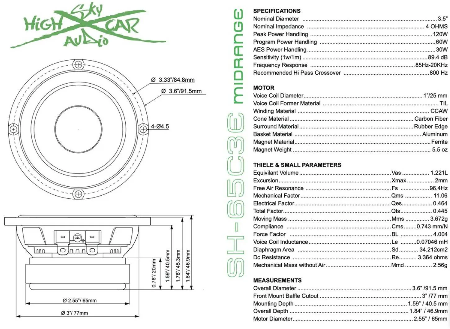

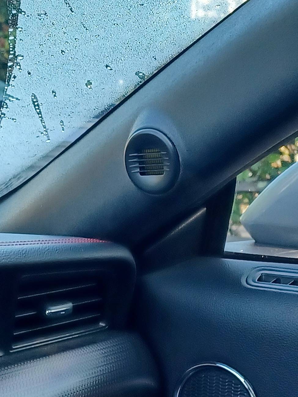

Update 7/21/25
Well I finally got around to swapping out the tweeters and midranges with the parts I purchased last year. Funny how life can set you back with some medical problems. All good now.
Let me just say, you don't know what's missing until you hear what was missing. As far as speakers go, I chose air motion tweeters, Dayton AMTPOD-4 from parts express and Sky High Audio SH-35 midranges. The AMTPOD-4 can be installed into the A-pillar by separating the pod mount from the tweeter carefully it's only pressed in and not glued. You can separate the Tweeter from the pod housing using a painters tool's curved section. It is the perfect size to wedge into the seam and wiggle the tweeter out from the housing without marring up the face. I got some used A-pillars from eBay and modified the them slightly to make the AMTPOD-4 fit right in. So now I can just swap out A-pillars and keep the originals pristine should I go back to stock. Did the same with the door 3.5" speakers, got some factory ones off eBay cheap, just so I can reuse the mounting bracket and mounted the Sky Highs to them. I reused all factory connectors salvaged from the used speakers. Tip; don't heat the terminals too long with a soldering iron. They will distort and you'll need to straighten them out. The plastic is very soft.
The tweeters sound amazing, nice and bright. You can now hear the cymbals so clearly. I actually turned the highs down. If you look at the datasheet for the tweeter you'll see a nice flat impedance curve, what curve! it's ruler flat! As for the midrange, the B&O speaker was ok and acceptable for the most part, but the SH-35 blows it out of the water. The carbon fiber cone provides a nice crisp, fast attack of snare drums. And voices are nice and clear without being honky, no muddy midrange anymore. I crossed over the midrange at 850hz and I think that helps a lot. As for the tweeter, I crossed it over at 4khz.
I added sonic barrier mat to the doors, but I think it will take a lot of material to dampen them more. Not willing to add all that weight to the door. It's improved enough for the stock B&O woofers. Now the real surprise was the B&O 6.5" door woofers. They are paper with foam surround with somewhat of a decent size magnet. I didn't change them out. For now it sounds just fine, but paper in the door won't last too long and the foam surround will rot out eventually. Don't know why they didn't go with polypropylene like the B&O 3.5" speaker. Also I sonic barrier mated the rear deck speakers. When right over them from the bottom to act as a crude baffle to block off the subwoofer from using them as passive radiators. Since those speakers are still active they would be muddied up by the interaction.
To say it's high end now, I would say it's close. Are there more improvements to be had, of course, but are they worth it? At this point using the stock amps and head unit, I don't think it can be made any better without spending big bucks. Overall I'm ecstatic, the sound improvement is 1000 fold. Don't forget I did the Redline subwoofer as mentioned in a previous post.

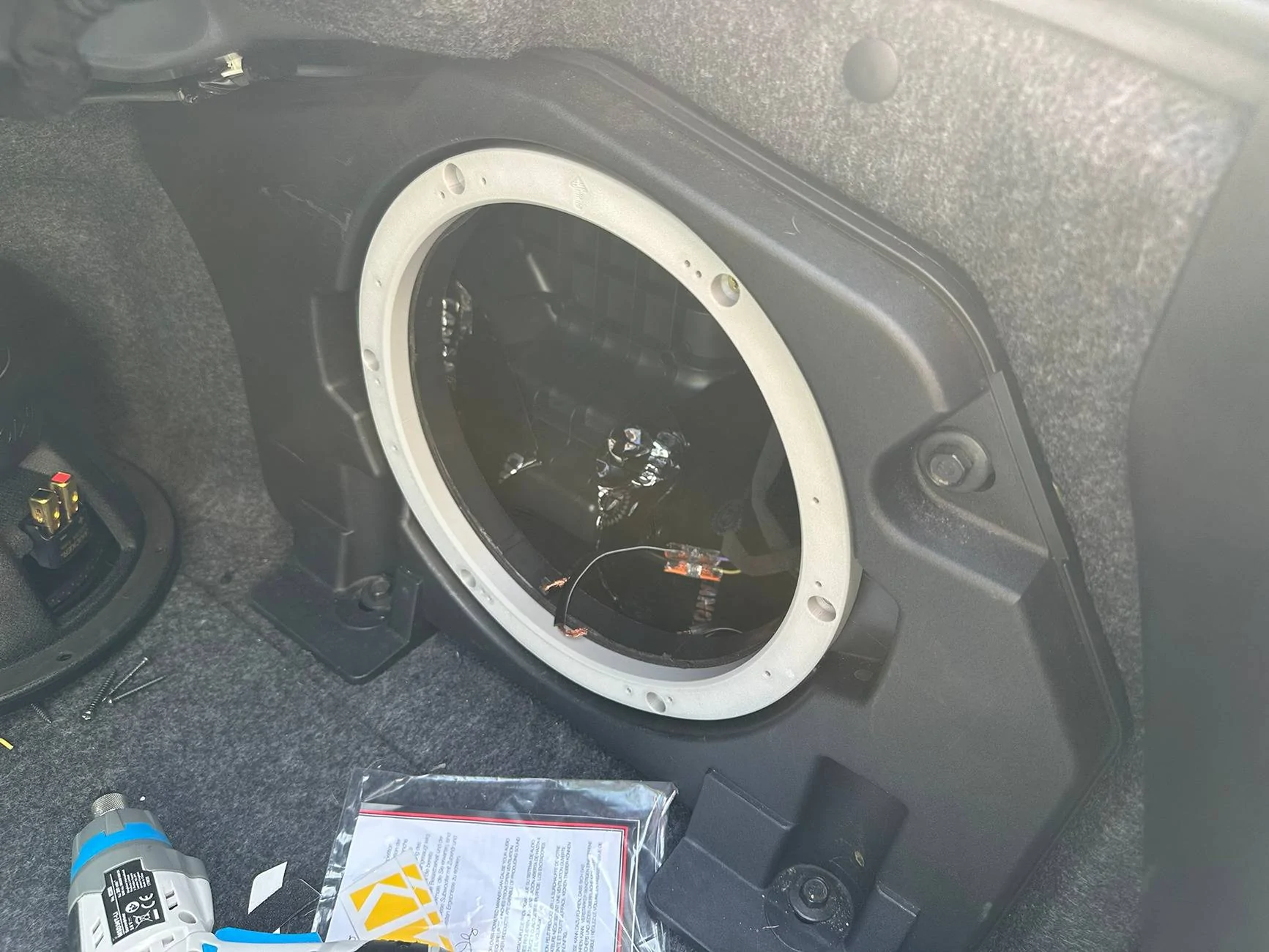

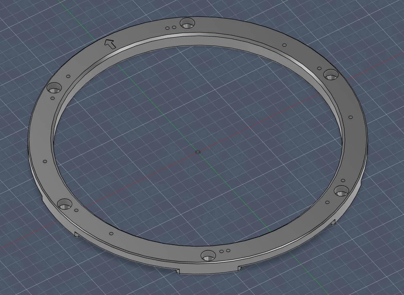

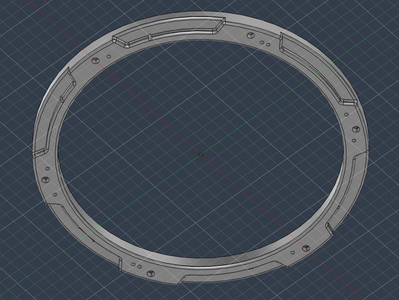

I decided that I didn't like the way the Pioneer sub mounted and wanted a cleaner installation with the option to take 8-hole subs too. So, I designed this. I'll stick it up on Makerworld or Printables later once I've got the dimentions dialled in.

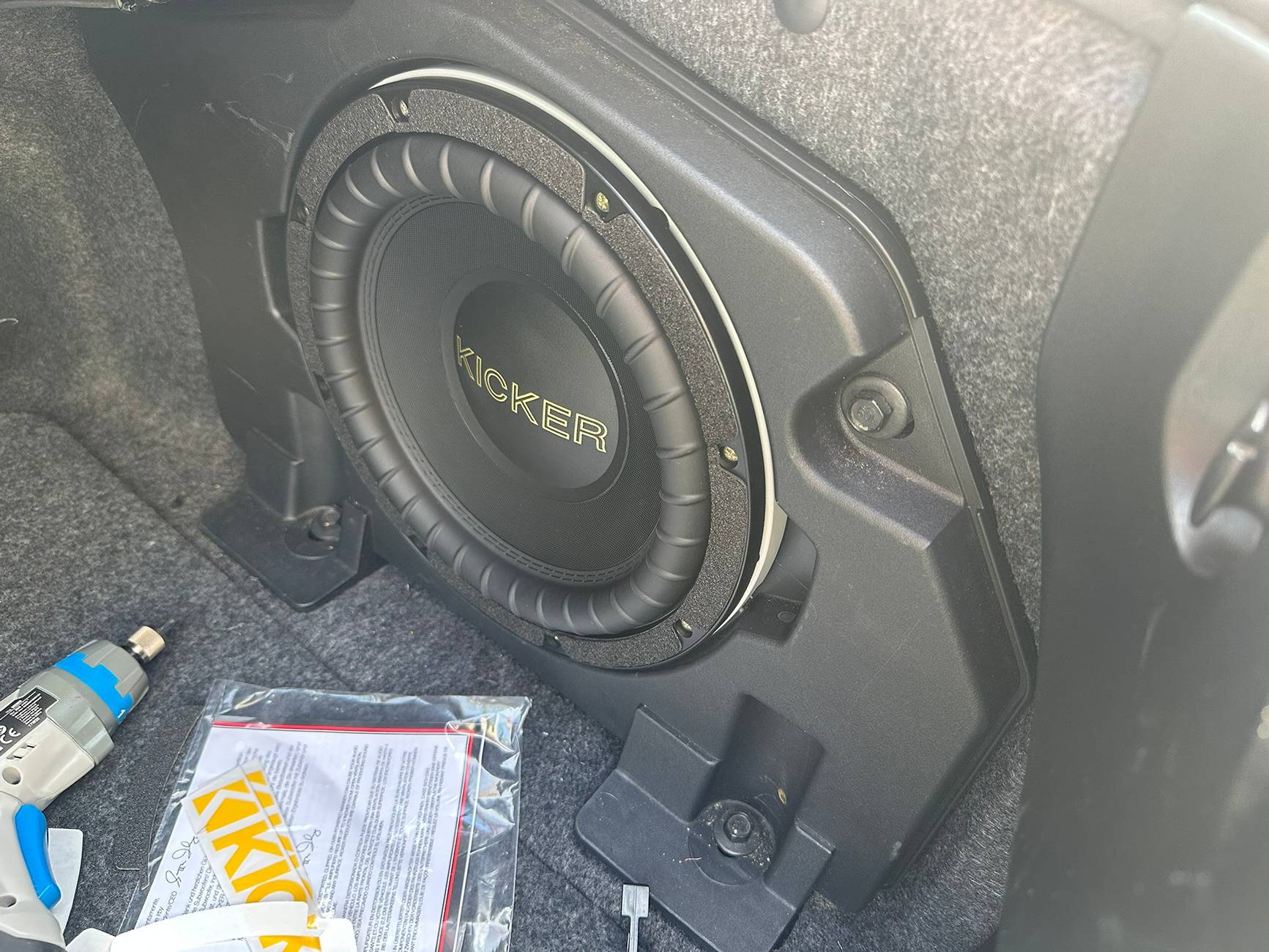

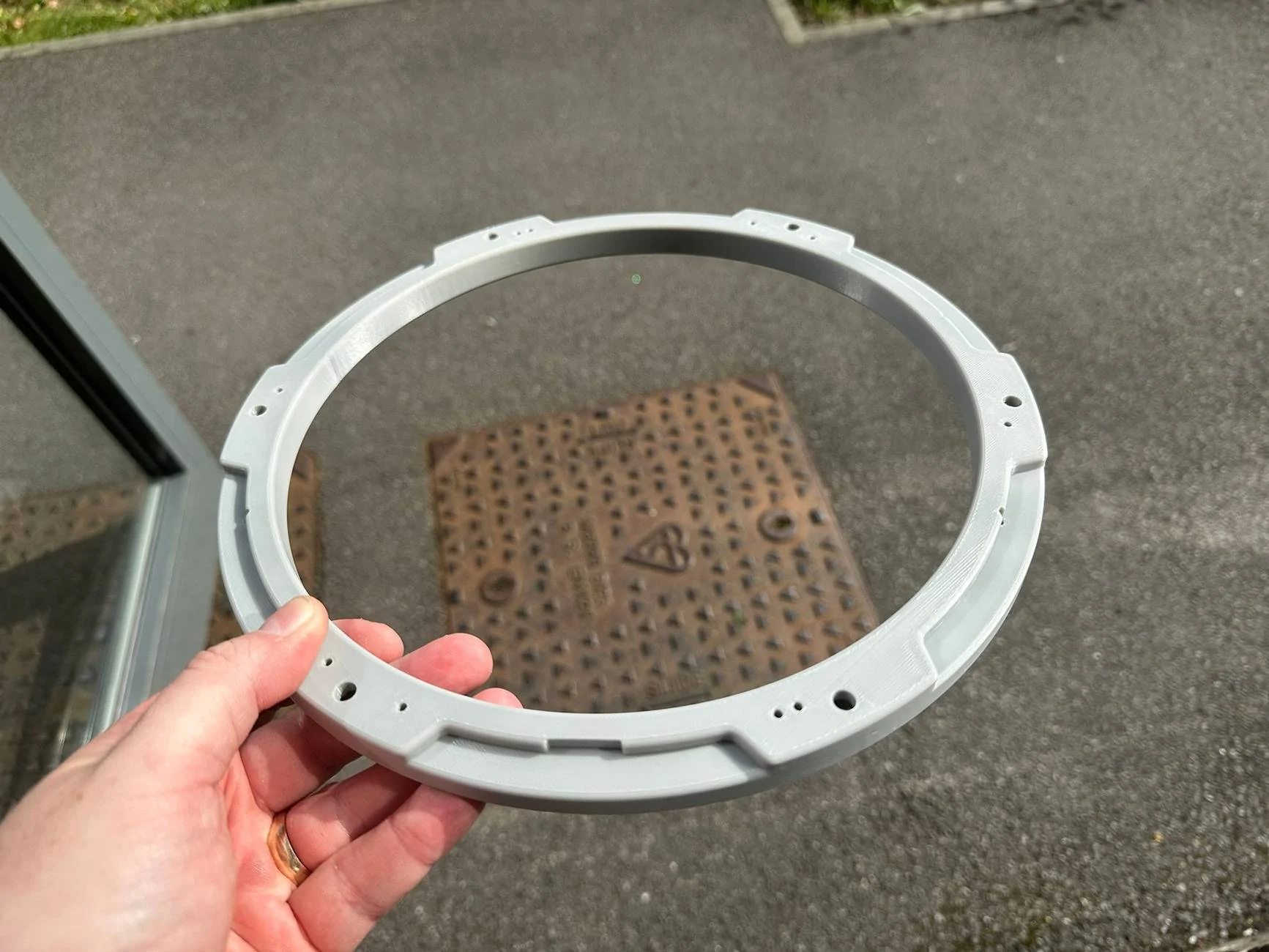

Reet. Works perfectly. I swapped the Pioneer out for a Kicker that is around 15dbw more sensitive. I liked the control with the Pioneer but it was too quiet for my liking.
Printed in ABS so it can survive the temperature inside the car.
You can grab the 3d model here: https://makerworld.com/en/models/1637974-mustang-s550-b-o-sub-adaptor-ring#profileId-1730467
Bear in mind though that you will need a printer that can do a minimum of 275x275mm on the build plate. I used a Bambu H2D.
