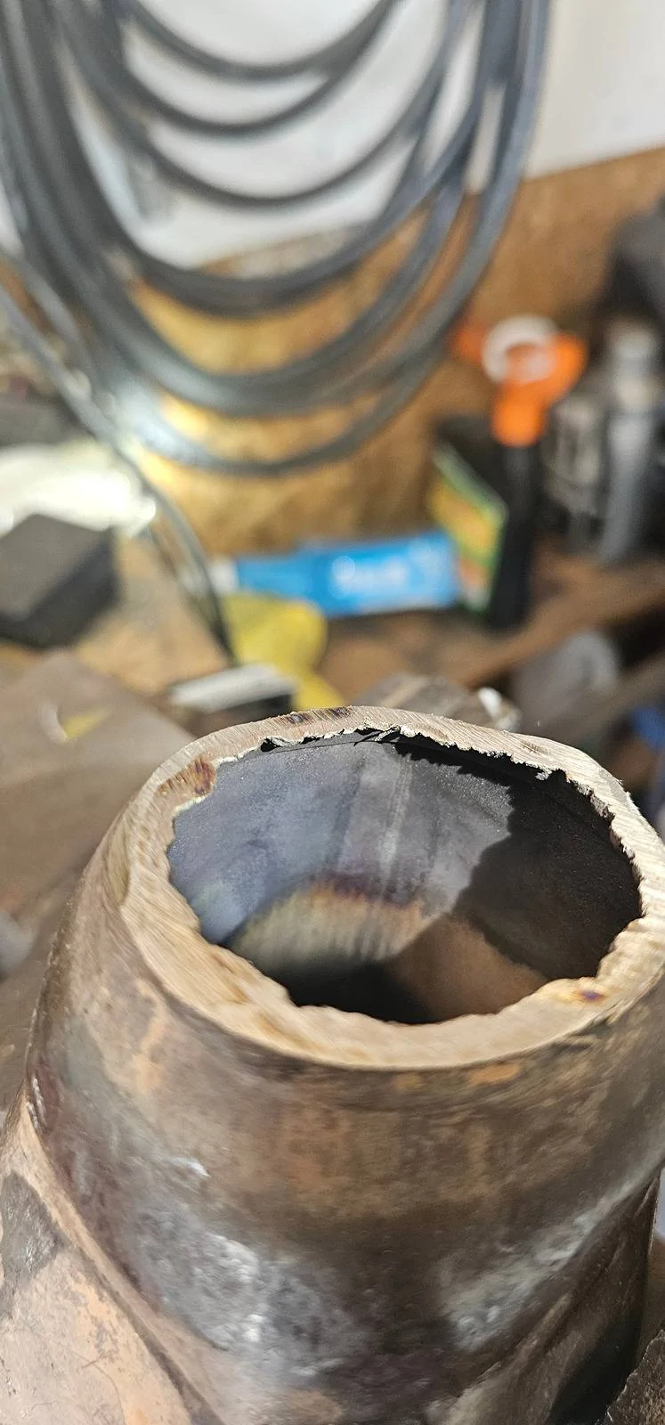

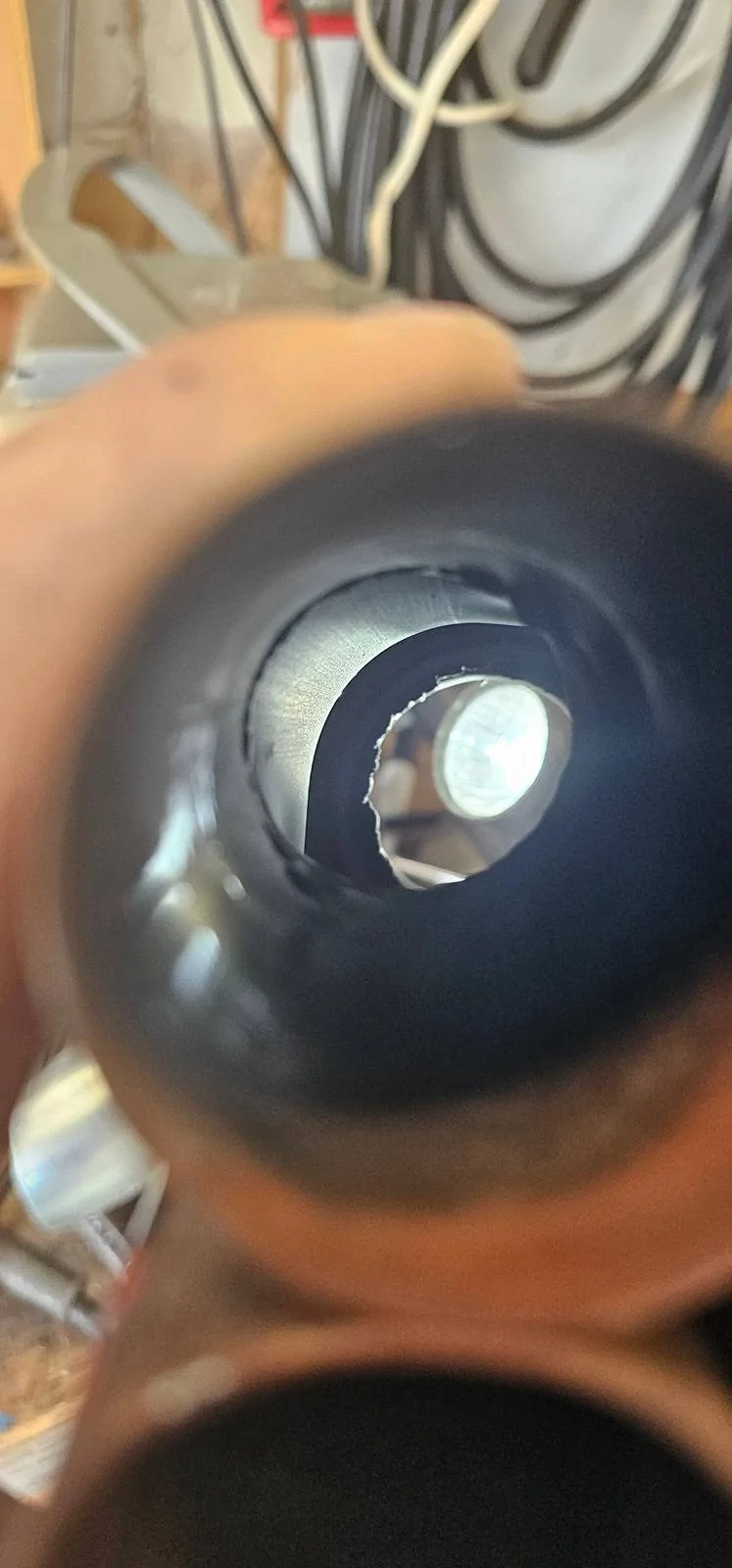

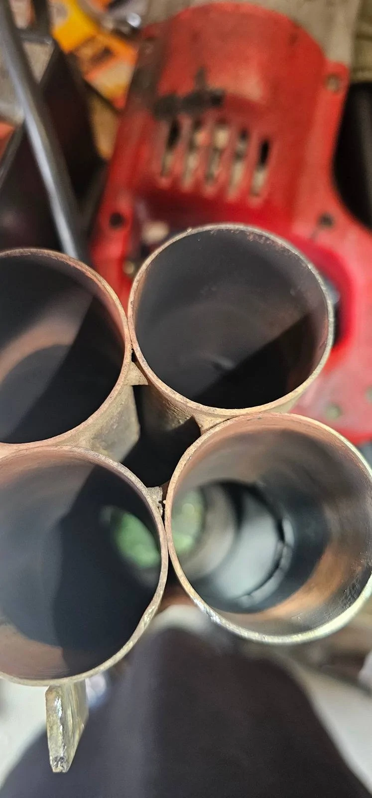

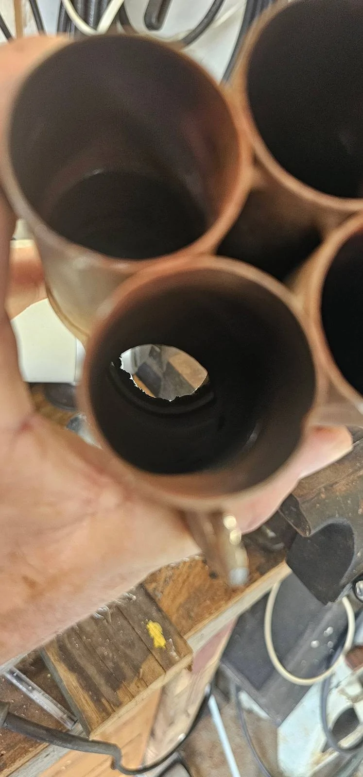

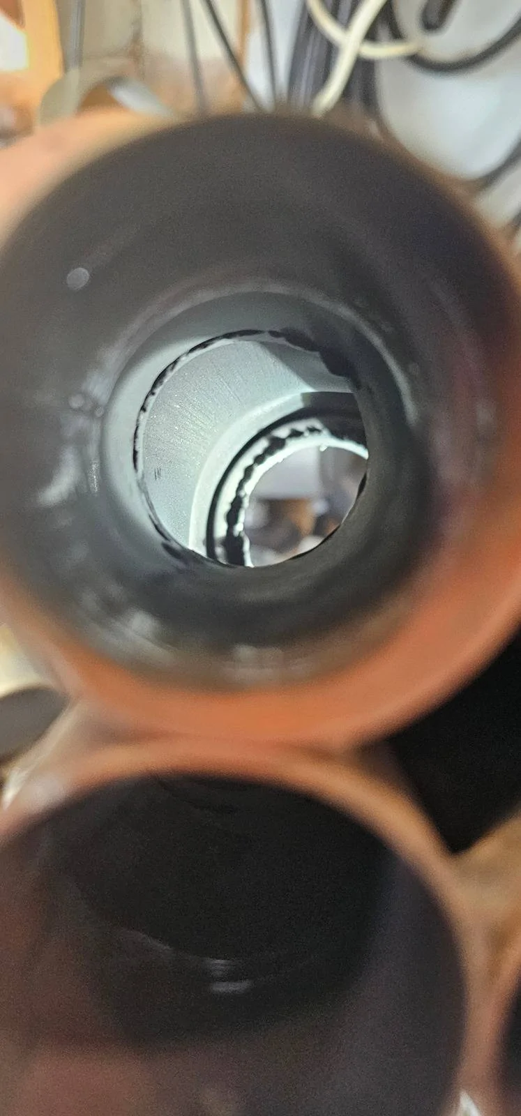

Even worse than I thought. Last pic is with the weld almost ground out.
88workcar
Dec 11, 2023
124
114
Pierre Part La
Jason
2020 GT wt Performance pkg
I port a ton of 4 wheeler heads. I always ask for the head pipe exactly for that reason, I will be checking my SPs

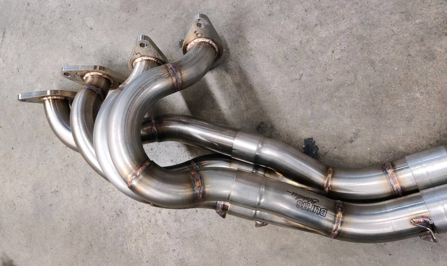

Header Porn
Calvin Elston Coyote Stepped 421’s, not for the S550. Probably a $3500.00+ price.
Yeeeeessssss. Stepped is The Shit, properly done.
