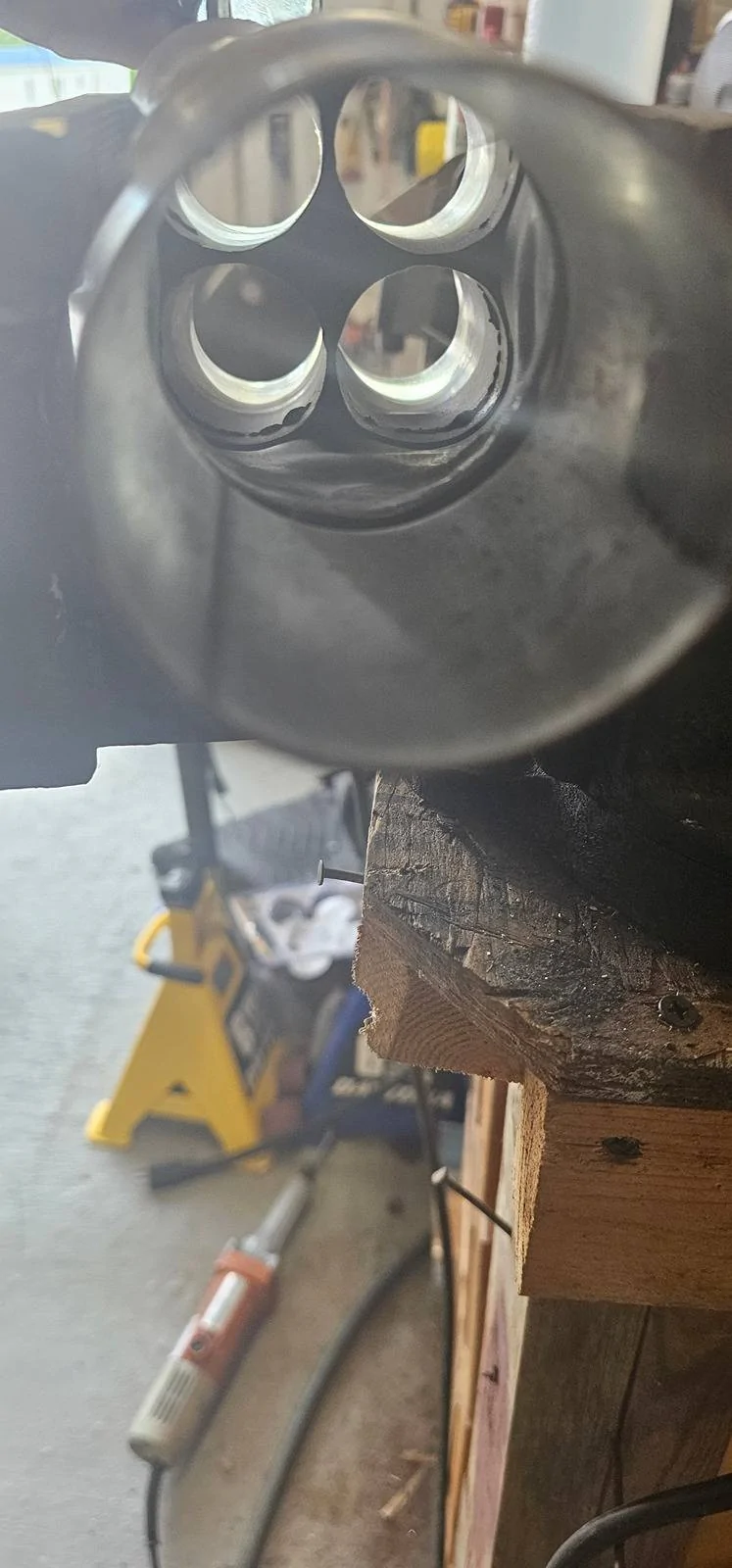

Got the collector finished, I'm old and on slow time LOL, anyway it works perfect. I can blow air through one tube and all tubes are sucking air.
I'll put up a photo when it is finished and looks good.

Did you determine that no cone in the collector would be necessary?
I don't have enough room to make a true venturi and it may be against the rules. I'm supposed to use a "supplied" collector.

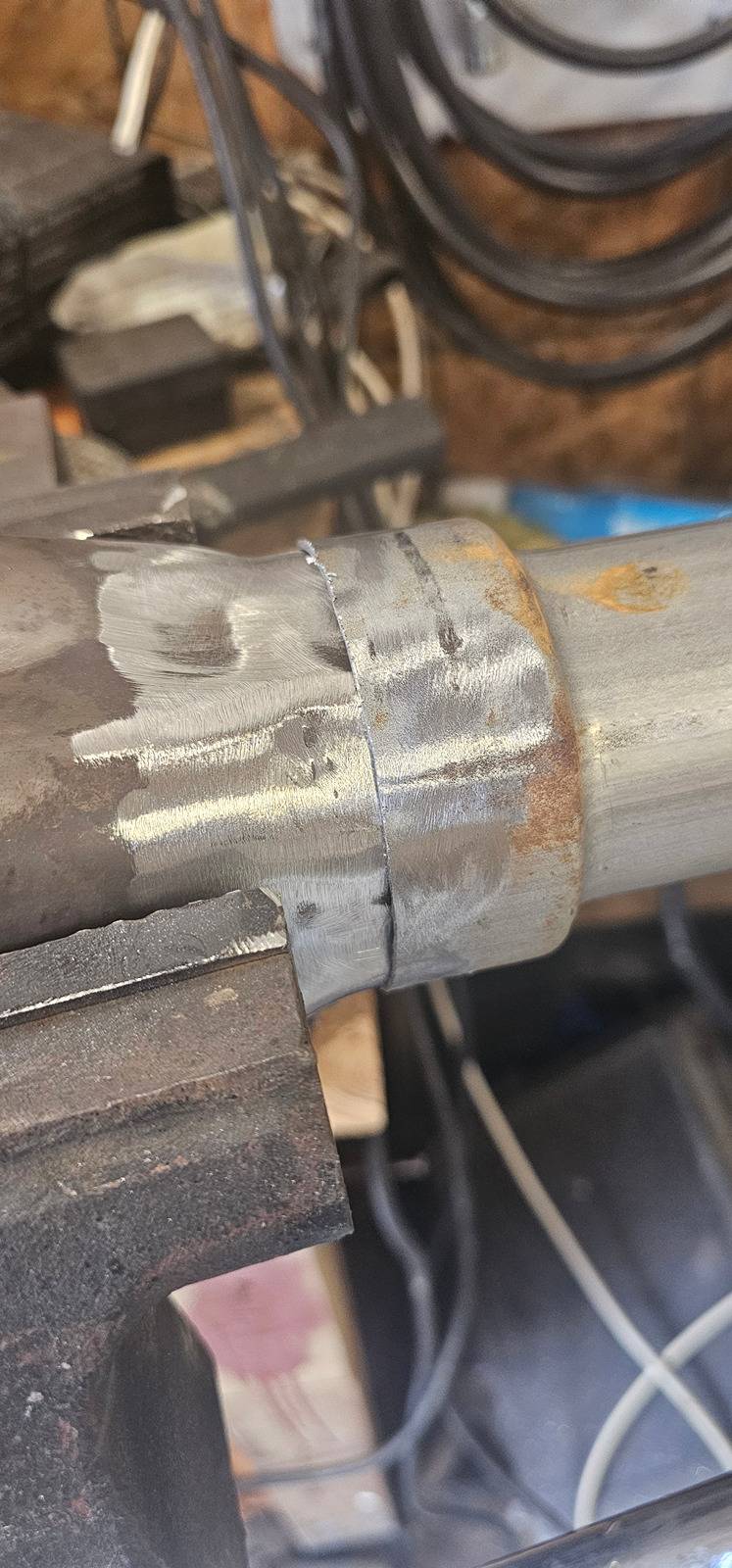

I ran a conical reducer from the too big 3 inch to a 2 inch. I'm not going for perfect just functional.
What I have learned is I cannot weld anymore. I can't see the puddle due to the arc. This is using a 13 glass.
Weld and grind, weld and grind until they look smooth and hit them with some high temp paint or wrap and you’ll be good.
