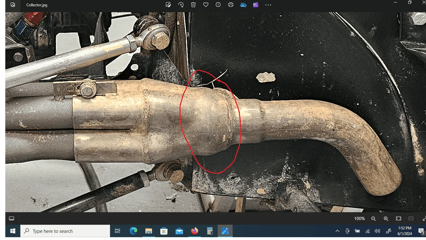

Aside from being ugly, the collector is reduced at the exit point.
And someone took an expander and expanded the collector itself. This is costing 20 HP. Is my guess.

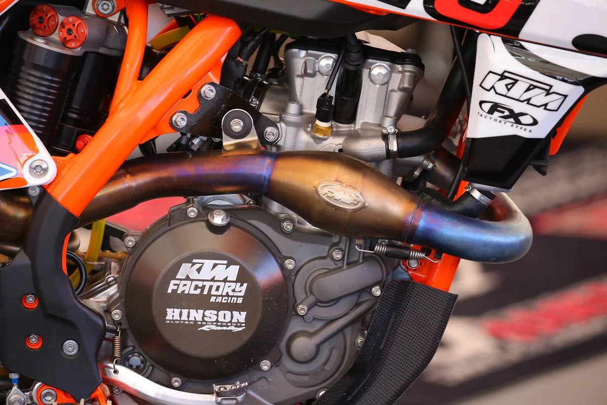

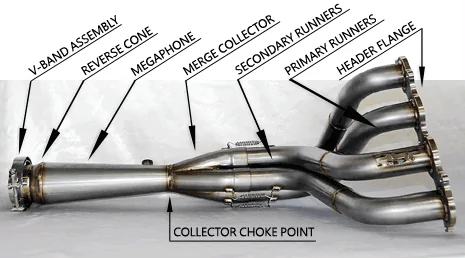

Here’s a text book example of a proper merge collector back layout.
That back section is getting mighty close to a Two Stroke expansion chamber….. Most newer 4 stroke dirt bikes have a similar feature located towards the backside exit radius of the head pipe.

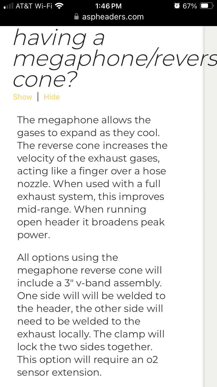

I wish I had room to copy this from the collector back.
Honestly, in my unprofessional opinion even if you shorten up the megaphone to fit your allowable space it’ll be better than a size on size collector turn down.
With that header you posted, a new merge with a properly sized choke and a shorty divergent & reverse cone you’ll be HP ahead.
