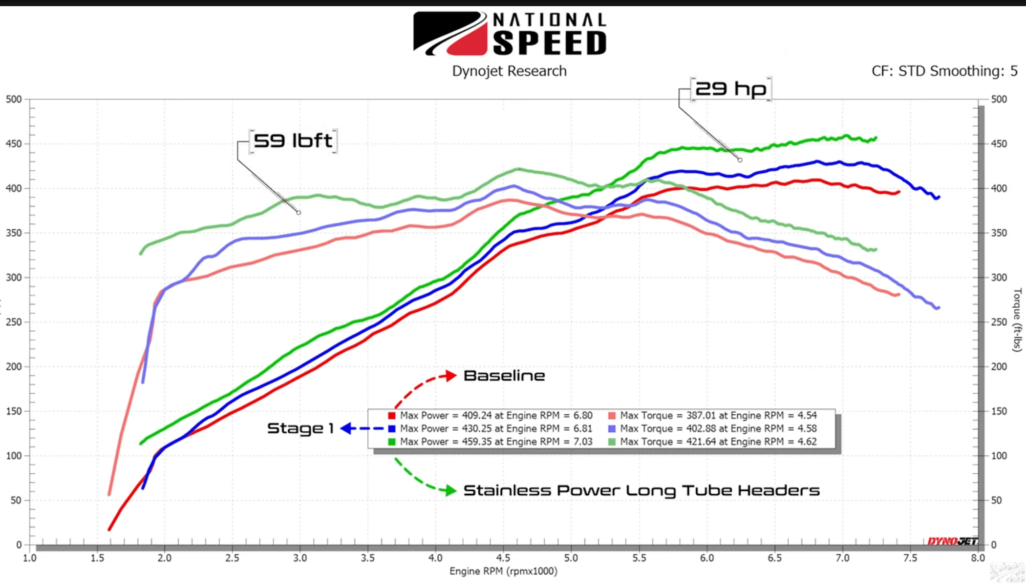

National Speed showed 29 peak hp adding Stainless Power longtubes with highflow cats to a intake/tune car
Decide for yourself if that is worth $1500 (and possibly installation costs). You'll of course make more power if you have more mods.

Of course they’re going to show favorable dyno results and use STD instead of sae, with no mention of time/humidity/temp etc.
I’m more interested in dyno runs made by individuals. Most I’ve seen is like 10-15 and that’s mostly just a shift in peak power, area under curve was a far smaller difference.
They are just showing the difference between every mod on the way to FBO. The actual numbers or weather conditions don't matter since it's all the same car done in the same time.
Why would you think there is just a shift in peak power? They are going to make power everywhere.
They have interest in showing favorable results. Nobody would want to pay thousands for headers if they showed a small gain. Header design shifts the power more than it creates imo.
And no, it definitely was not done in the same time. This matters:
So it's going to be different in this engine vs headers on every other engine? Are you going to say something like longtubes lose low end torque or another myth next?
Very similar to other dyno results from people that install headers. Picks up a couple tenths at the track which goes along with the gain.
Trouble is finding results where it's just a header change. Not intake/e85/tune/etc at the same time.
Also, if they were just trying to sell parts why would they have shown the ported intake and ported TB being next to useless?
