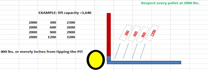

He said he's got 72'' forks on a 6000 lb capacity forklift. Make sure the forklift's ID plate shows it was built with 72'' forks. The plate should show actual capacity with a load center. The load center is exactly half the length of the original forks. For example, if the ID plate shows the weight capacity of 6000 lbs at a 24'' load center that means it came with 48'' forks. When you replace forks with longer ones that greatly reduces your lifting capacity.
Anthony 05 GT is spot on. The center starts from the base of the mast or Load Back Rest where the forks attach. Your lose 200lbs of lift capacity the 1st inch the load is centered off the LBR with the weight loose increasing exponential the further out from load center the car is placed on the forks.
