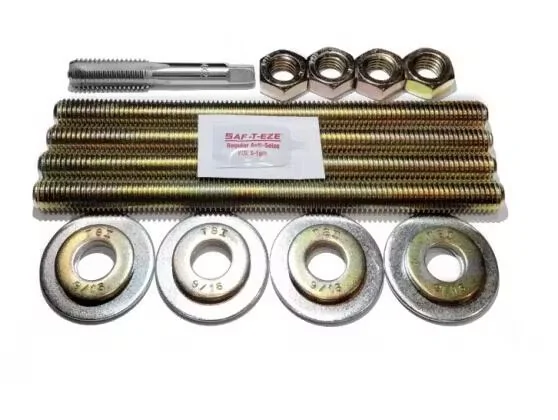

You only need the alignment kit if you install reinforcements on the subframe bushings. If you do install those, the bushings help keep things centered when you are bolting things up.
If your subframe to body interfaces are stock, you’ll find there are teeth marks where the subframe was bolted in, and you can usually get it back where it was without extra parts.

From my limited experience, the centering sleeves offer no functional benefit to the vehicle and they could even defeat the whole purpose of the "sloppy" factory tolerance range to properly locate the cradle-to-body positioning. My son's GT accepted all four spacers without changing the factory positioning of the cradle while my Mach 1 mounting tolerances were different enough where only two spacers could be utilized and still maintain the proper factory cradle alignment. The inserts can definitely aid in the installation of the cradle if your existing bolts are already centered enough to accept them but it's really not difficult to properly position the cradle without them. If you plan on dropping the cradle on a regular basis, you could also consider mounting studs to give more range in suspending the cradle and avoid cross-threading risks or other damage to the blind body nuts.
