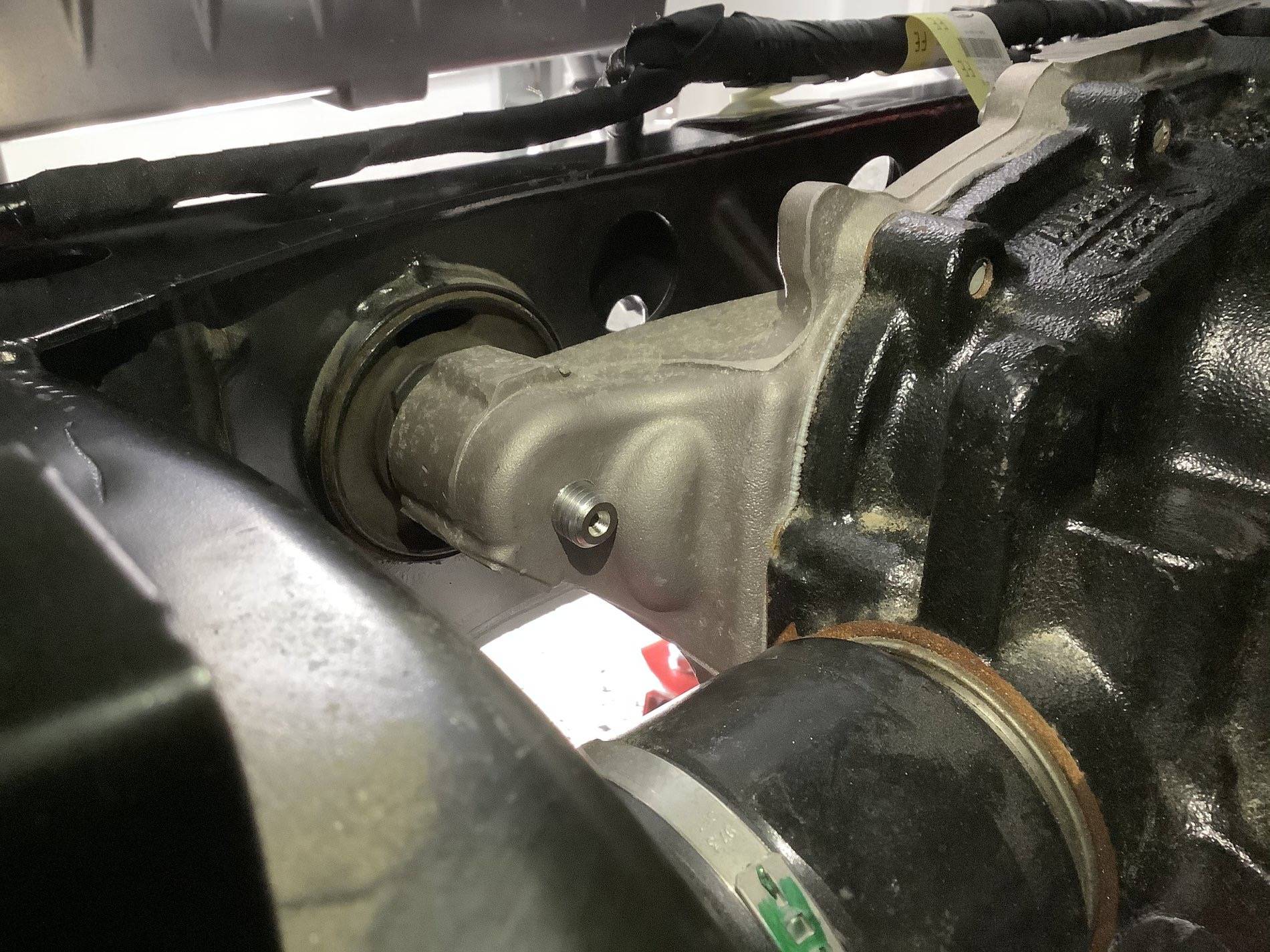

That’s money well spent. The only other thing I would suggest would be adding their through bolt kit with your differential bushing kit.
vdngo
Feb 17, 2022
63
33
Iowa
Van
2019 Ford Mustang GT Convertible
See how it goes all the way through here.
I’m intrigued now… looks like it makes sense if I’m going to do the other mods. Quick question, did you lubricate the threads, but the original bolt instructions say to use thread lock, seems to be contradictory.
