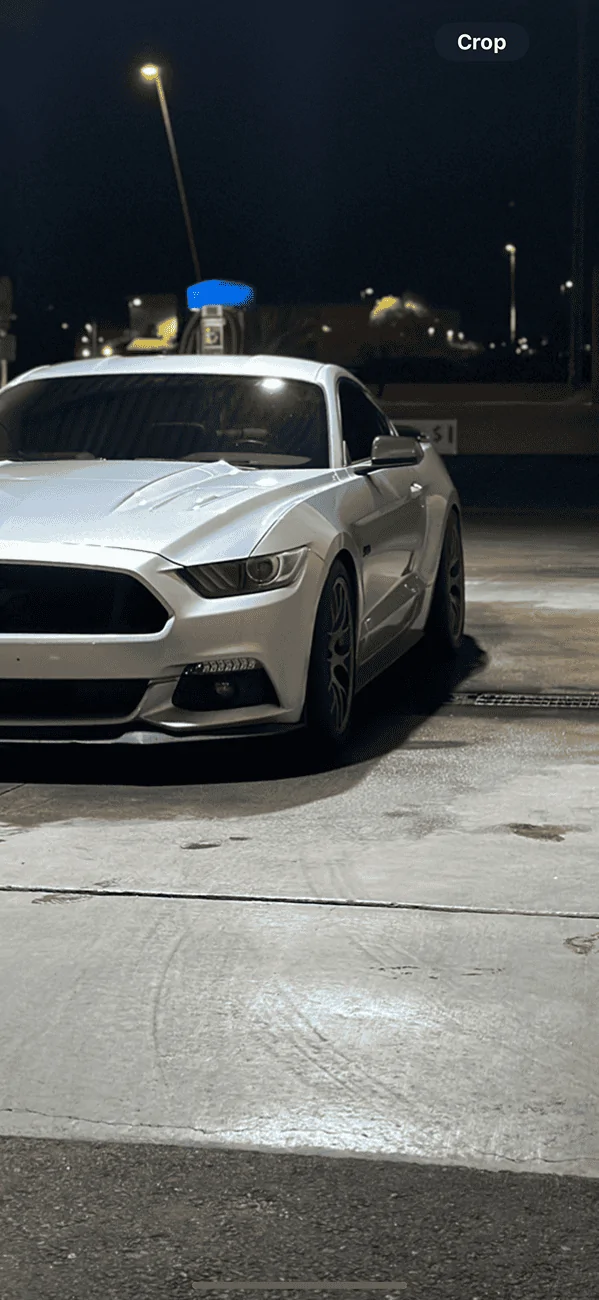

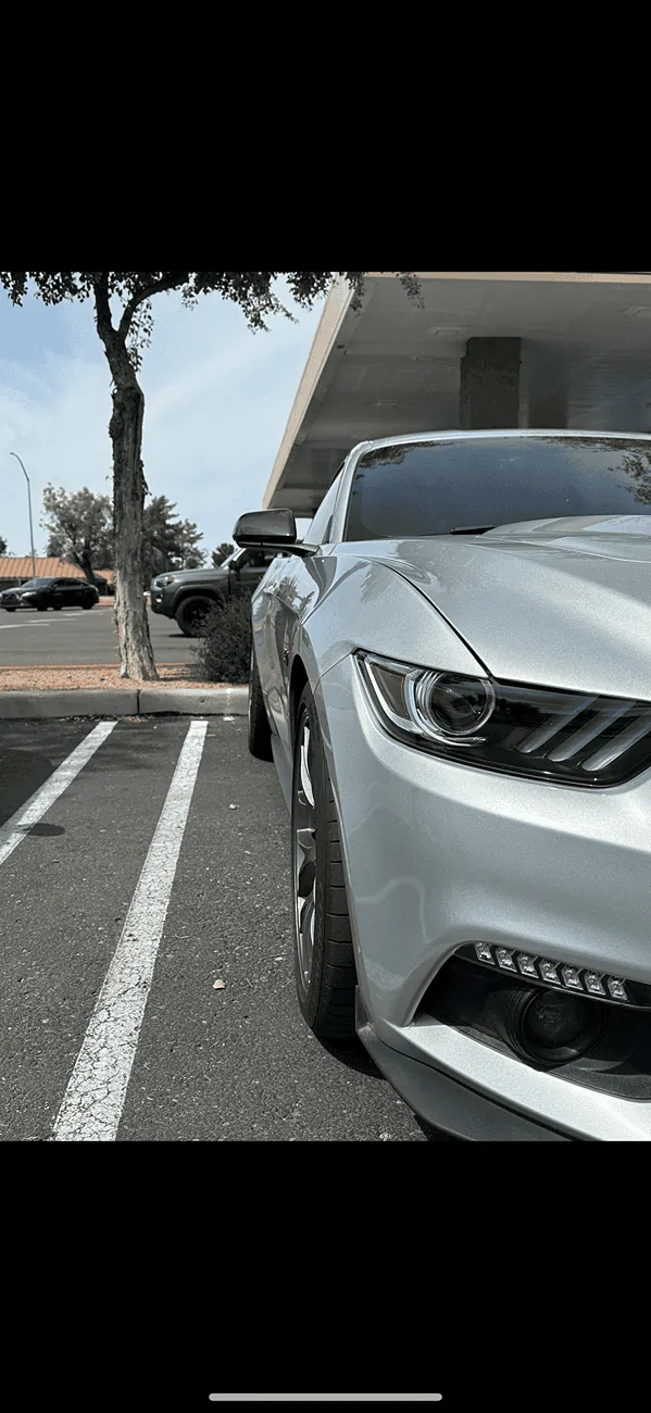

yes I know camber is adjusted with the upper arms, but the camber on the passenger side is more positive than the driver side so it seems that my subframe is not aligned properly. That’s what I was asking about.
the wheel on the passenger side is way more tucked in than the driver side even though it’s camber is technically more positive.x

I’m not talking about the camber, I’m talking about the wheel being tucked in further on the passenger side than the driver side.
the passenger side camber is more positive than the driver side yet it is tucked more.
im talking about the subframe being misaligned, hence why I’m referencing the wheels being more tucked in on one side. Yes I know the camber is adjusted with the camber arms, I’m talking about the subframe.
