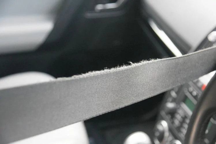

All it did was fray the very top layer of threads making the belt look fuzzy in the area that was around the CG-lock. Don't have the car anymore. But found a pic that may give a better idea. In the car 8 years 18-20k miles per year DD plus hundreds of autocrosses and wear was a little less than is in the pic.

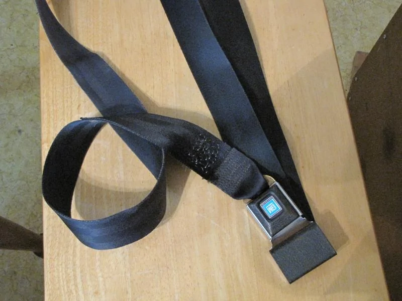

Wait...is this just a strap of webbing with a buckle? Looks like you wrap it around the seat joint where the back attaches to the seat cushion and it holds you in place independent of the seat belt. Is that correct?
If that's the case I have some leftover buckles and 2" nylon webbing from another project I was working on. However, I'd like to know specifically where this gets wrapped around? Also, seems like in an accident this is has a much higher probability of getting forced into sharp/metal and sheering off compared to a dedicated restraint harness.
Pretty much.
You'd wear it as supplemental to the OE 3-point belting, and basically consider it expendable without necessarily adding to the OE belt strength.
I "re-purposed" a couple of the belts out of the Chevy Malibu I used to own. One set for me, one for any right-seat occupant.
When you tighten it down over the OE belt it does tend to limit the OE belt's built-in tendency to go slack in addition to clamping you down better.
