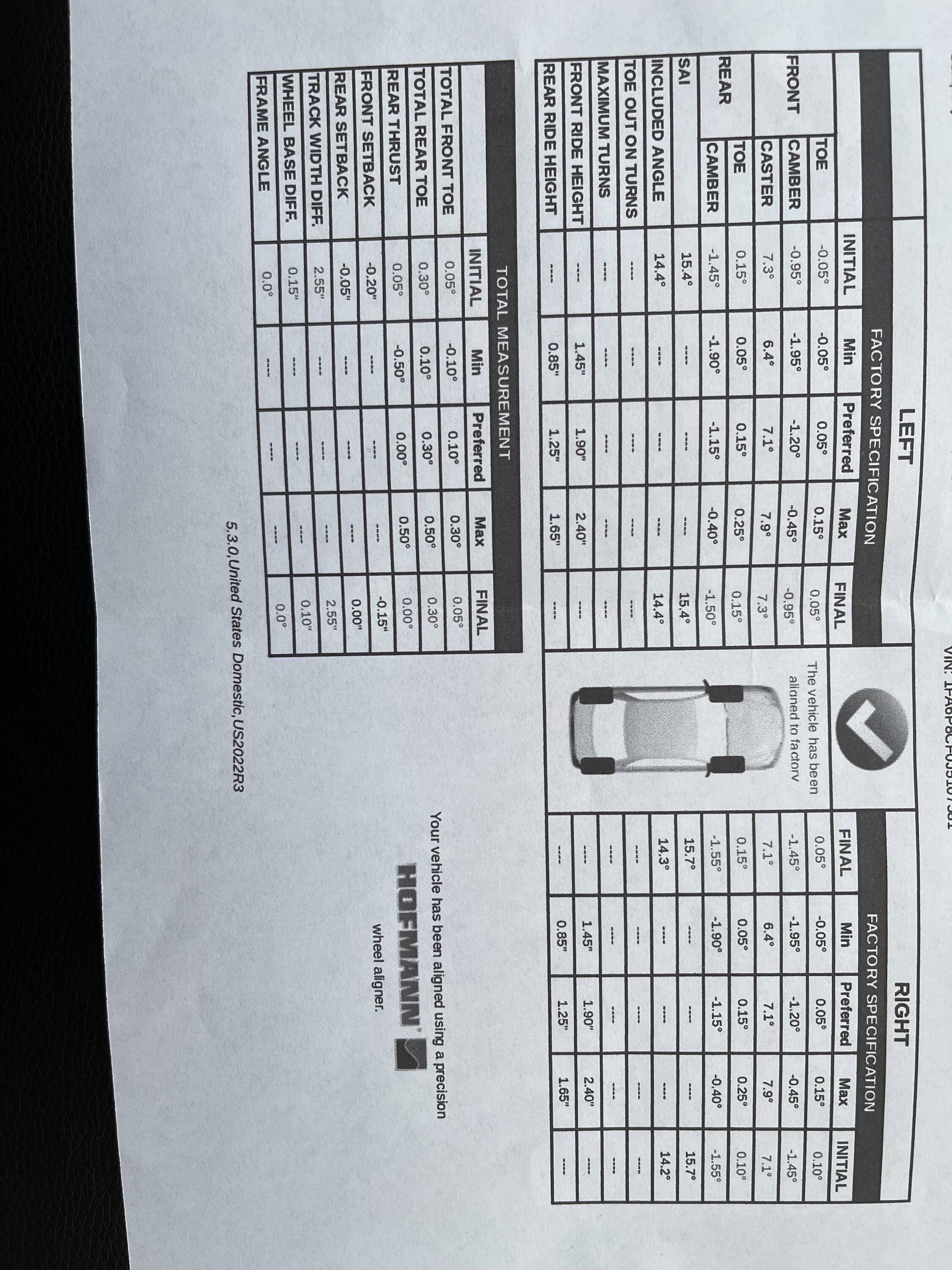

Took the car in for alignment and the shop made the alignment to match Ford specs:
see picture below. Only thing that stands out are the final Camber numbers for front left and front right. Is this within normal range?

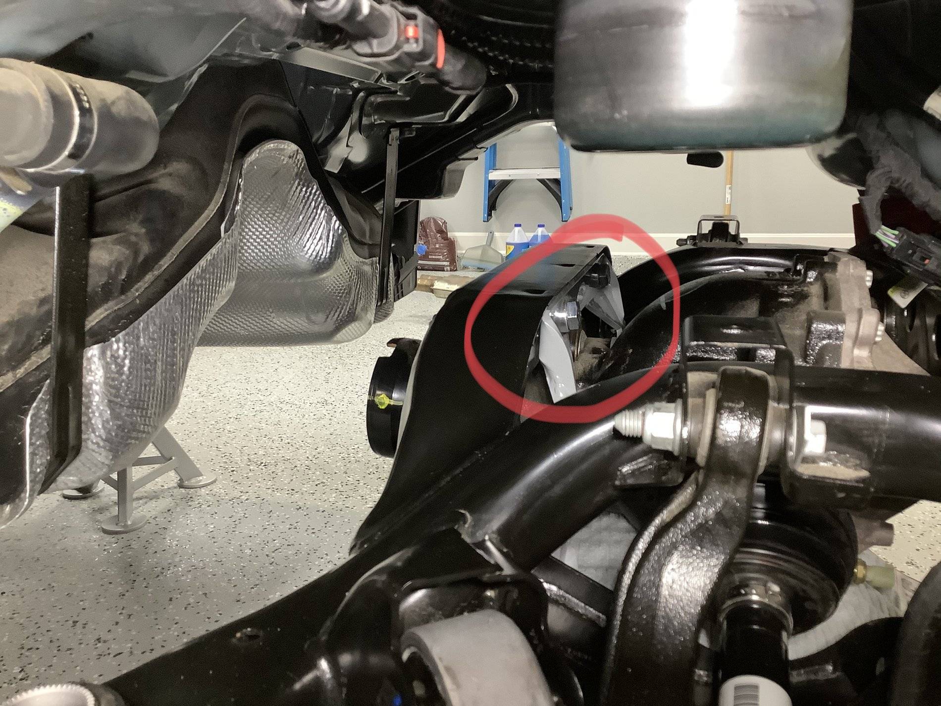

This is a 30 to 45 min. job. I'll be generous and say 1 hour + another hour for the alignment. Shop rates here are 100 per hour So 200 labor plus shop supplies.

It is easy to cross thread the big blue bolts. Also if your subframe is not centered from the factory you will need to loosen all the blue bolts.
Should I loosen them at the same time or one by one as I install the centering piece?
I would loosen one at a time. If you can't get a bolt started by hand, then loosen all of them. If this happens you will need a pry bar to center the subframe. It's easy to do just hard to type out LOL.

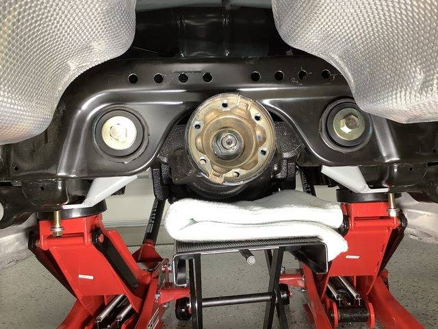

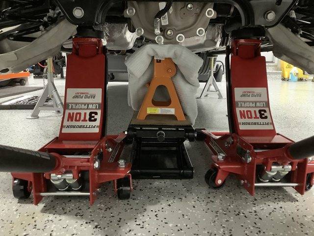

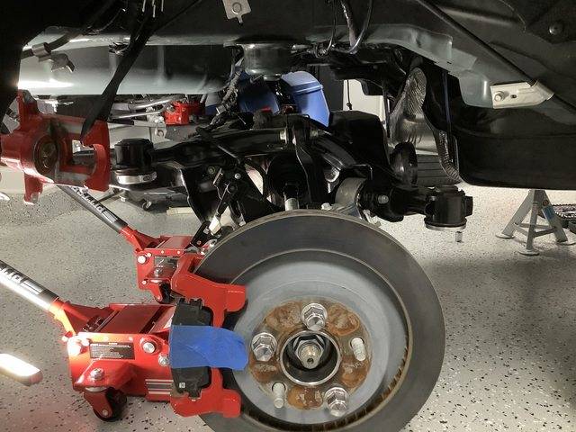

What I did mine, I removed the whole subframe because I was installing differential bushings and a differential bracket. I used two floor jacks and a scissor jack to balance the differential (raising and lowering the entire assembly slowly and evenly). If you decide to drop the entire subframe, I recommend installing as many parts as you can that require the subframe to be lowered.
