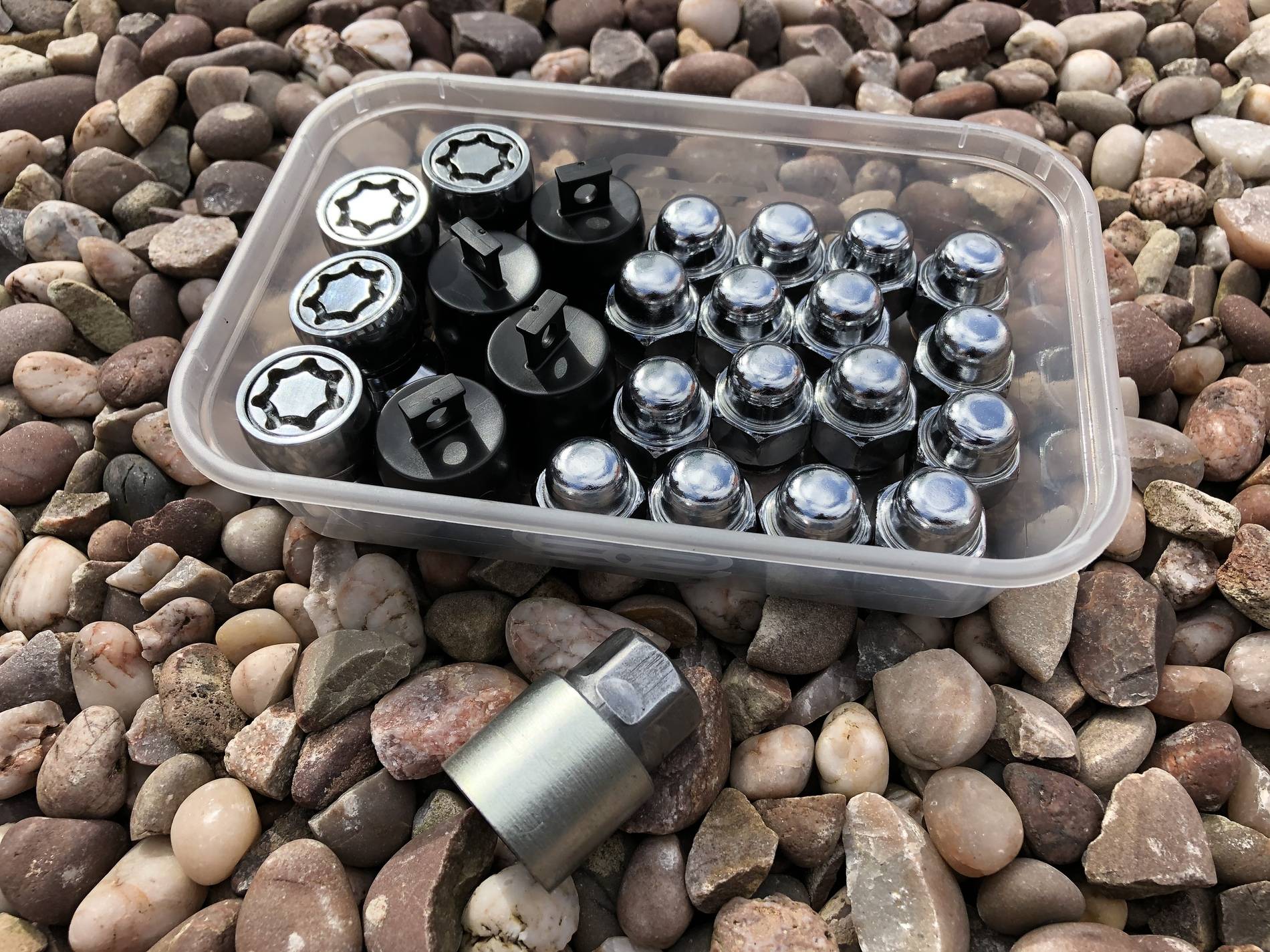

Yeah I have no issue with McGards either :like:
Here’s the set that have lived on my daily driver Sportage for nine years (I think are the ‘ultra’s’ as they have the hardened rotating collar) :
Admittedly the Kia doesn’t get 150 lb/ft and I keep them under rubber caps but still, I don’t think that’s bad for nine U.K. winters / servicing / rotation etc :like:
The euro Mustang lockers are also McGards, just a different design to what you guys get :like:

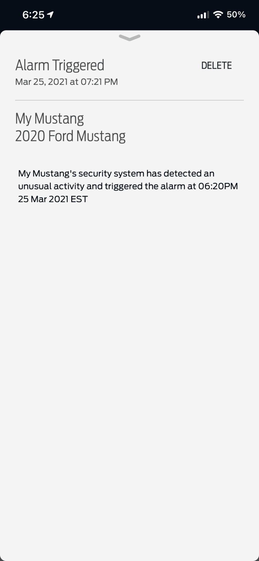

Enhanced security work! I was removing the side led lights I had installed on the 2020 GT I had and shit I got scared alarm when off out of know where here is the alarm

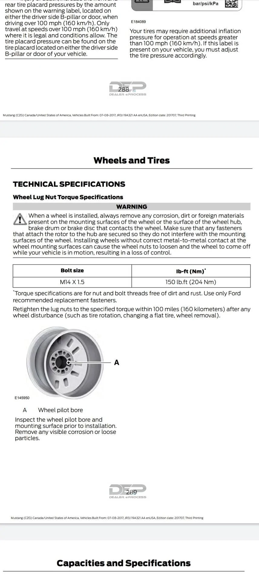

Is this the Mustang you're talking about here? If so why are you only torqueing to half the Ford spec of 150ft lbs?
No, The vehicle, I have it is 75 ft lp. I have not bought a mustang yet.( looking for one the way I want it, and why I am here asking questions before I pull trigger) But Again, my 357 v8 main studs and head studs , nuts don't back off, so. the member that was worried about the lube causing the locking lug to back off.
Can you link the wheel lug nut stud spec at 150 ft lp. that seems mighty high for a wheel stud, The vehicle I used as an example has 14mm lug studs, 150 ft lp will snap them all off.

The photo of the key looks like McGard locks. I've never had problems with McGard locks on my other cars, though I admit my other cars are torqued only to 80 ft/lb, not 150 as required on the Mustang.

Welp, it is 150 foot pounds. color me surprised .
That is a lot to ask from a 14mmx1.5 stud.
I wonder how many cycles before they snap. or are at risk of it.

I believe the F-150 is the same stud size and also is listed at 150 ft/lbs. I guess if it's strong enough for the 1/2 ton pickup it should be ok on a Mustang.
