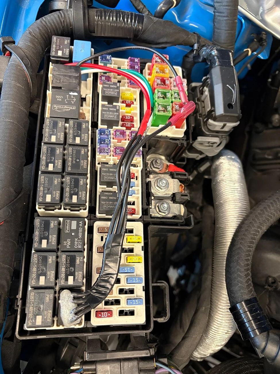

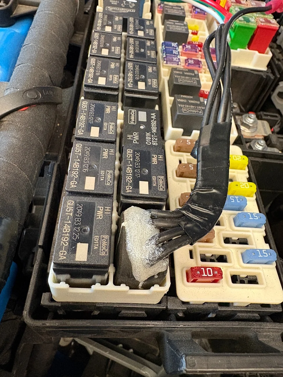

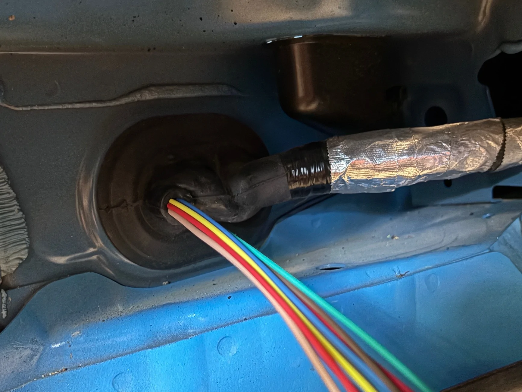

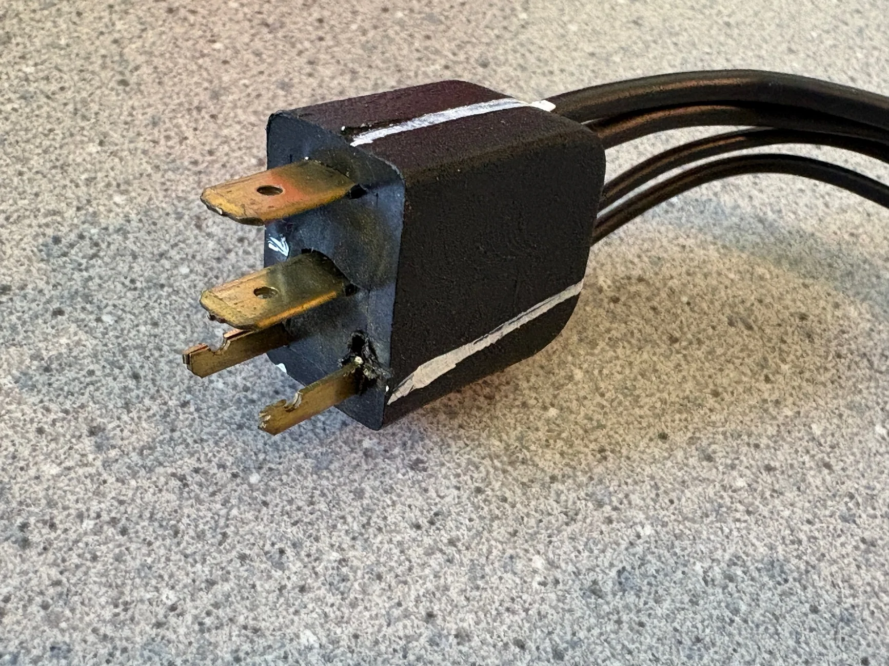

Starter relay bypass works like a charm and it's a lot less worrisom than messing with the fuel pump circuit. If you prefer the cheap analog approach with hard-wired switches, you could run an extension adapter from the relay socket in the fuse block to a remote relay with a kill switch inturrupting the switch wires to the remote relay. I tried disecting a Ford relay and soldering leads to make the extension adapter but packaging is tight under the relay box lid and it takes some practrice to make it short enough. Or, even better, Mobilistics used to offer a simple adapter from NoStart meant for Chrysler micro relays (same as Ford but but the Chrysler switching blades were "normal width" and need to be trimmed to match the Ford narrrow blade style) and you could fit the complete bypass relay system under the lid. Running the kill switch wiring to the interior is as simple as trimming off the nub on the firewall harness grommett designed for running accessory wires through the firewall.

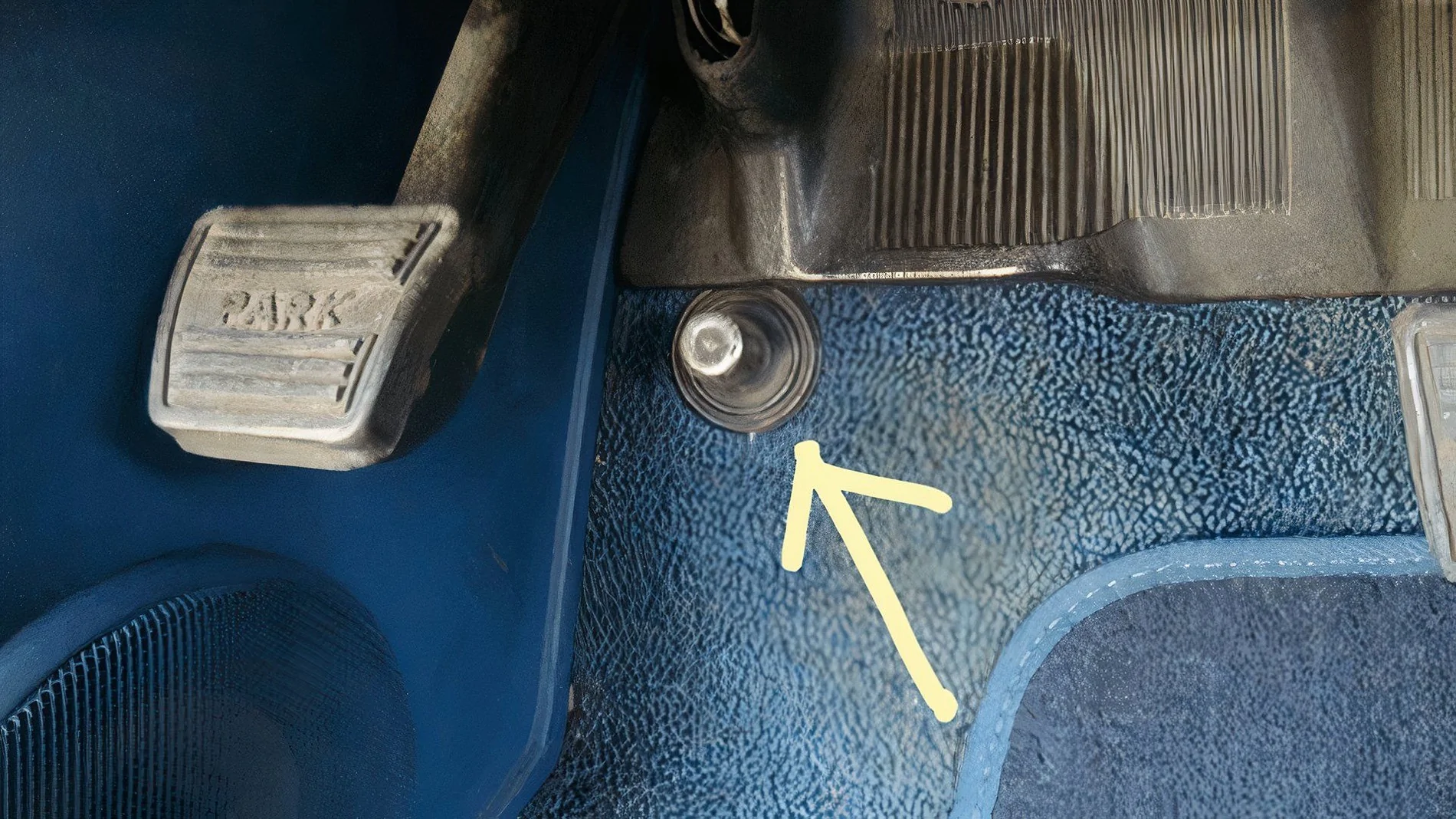

Not that long ago, we used to run the starter relay thru the old high beam switch…but nowadays, it stands out like a sore thumb cause few recognize it anymore 😂

My very first car was a 1966 Mustang Fastback with a 289 and automatic that had that high beam switch on the floor. I think that was in 1973! It brings back memories.
