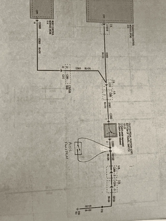

I spliced an additional kill switch in series with the clutch pedal position switch (black/green wire,) as a simple and crude anti theft deterrent on my Mach 1, and it works fine in preventing the starter button from illuminating the green light "ready" status for starting the car until the kill switch is also closed. However, the car still starts, regardless if the starter button is illuminated or not. Any ideas how the the starter could still activate when the clutch pedal is depressed but the second switch is open to interrupt the circuit? (The attached wiring diagram is intended to show the kill switch wired in series. )Thanks.

IDK if I can explain myself correctly because I'm not familiar with the design of that circuit and switch. But it seems like you need to move your kill switch to before the Clutch Pedal Position switch; this is the logic side of the circuit. The kill switch should be between the CPP, the BCM and PCM, so it always appears open, until you close the kill switch and then depress the pedal.
The BK-GN wire seems to do nothing other than physically complete that circuit, so the button illuminates.

Thanks for the suggestion - The wonders of modern electronic controls. I'll switch sides and see if that does the trick. (Accessing that particular wiring harness is a nightmare unless you're a contortionist)

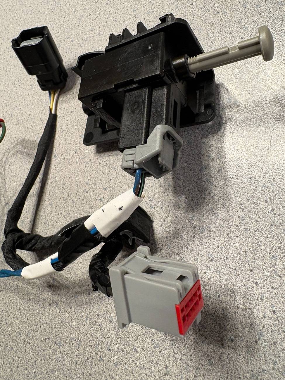

It appears the 2-pin pedal position switch's function has been relegated to only illuminating the green "ready" light on the starter push-button, as mentioned above. (It doesn't matter how that circuit is interrupted and it doesn't have any impact on cruise control function etc..) It's the 6-pin connector on the clutch actuator "rod" that seems to send all the pertinent information to the BCM. I didn't want to potentially confuse the BCM if I chose the incorrect method of interrupting that 6-pin circuit so I gave up on the clutch pedal approach to kill the starter. I suppose I could consider interrupting the fuel pump as it has a dedicated fused circuit but there's some real current flowing through those wires and any switch better have enough capacity and bulletproof reliability before I'd tamper with that circuit.
