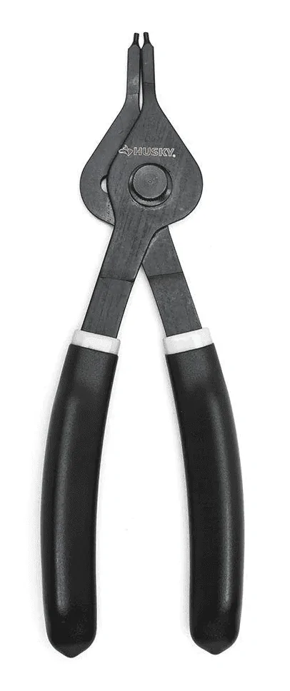

Not going to lie, I did a bit of research on OBD2 port locks when I bought my Bronco (first keyless push button start vehicle I owned other than my Ducati Multistrada lol)..
From what I can tell, they're no more effective than "security" screws manufacturers use to try and stop people from repairing their electronics; they only work if someone doesn't know how to remove them. In most cases, they're simply a socket with some pins in the lip it to engage the holes in the flush covers for the bolts.
For now they're obscure/rare enough they would likely thwart a clueless thief, but from what I can tell, all you would need to use to remove the covers is:
