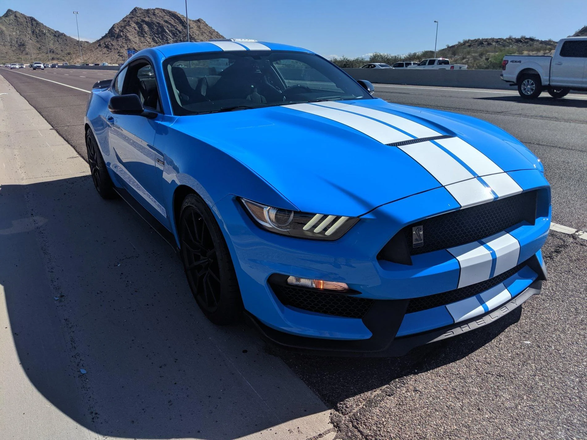

Sequence of events:
Oil consumption started increasing from 1000 to 500 to 250ish miles these past two weeks.
My oil pressure was rapidly fluctuating between 70 and 80 PSI on a road trip Monday.
Car felt down on power this morning
Got on the freeway and started hearing a knock at 3k RPMs
Oil pressure dropped to 25 PSI
Total loss of power then oil pressure dropped to 0.
Car struggles to restart then dies immediately after.

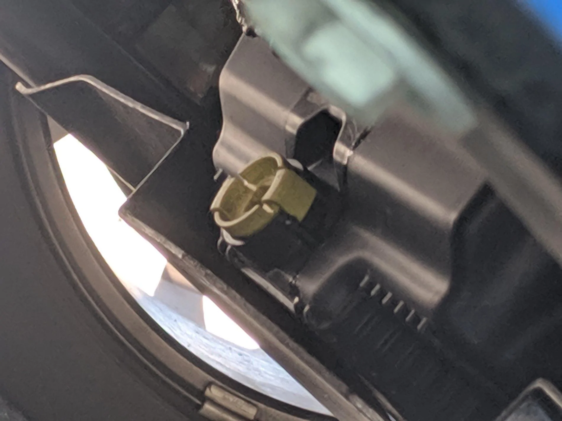

I can see oil dripping from the rear of the engine.
Ford Roadside is taking her to my preferred Sanderson Ford. They have the only Ford Performance Tech in Arizona.
I will update this thread though out the process.

hate to hear this. hopefully a quick resolution... hopefully they'll tell you wha the issue was. I wonder if you started losing oil from whatever caused that leak, it got low and now that's why its knocking or the knock/blow up is what caused the leak.

Pretty unlikely - if it was leaking a quart every 250 miles, the undertray and the transmission would be covered in oil. It's not - it's clean except for a thin dribble.
