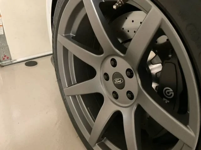

Short of going full-fancy-pants, Gorilla is the standard, go-to, no frills, stock replacement. Don't waste time looking anywhere else nor overthinking it. PIc for attention, LOL

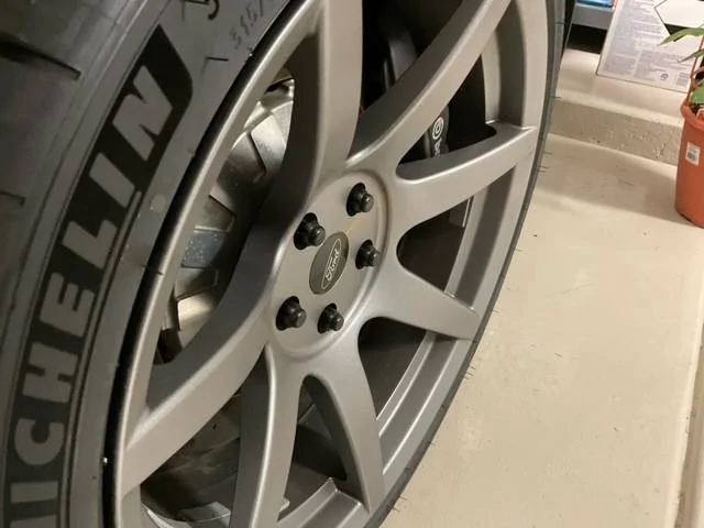

I recommend Gorilla lug nuts, which is what I switched to. They don't have the metal/aluminum covering on them which can frustrate removal of the nuts over time if they become worn or damaged by frequent removal/reinstallation or by use of an ill-fitting wrench/socket, and are available in black if you want them to match the color of black wheels. They are available with all non-locking lug nuts, a single locking lug nut (pictured at the 3 o'clock position in the picture) or with all 5 locking lug nuts, if desired.

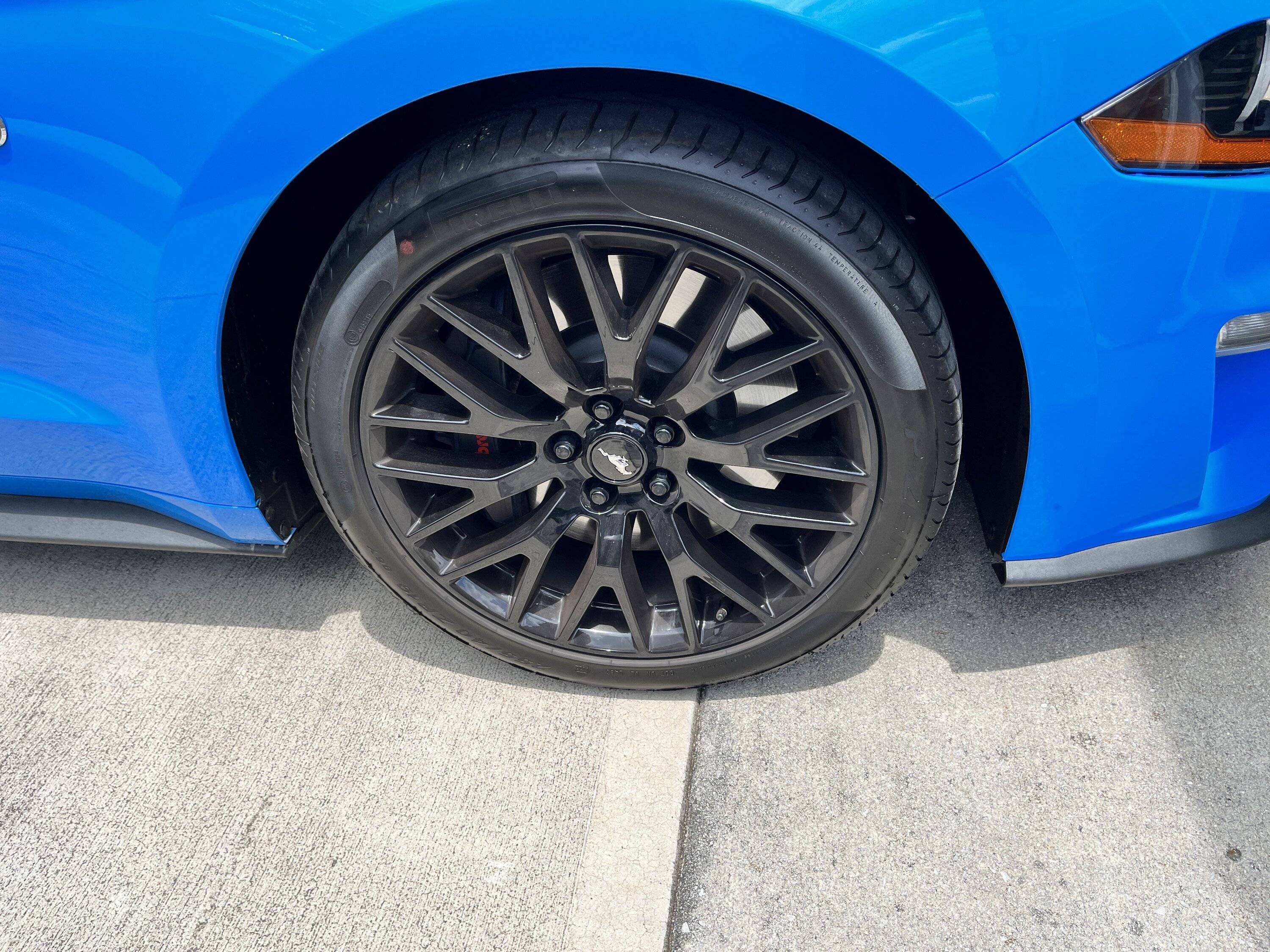

Not exactly what was requested, but here is a GT350 w/6GR R replicas with DP black long (2.02” length) and short (1.35” length) spline lug nuts. The longer fronts don’t stick out as much as the backs but using the shorter ones in the front Are completely recessed.

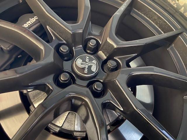

I went with black gorilla nuts.

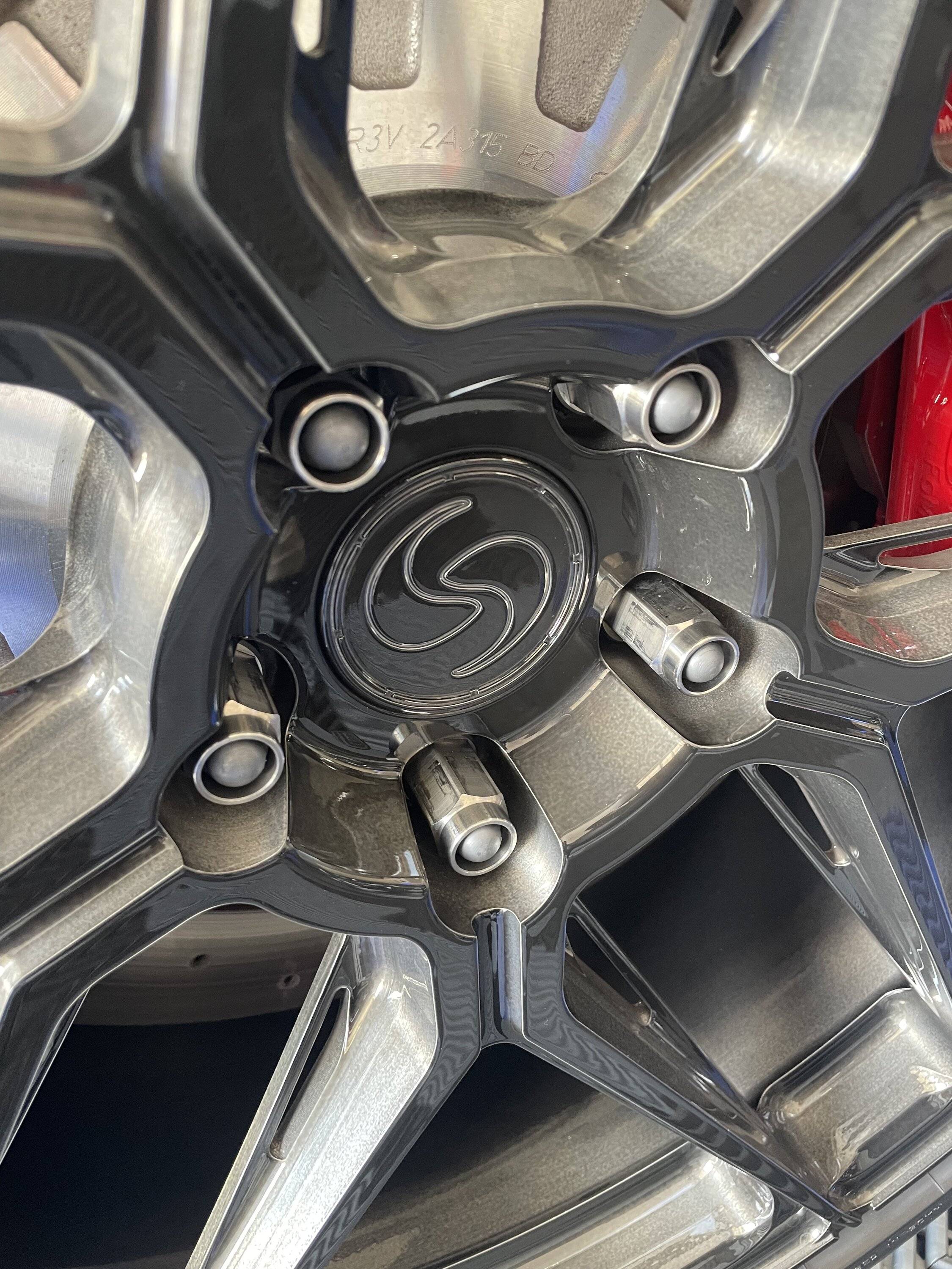

Got my chrome gorilla nuts a little while ago. Going to install them tomorrow
