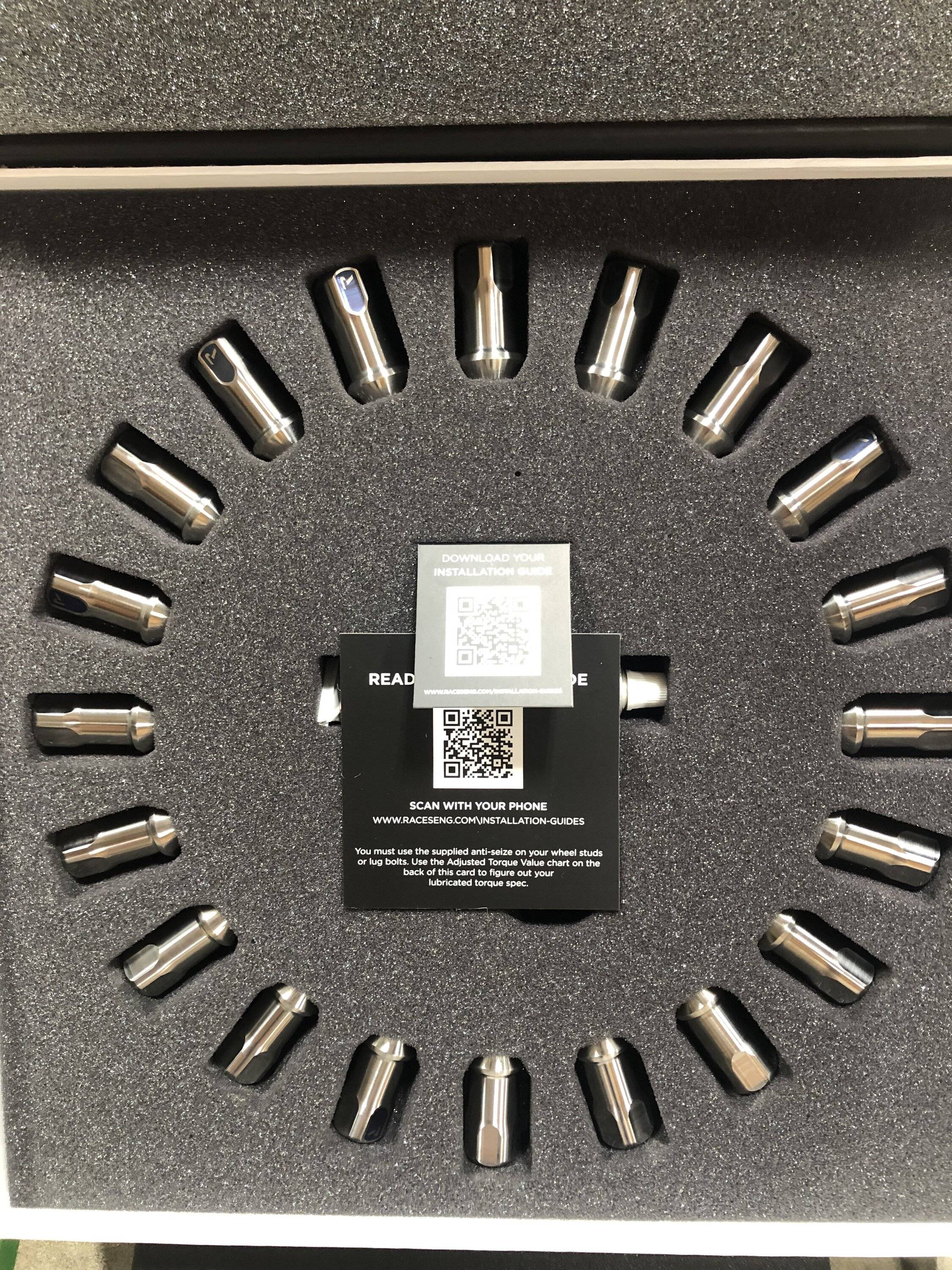

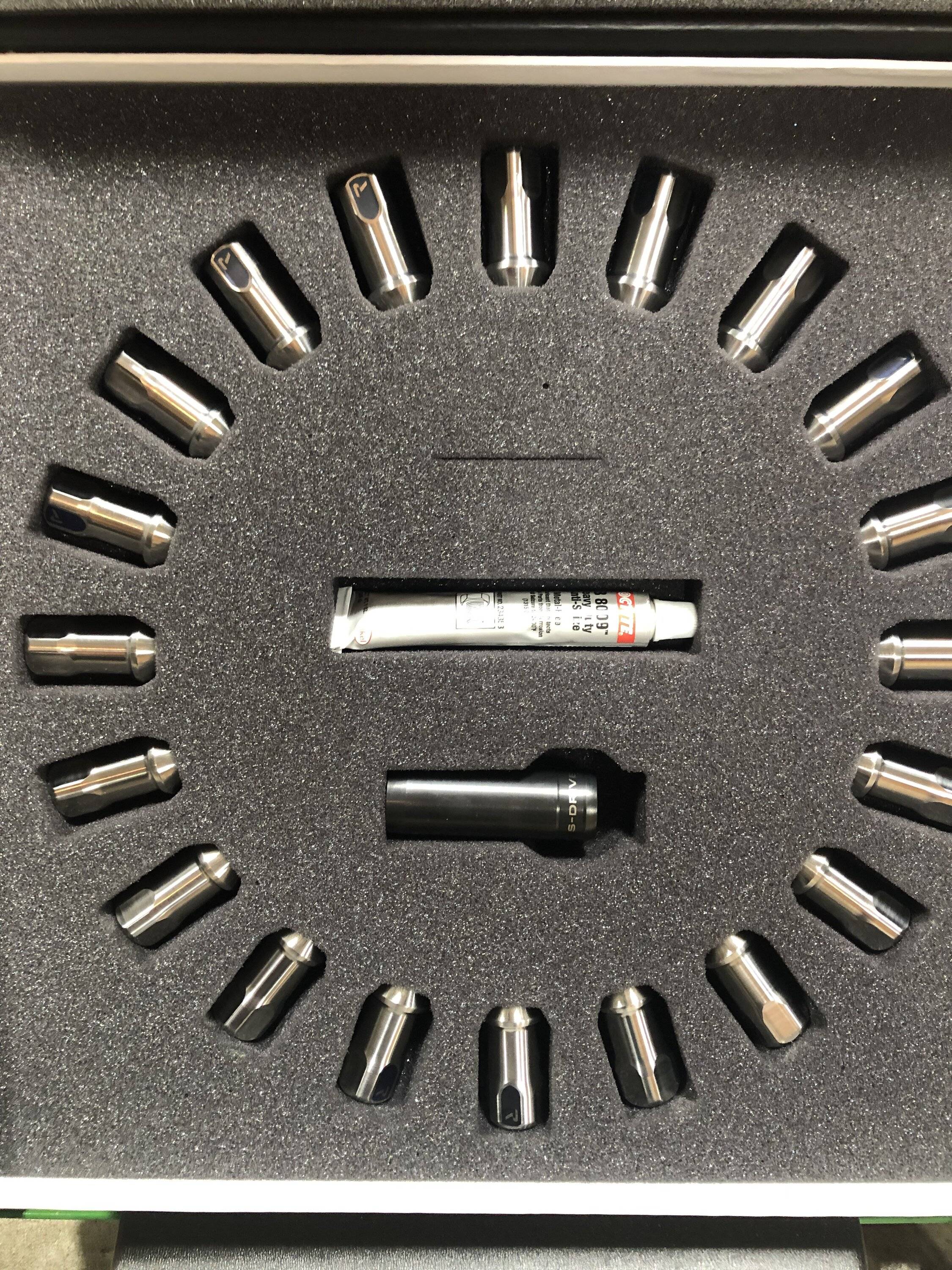

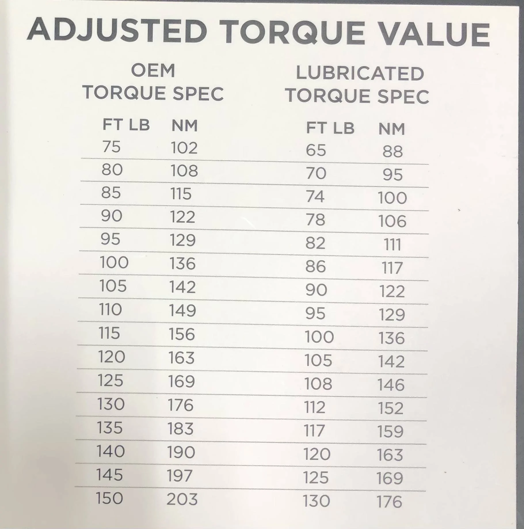

My Beautiful Bride got me these for Christmas, here are the details for the Raceseng titanium lug nuts…

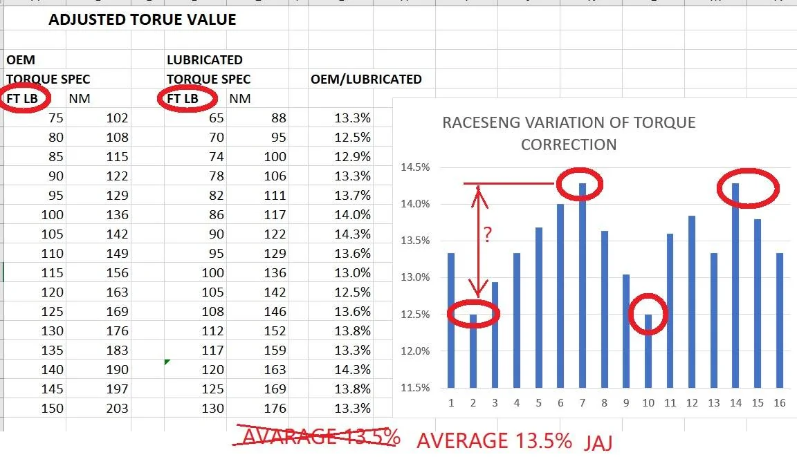

Just want to play more on the engineering note:
As they say: “The Devil is in the Details.”
  • Based on the chart spread the lubricated torque data does not look like derived from an engineering simulation/calculation. What make data points 2 and 10 so much different from points 7 and 14?
  • Where does RACESENG want the lubricant to be applied. Average recommended 13.5% torque reduction suggests that only thread has to be lubricated. But RACESENG Instagram video shows inside seat lubrication while assembling floating seats. Lubricating the back of the rotating seat reduces friction (required install torque) more than lubrication of the 60 deg seat face.
  • It should be another torque table for rotating seats. Rotating seats reduce required install torque due to lower force between the rotating surfaces.
  • The units [FT LB] are used for energy (at least in engineering environment), while pronunciation is foot-pound. You would not know this unless you read engineering publications. If you have been around engineers and overheard “foot-pound” you would probably think that [FT LB] abbreviation is used on engineering reports: [lbf-ft] [N-m]
As an engineer, I would feel more respectful to RACESENG lubricated torque recommendation if it was just something like “reduce spec torque for a little.” At least it would not make me inspired to examine the recommendation table. Now, visualize how many errors and discrepancies an engineer can find in a deep scientific report with derivations that would blow your socks off. This is the reason why a responsible supplier would not publish anything that pretends to be engineering. Assuming RACESENG lubricated torque table made you feel more like purchasing from RACESENG. Would you feel more or less like purchasing from RACESENG after reading this comment? This will answer why the suppliers do not publish more than it takes to sale.
BTW, why would not offer them pre-relubricated? Some of my customers do not even lubricate Titanium conversion kits: Titanium nut over Titanium stud.
There is no mystery here., but there is complexity. I built an algorithm in Excel to figure out how they got the values they got. They seem to have decided to reduce the torque by 13.5%, and then wherever possible, they used standard 5 lb-ft intervals. If the calculated torque value wasn't within 1.5% of a "standard 5 interval" they just rounded it off and put it on the list.
Here's how the calculation looks:
1. Multiply all the OEM numbers by 86.5% (target torque reduction of 13.5%)
2. Create a "standard sequence" of 5 lb-ft intervals starting at 65. Goes like this: 65 - 70 - 75 - etc. up to 130.
3. If the difference between each calculated torque value and the nearest number in the 5 lb-ft standard sequence steps is less than 1.5%, then use the nearest value in the standard sequence in the final table.
4. If the calculated value is not within 1.5% of a standard increment, then round off the calculated torque value to the nearest integer value and use it in the final table.
You get exactly the list of reduced torque values in the table published by RACESENG. Seems like pretty good engineering to me.
By the way, is "AVARAGE" an engineering term? I've never seen it used before.
Thank you for “AVARAGE.”
The first two RACESENG columns are easy to get into Excel because there is simple logic in the sequence. The two other columns have no simple logic in the sequence. Perhaps, (Next number)=(Previous number)+(130-65)/15 formula was too complex for RACESENG so they produced the numbers the way you exclaimed and it made it look the way I see it.
