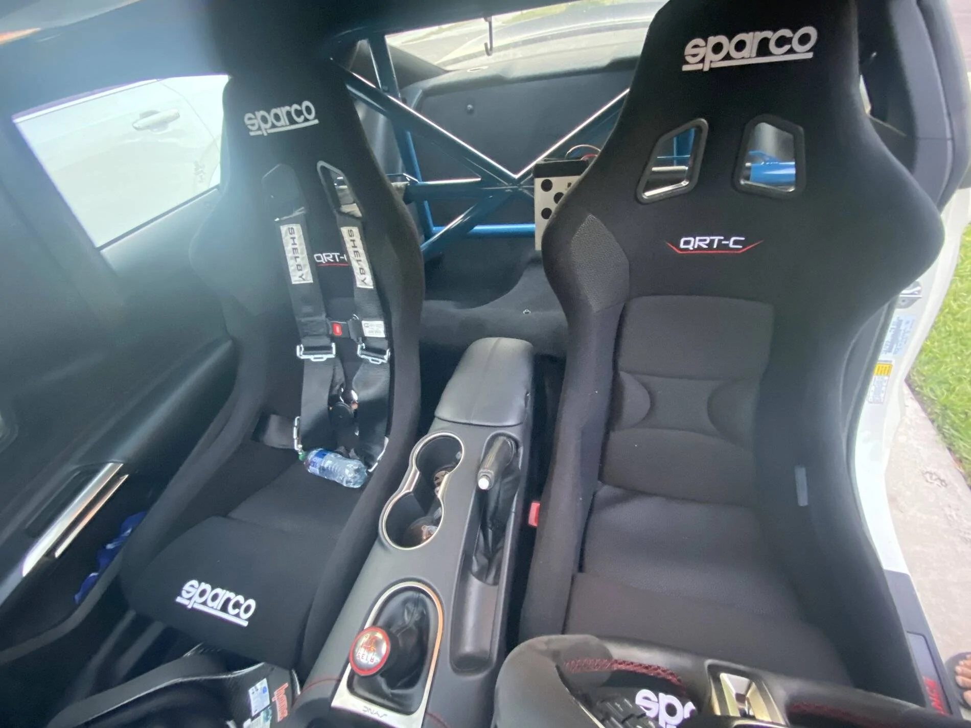

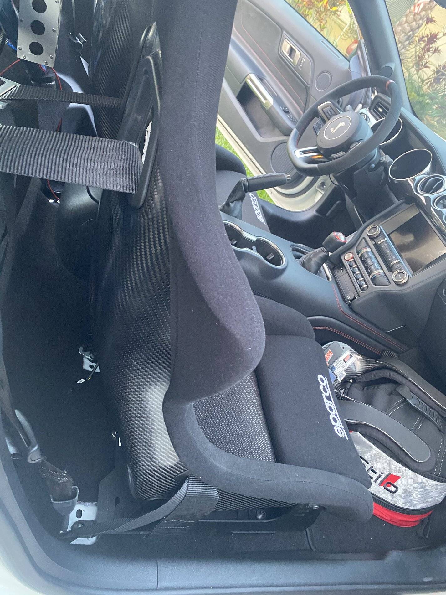

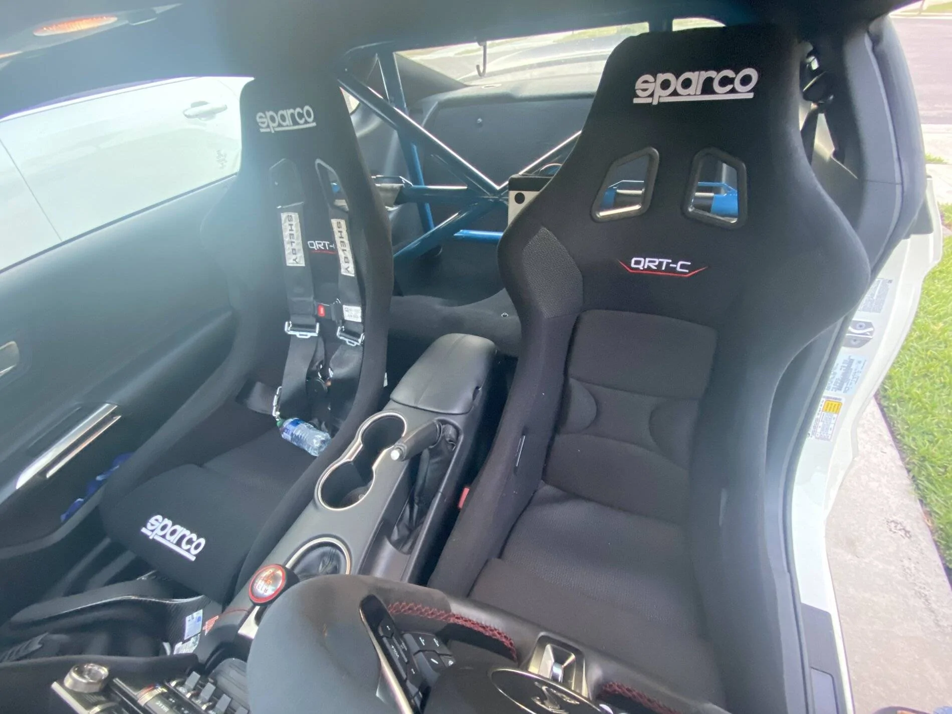

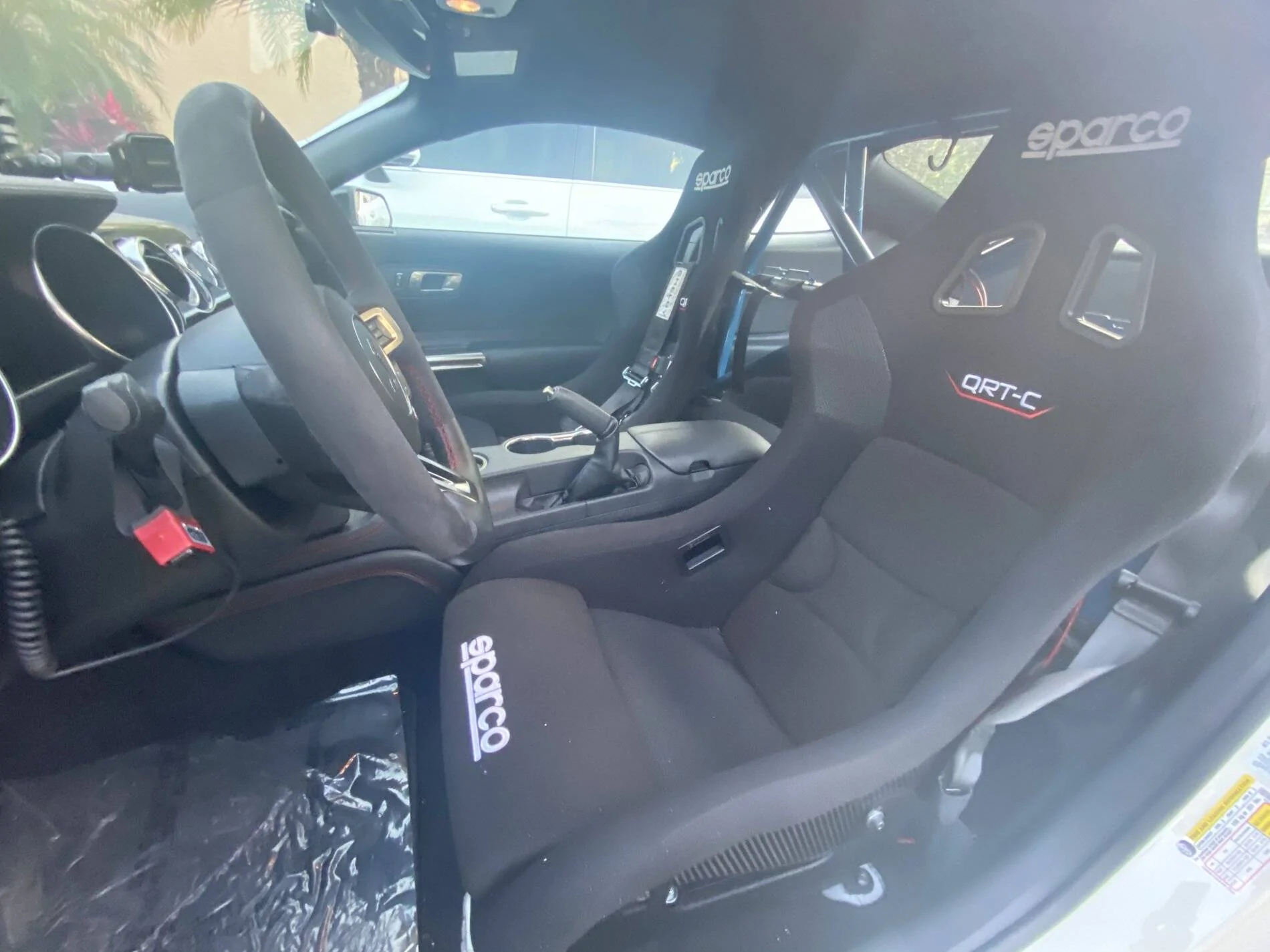

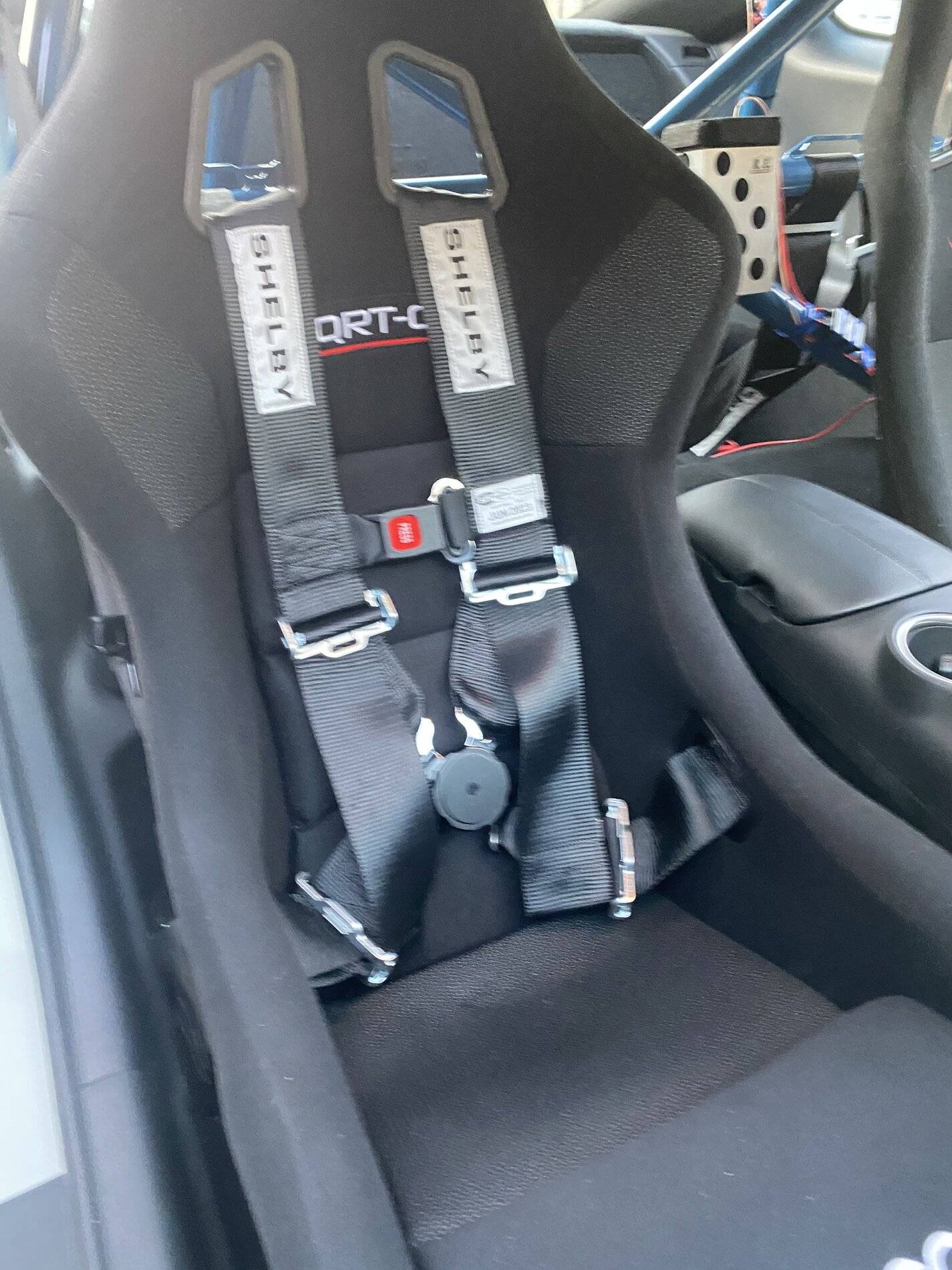

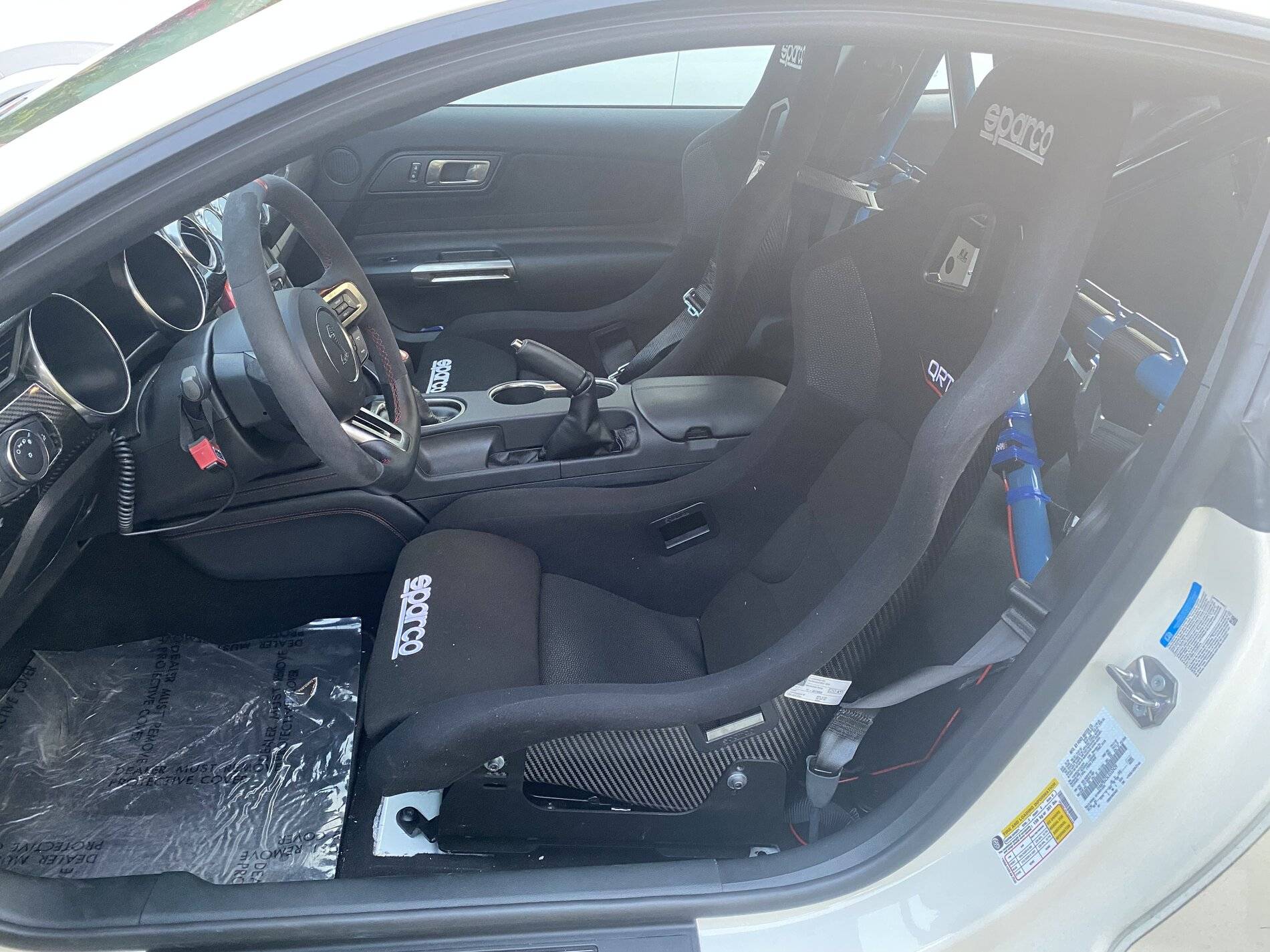

Went with the sparco qrt-c
It works well for a street/track combo
Very pleased with it, helps out allot on the track to keep the stress off my shoulders and back while driving.
Doesn’t do anything for the neck or head though. You would need a halo seat for that.
But for a hybrid seat I would recommend these quite well.
I have a slider for the driver seat and no slider for passenger.
