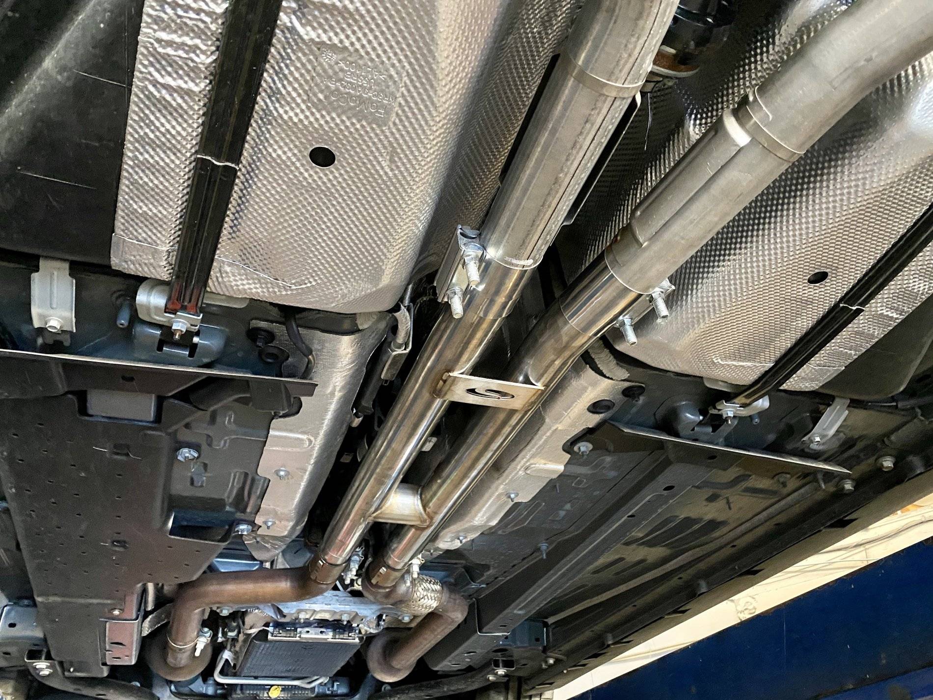

Just two cuts behind the resonator in line with the new h pipe, and reclamp the front and the two that come with the h pipe. The nice thing about the Steeda, is that you don’t have to worry about the factory heat shields when you install it.
just want to say, I was in the same boat as you. Worried about the overall loudness of it. But quiet is still very quiet. I call it “Mercedes mode”
But the other modes are pure heaven. The cars should have come this way stock! You absolutely won’t regret it.
here is a picture of mine installed if it helps.

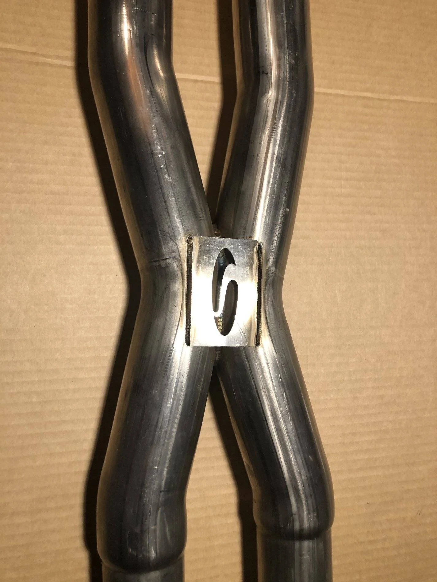

I had a $90 xpipe on my car (sr performance?). It was cut and clamp and sounded great. Quiet mode was still very quiet and in Normal mode I didn't find myself looking to change to track mode all of time. I didn't have any rasp until I removed the cats.

I went with an x pipe from steeda. Install was easy and the sound is amazing
