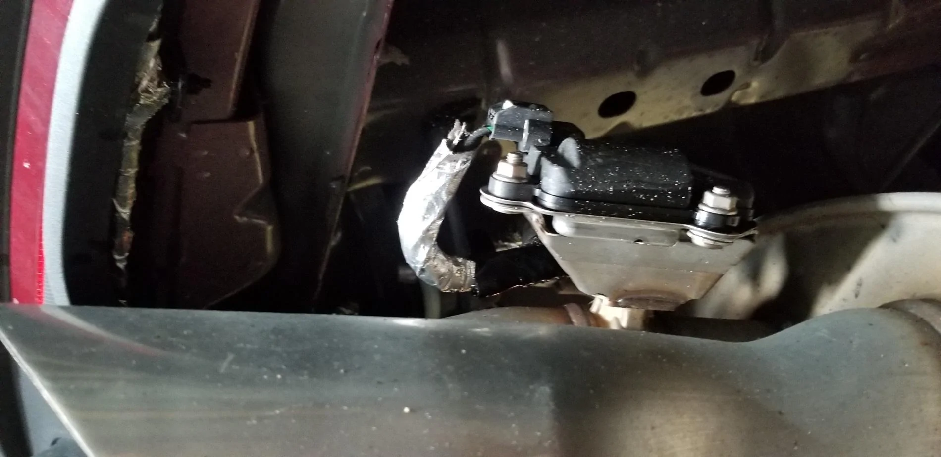

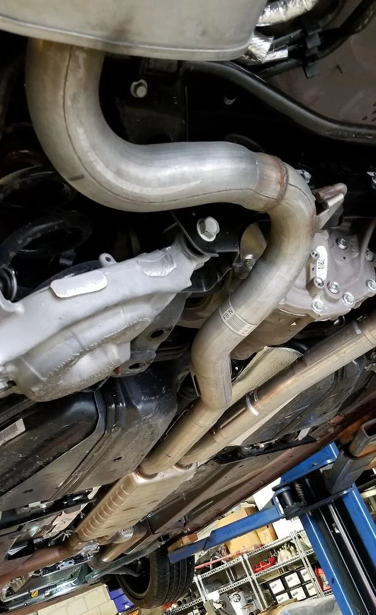

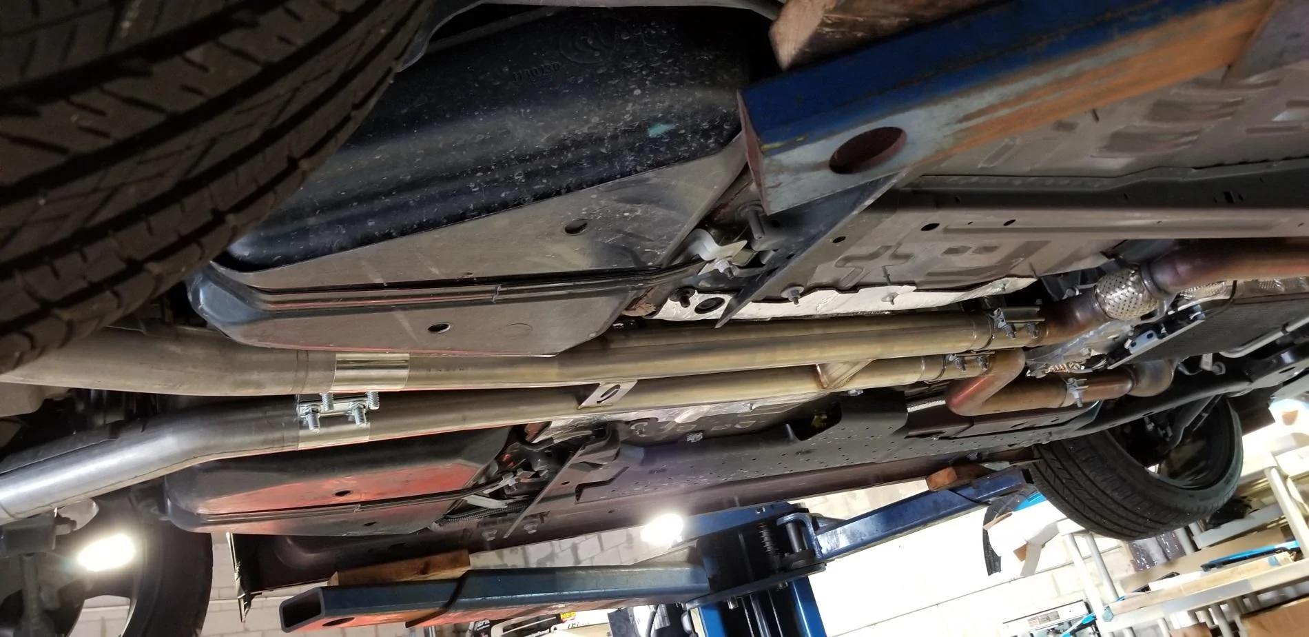

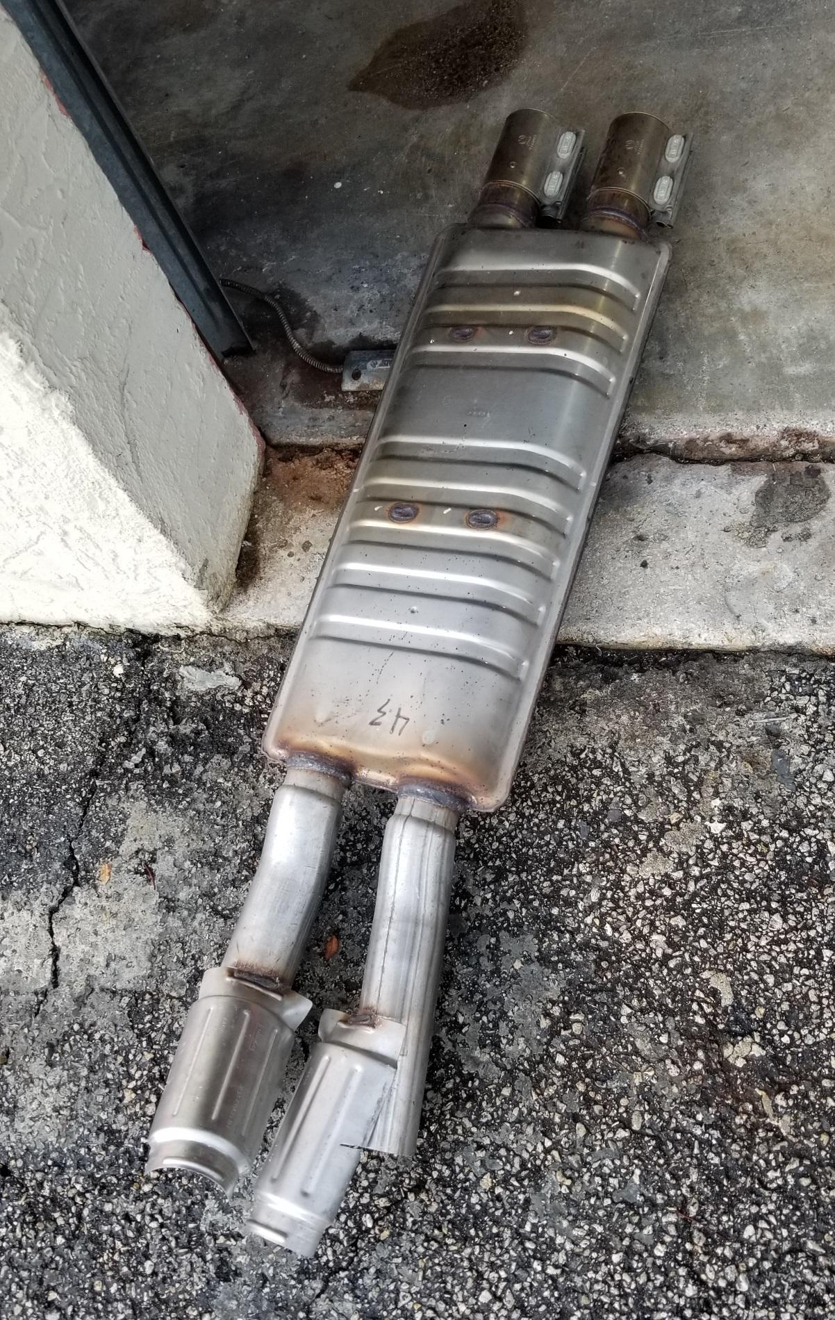

Here are some photos.
The last one is a shot of the actuator for the exhaust valve with the muffler dropped.
