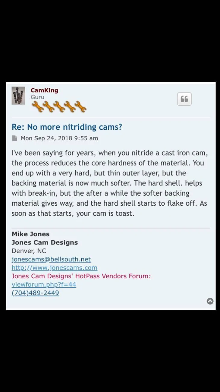

nitride coating (?) is gone

Not sure, it just looks like it's flaking off and not just worn

If the two materials are close in Rockwell hardness there’s a good chance what we’re looking at happened during break-in and hasn’t changed since then.
