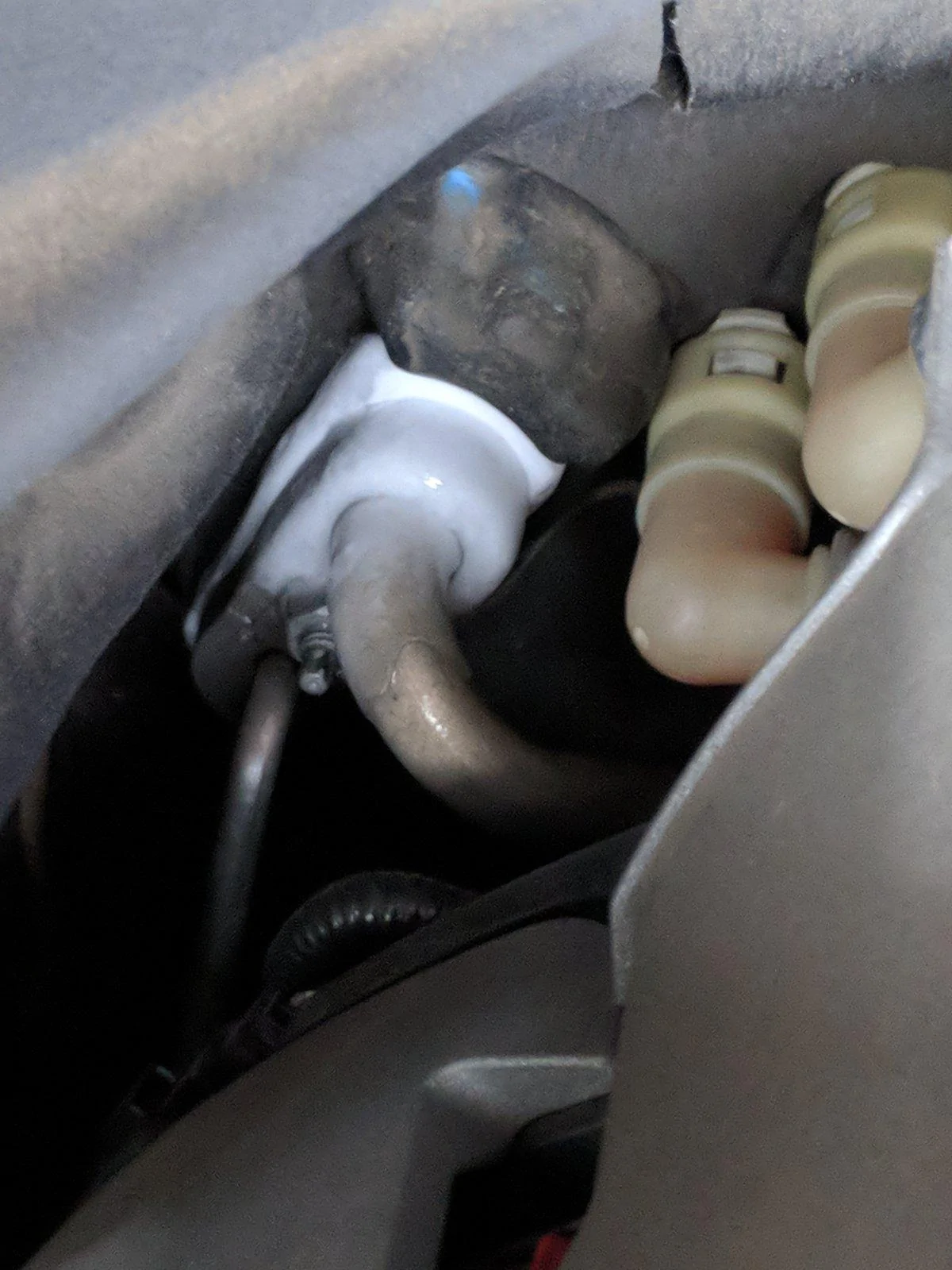

I am trying to figure out if this is my issue. My AC is warm, but it had about 15psi in the system when i shot it with a recharge can. that was a day ago, and the AC is still cold now. there has to be a leak, but its a small one. not sure if the evap core usually vents refrigerant quickly, or a slow trickle.
