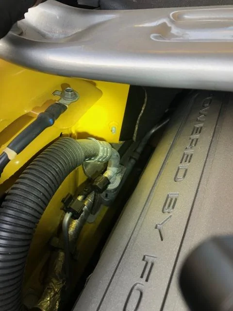

I am down in Florida on vacation and started having some trouble with defrost setting working correctly. I also have a whining sound almost like a faint turbo whine that started at the same time. A/C is working intermittently and the whining sound seems to only happen when the A/C compressor is engaged. I am thinking that this looks like the schrader valve could be leaking on my 17GT and I now have low refrigerant. Can someone please confirm that this is what leaking refrigerant would look like? Google images is not much help on this and I m hoping someone else has seen this. In addition is this the high pressure side (Service port)?
More likely the evaporator is leaking. Only way to know is to have the whole A/C leak tested.
