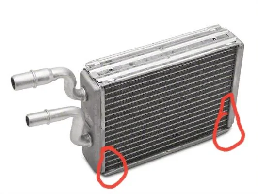

Here is a pic.
A leak there is probably the welds between the end tanks and the capillary tubes failing from repeated warm to cold thermal cycles.
If the bottom tube on the left tank is the cold inlet to the evaporator, then the bottom half of the evaporator probably gets the most stress from more extreme thermal cycle swings.
