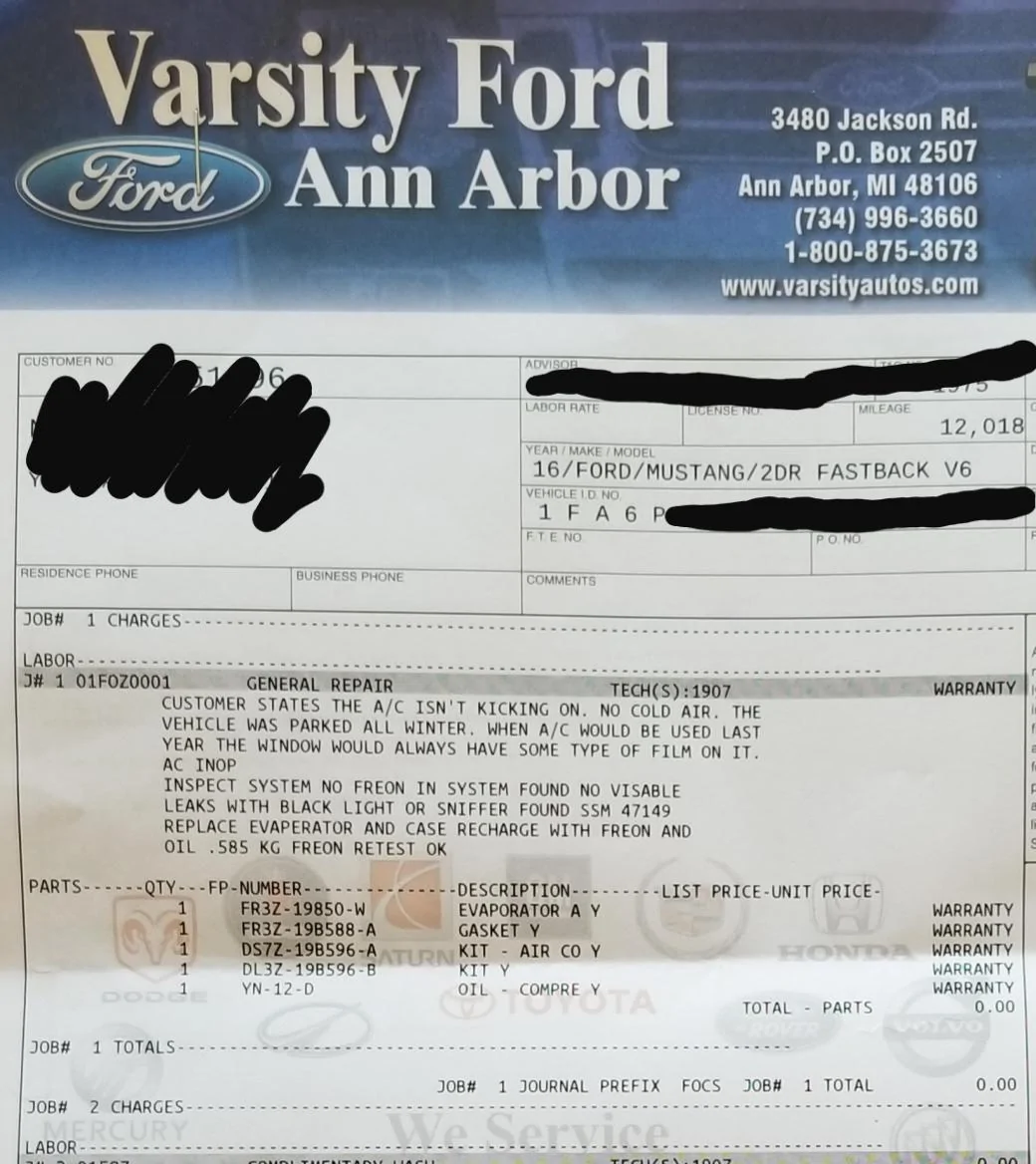

Add another one to the pile...2016 v6 with 12,000 miles. A/C worked when the car was parked in November 2017, broken in April 2018. Dealer replaced the evap core.

So it looks like 02 Sep 2016 build dates and prior are the ones more likely to hae evap issues. Any 2017's with a build date after 02 Sep 2016 have an evaporator fail?
tranceporter
Nov 17, 2017
213
67
Fort Lauderdale
2019 C7 Grand Sport
Yep. 3/17 build date and mine failed at 12k miles.
Several other people with 2017 models have had the evap replaced as well. There was no meaningful fix, it affects all models from 2015-2017.

mine ended in y, but i think was was a difference between models, i forget
